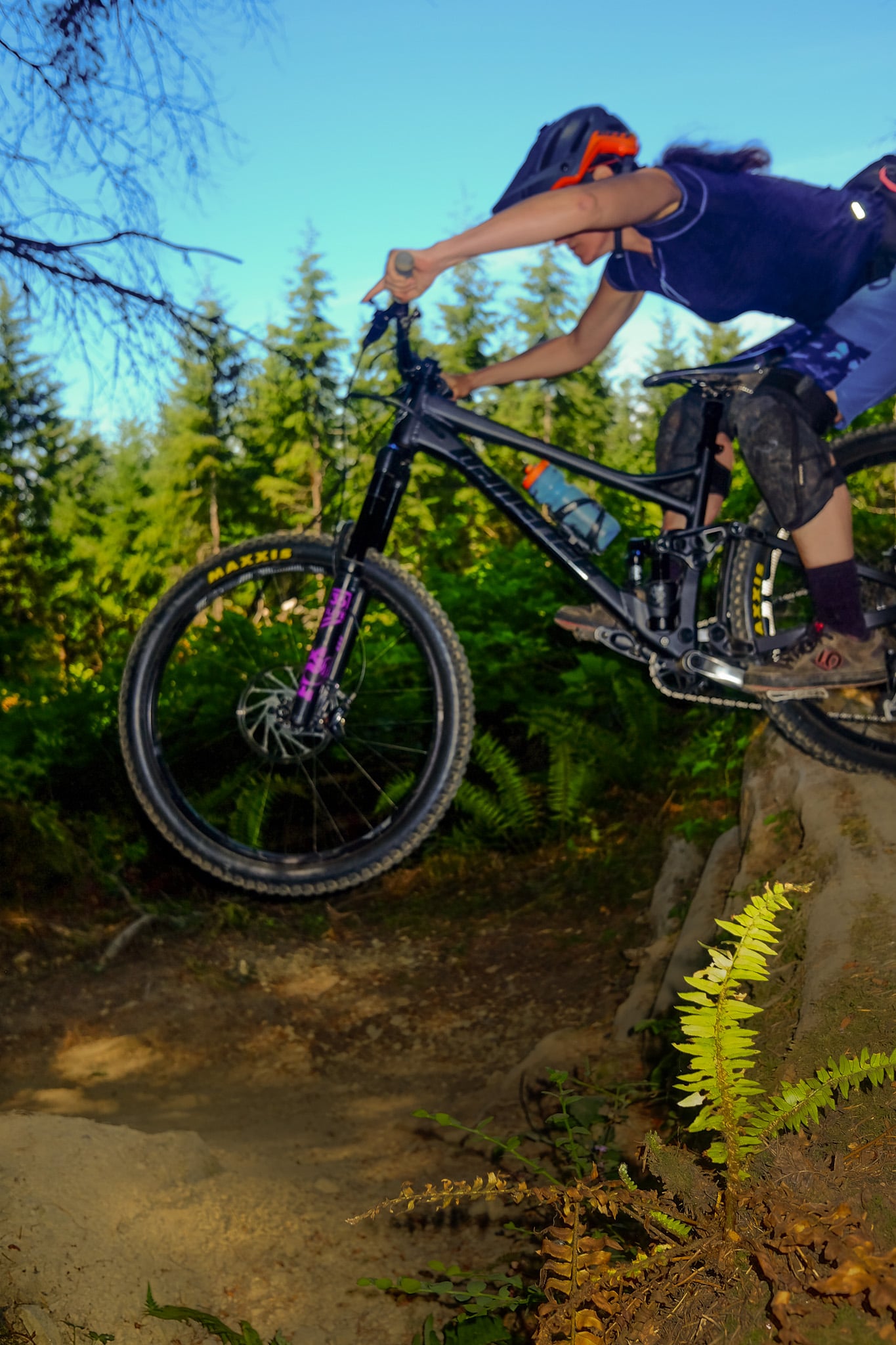

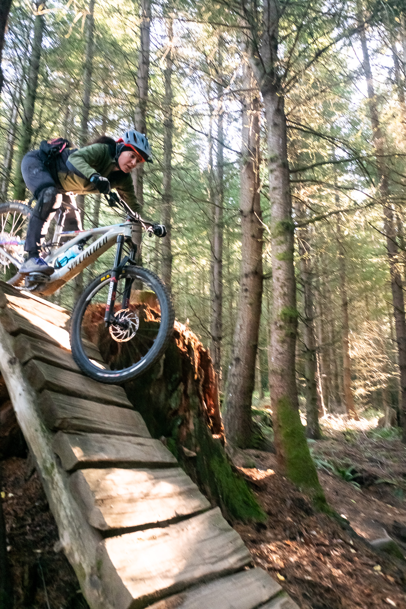

Is the Laydee in question approaching corners at 10mph+? I doubt it.
A lighter bike (with shorter wheelbase) will be easier and less intimidating for a 65kg female to manoeuvre.
Sexism is alive and well, I see!
