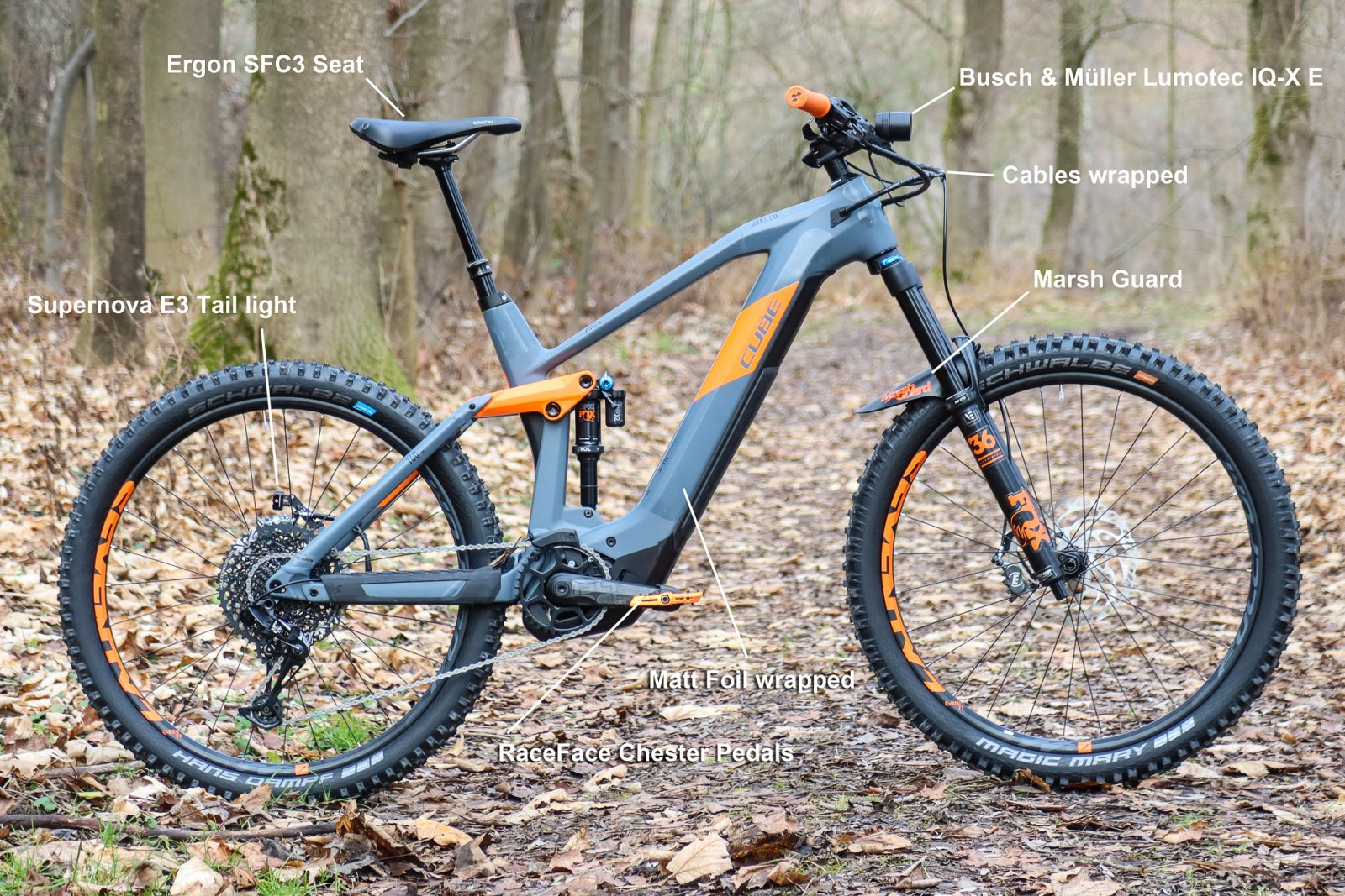

My lights are about 4 years old now. I have the B&M LUMOTEC IQ-X E on the front and the Supernova E3 on the back.
I made a small L bracket out of some aluminium and mounted it on my rear brake caliper.
