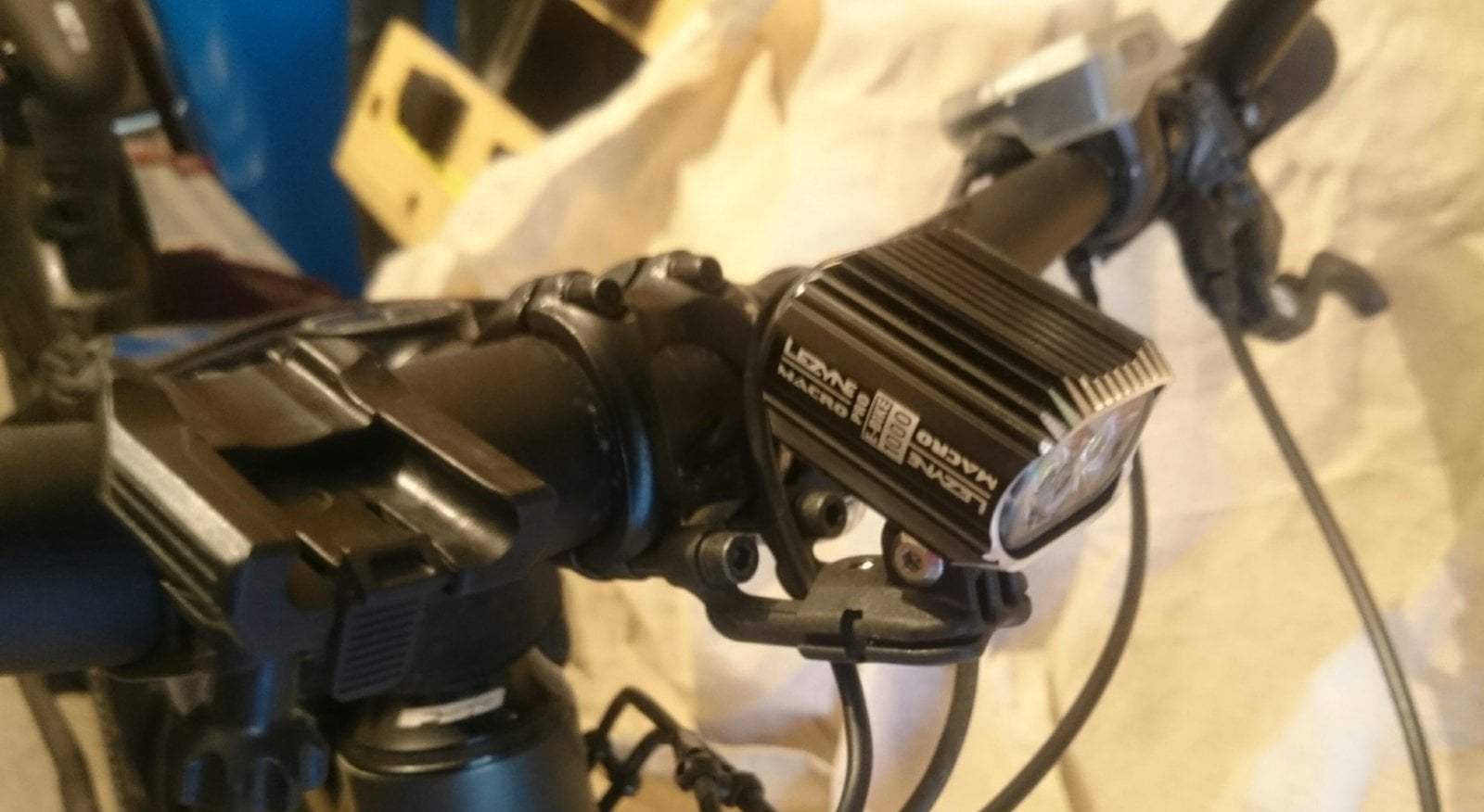

Just installed this compact front light on my Nutrail, cost was only £59.99 from Merlin Cycles who also activated the light option for me, the required loom was about £11 from eBay plus a couple of heat shrink connectors.
Really happy with the set-up. View attachment 10822
Does the motor needs an update if I install one? Or is it just something that need to get activated?

Do I need to buy an additional bosch light cable? In the description there is no saying If you need a cable or not
Oded
Jul 27, 2020
37
137
Israel
Depends on the bike. Some (KTM) come with a pre-routed cable. Some need the Bosch plug that fits the motor light port. The light itself comes with a double core cable without any plug at the end.
Sander23
Aug 28, 2020
740
458
Belgium
Fitted one lezyne macro 1000 light yesterday. Man it was a pain to get this fitted. Had no space to route this cable where it needed to go. Had to drop the motor where there was also no place due the second battery cable and speedchip I had installed and barely could get the motor back in. Then evetually I had everything back in place and wanted to put my inframe battery back in and couldn't cuz of the light cable that I had to wire there....
Will get the light function activated today..
