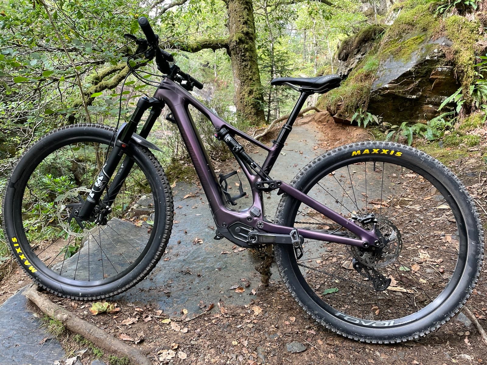

Hi, i run Galfer 203mm rotors front and rear, all cleared by Spesh HQ as well.Hi Anybody running a 203mm rotor on the rear of the SL
Hi What adapter are you usingWife has 203mm rotors back & front on her Sl comp, 1 extra washer to space off, no issues.
The adapters that came on the Sl comp as standard with the 200mm sram rotors.Hi What adapter are you using
What adaptor do you use on the backHi, i run Galfer 203mm rotors front and rear, all cleared by Spesh HQ as well.

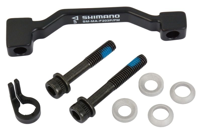

Hi, I use a Shimano SM-MA90F203P/PM. But I was running SRAM Guide Ultimates (for sale on here with these adaptors). What brakes do you have?What adaptor do you use on the back
This is the one i have . Fitting it tomorrowHi, I use a Shimano SM-MA90F203P/PM. But I was running SRAM Guide Ultimates (for sale on here with these adaptors). What brakes do you have?
I have the stock SRAM on the bike
