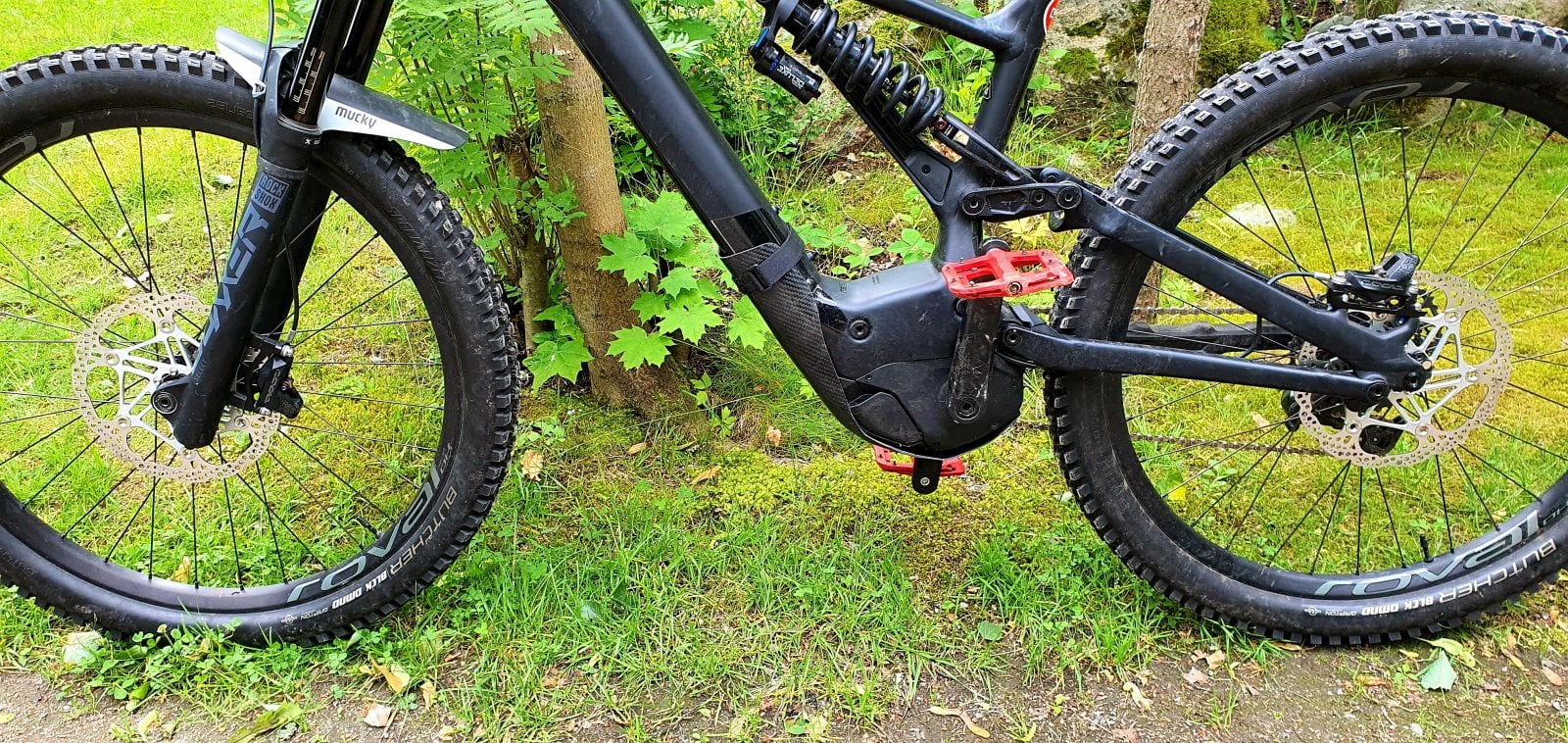

Hi guys, I know I know ... you must brake with the front and use only the rear to move the bike around ... but anyhow , anyone knows if specialized permit to install a 220 rotor on the back of a Kenevo 2020 Expert ? The boxxer is certified for 220 rotor so I was thinking about to put a 220 on the rear as well . Thanks .

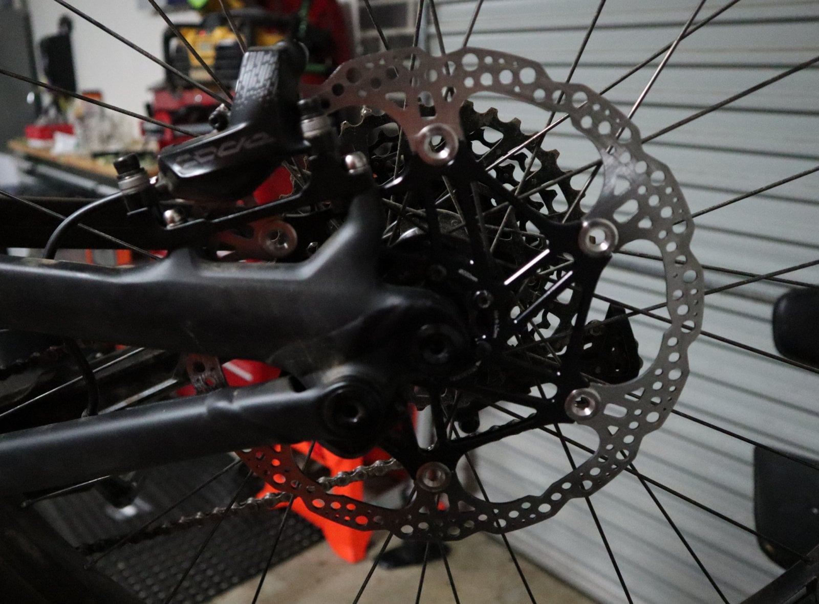

Does the rear just need a 40mm post mount adapter like a Magura QM45 mount to run a 220mm rotor on the back? I can't find the spec for the frame brake mount to know if it's a 180mm post mount stock or not.

Yes it will be. 220 on the rear is overkill though I'd say. I have 220 on the front and 203 on the rear, Shimano Saints. Plenty of stopping for the steepest and fastest trails.

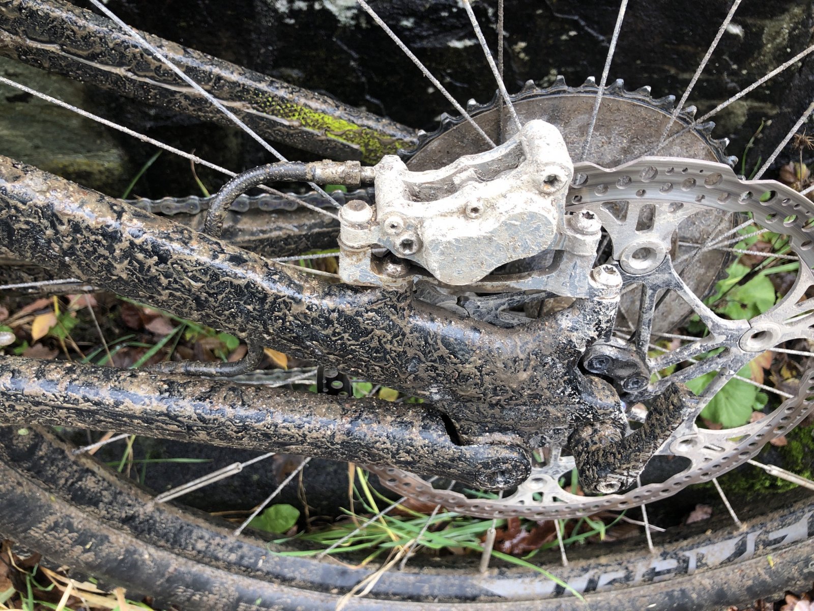

I'm using 220mm SRAM centreline rotors now. A bit less bite than the Galfers, but lovely and consistent so a definite improvement. As R120 says, the power isn't the main selling point (of course I can lock the brakes with 200mm rotors - probably could on a 160mm rotor if I tried hard enough!), but the modulation is. Modulation is much easier when you're pulling the levers with less force.
Since the rotors are 0.2mm thicker than 200mm rotors, this also means less fluid in the caliper pistons = stiffer system which feels better.

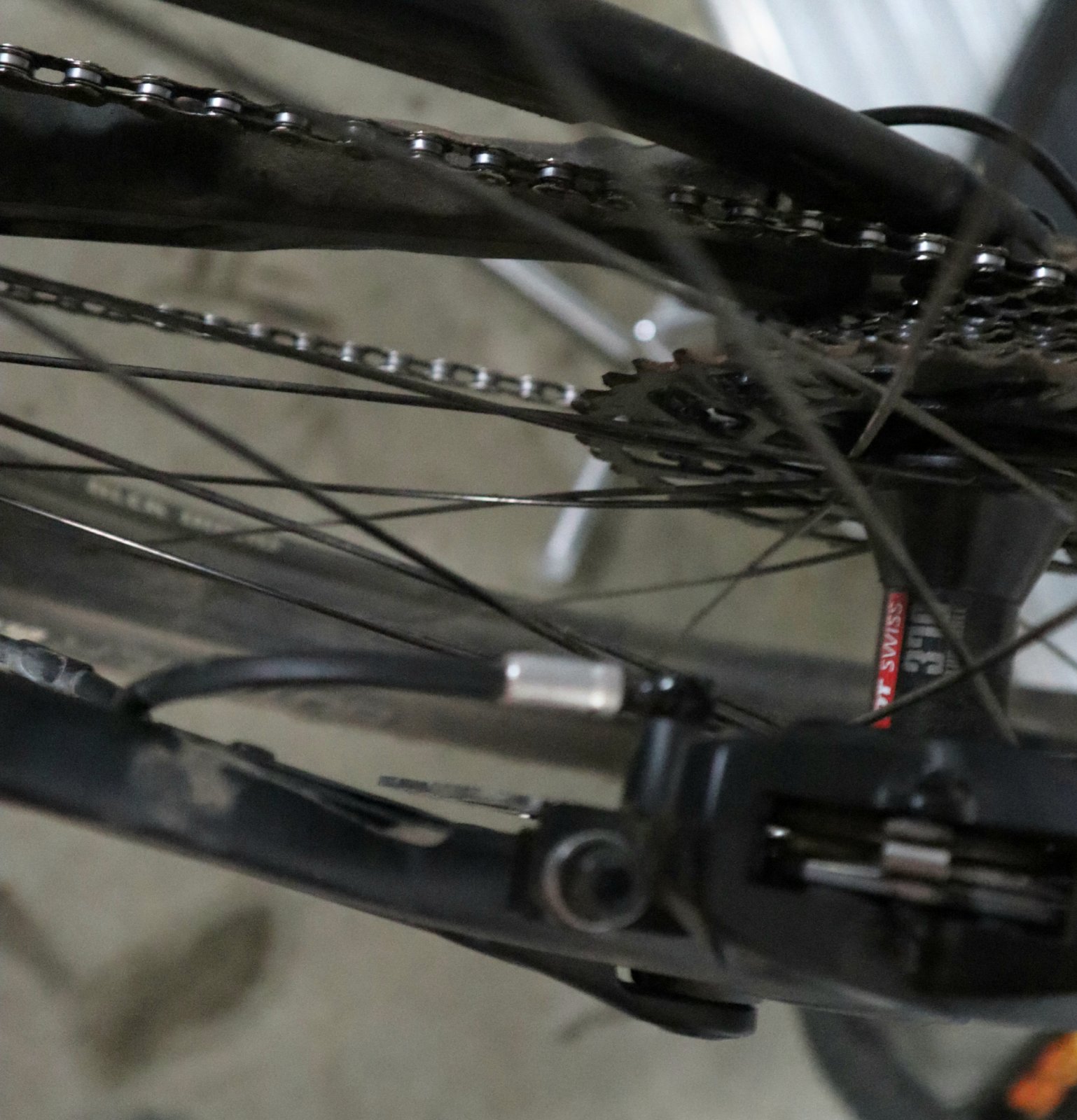

Which adapter are you using? Magura QM45? How was the clearance with rivets? Any grinding needed?
