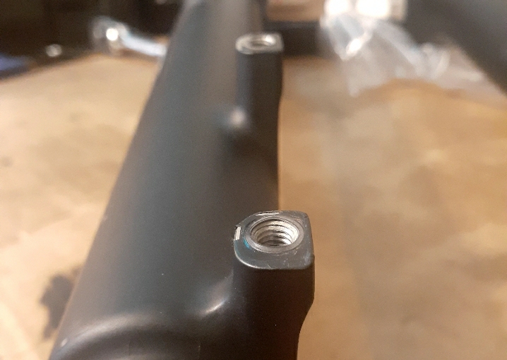

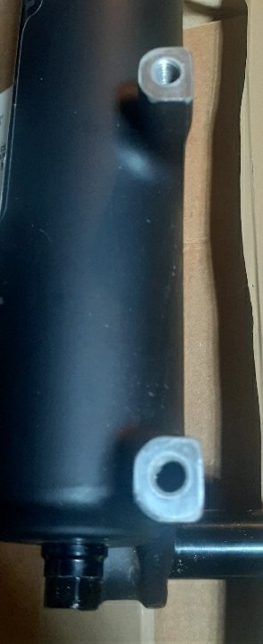

Hi all,
The sound I would hear at random times sounded like a knife being sharpened.
The problem has persisted through two different forks and now a completely new brake set.
Disclaimer : I haven't been chasing this problem with new parts. I just always thought it was the cheap Amazon rotors and figured they were gonna be binned at some point, so I just lived with the random noise.
But after replacing the brake set this week and having the same problem, I started looking into it.
I ended up reading various posts and watching video about facing the post mounts using the $432 Park Tool DT-5.2
After some inspection and some light experimental passes with a flat file, I decided to face the mounts using the flat file.
No more random "knife sharpening" sounds.
Mikerb
May 16, 2019
6,179
4,699
Weymouth
Post mounts? Ie the mounting points integral to the fork, or the post mount adaptor?
jetskier973
Nov 9, 2023
15
8
Gardner, KS.
I went after both.
I filed the integral mounts that are native to the fork and the chainstay. Then I decided to check the post mount adapters and found that they too would benefit from some attention.
jetskier973
Nov 9, 2023
15
8
Gardner, KS.
Before and after facing with flat file, Marzocchi Bomber Z1.
Currently running RS Lyrik Ultimate, and it too flattened out nicely with very little effort.
Sorry about image quality, my phone is a bit worn out.

I guess it depends on whether you have conical washers connecting the calliper to the adapter...or not. The conical washers allow angular adjustment. Without those you are stuck with only lateral adjustment of the calliper on the adapter/post mount.
