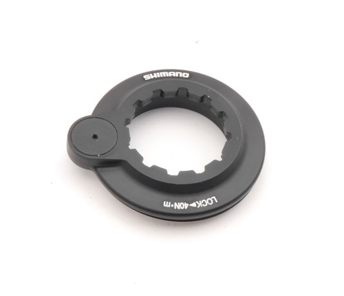

Just use a separate magnet, something like this
Or this
Just double check it puts the magnet in roughly the right place for your frame, Then you can use any rotor you like.

That's the Shimano lockring that I'd seen. I don't think it's compatible with the Rise though. Rise uses ew-ss301 sensor and the lockring is meant for the ew-ss302 sensor. I think from looking at it, the magnet will be too close to the centre of the rotor for the speed sensor to pick up on it.
Or this

I'm using the tektro magnet on my fuel exe, it works fine on my bike, but I appreciate it may not be the same for the rise. Id be tempted to try that tektro magnet and if it didn't work, hacksaw it and cable tie it to the disc In the right place.

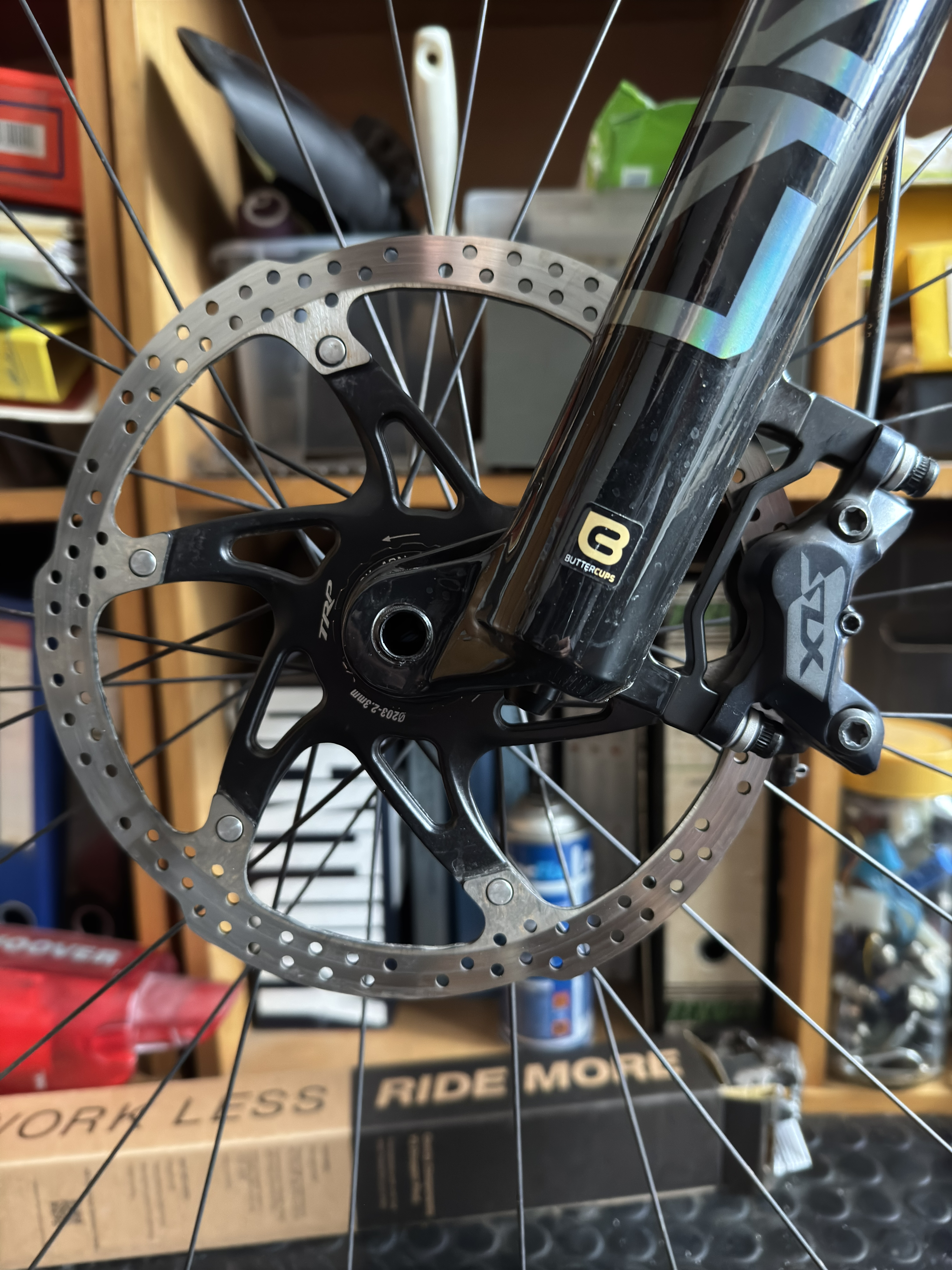

TRP discs with Shimano SLX 7120 working nicely
