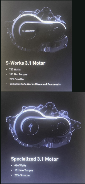

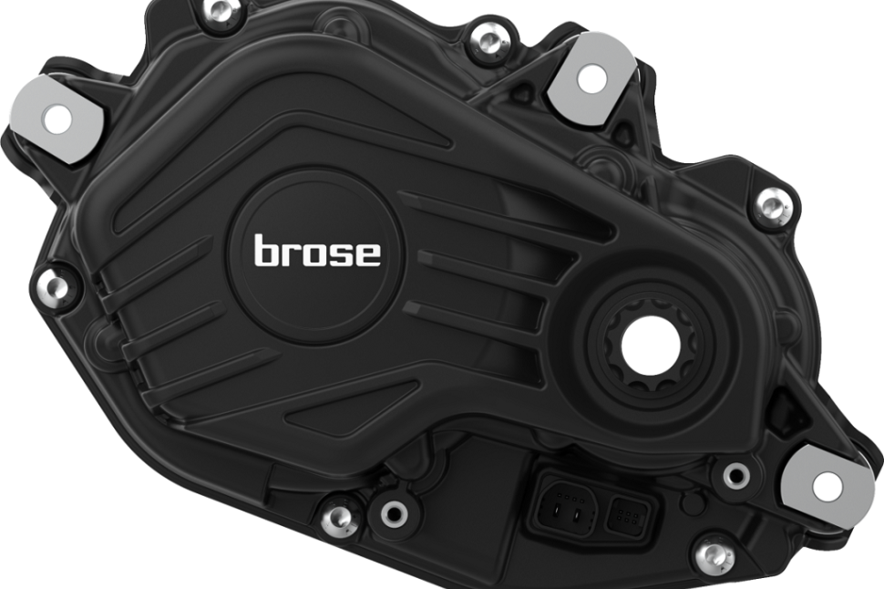

So it looks pretty much the same but with a different outer facing. The Drive3 motor is also pre-production so things will change.

Jun 12, 2020
107
86
lake Tahoe

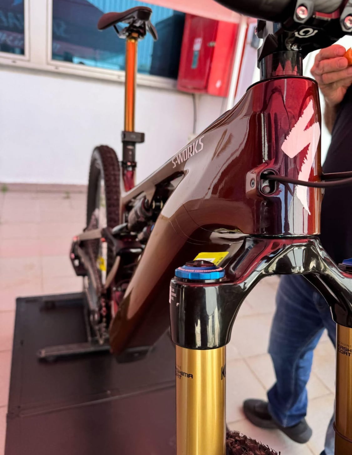

Looks that way. The "exclusive to Sworks bike and framesets" suggests it's not just a software change. The Sworks appears to be missing a mounting lug compared to the standard also.
To me it appears that the third lug on the Sworks has been blacked out in the picture. I agree the 101nm to 111nm difference is most likely software.

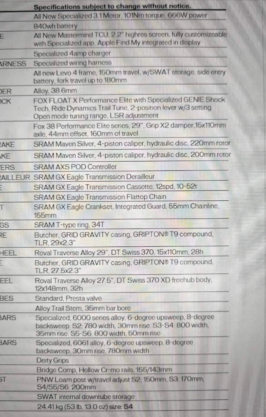

23.5kg, is that a joke, for 14000euro? This wight you can buy for 8000euro, or dji for 6500euro 21kg give me a reason where this is justified to buy?

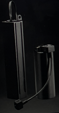

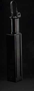

So, we have established that the range extender is external and 240 W. Can we confirm that when paired with the main battery of 600W or 800W, the added power from the extender is drained simutaneously w/ main battery (as is case with the present Levo SL), meaning that the 50 % power restriction of the Extender (only) application would not apply?
emtbeast
Jan 10, 2022
440
510
Slovenia
When I asked if the extender would mount externally, I was told it also goes into the downtube. I was surprised/skeptical but have no reason to doubt my source. I assume he meant the main and extender batteries would be in there concurrently rather than one-at-a-time. But perhaps you'd be limited to what combinations of different capacity batteries would be allowed (e.g., would 840Wh + extender be supported?). I got a quick glance of a photo of the 840Wh battery but couldn't determine its length.
The new Levo downtube reminds me on my all newer downtubes with Bosch new 800Wh packs.
For example the downtube on my Reign is cca 500mm long(the battery opening)on an M model. The battery size of the 800Wh pack is 440 x 85 x 78 mm.
For example the Dji 800Wh battery that is built thiner but longer compared to Bosch is 561mm long, it's probably one of the longest batteries I have seen.
For example The Bosch 800Wh pack has
dimensions of 430 x 75 x 81 mm
and the almost square shape(cell stack) seems to me that it could fit pretty nice into the Levo downtube so I will take it for reference.
Let's do some math:
Length 430mm/800Wh = 0,5375mm/Wh
Levo:
840Wh x 0,5375mm/Wh = 451,5mm
280Wh x 0,5375mm/Wh = 150,5mm
Together that makes 602mm of length, if we add say cca 13mm for connectors between packs, that adds up to 615mm of combined length.
The downtube of the Levo would need at least 615mm of open space to just fit the two packs, aand only tthen after the motor space and steerer tube space of the fram comes into play, don't think it's possible.
I believe that only the smaller battery and extender can live simultaneously in the downtube.

The extender looks to be more rounded like a bottle cage type mount. Where as the main 840wh battery looks to have some intrinsic rails and maybe a connection latch.
The 600wh battery appears to have a built in structure to make it mount in the same space as the 840wh - so no space for a range extender with it.
