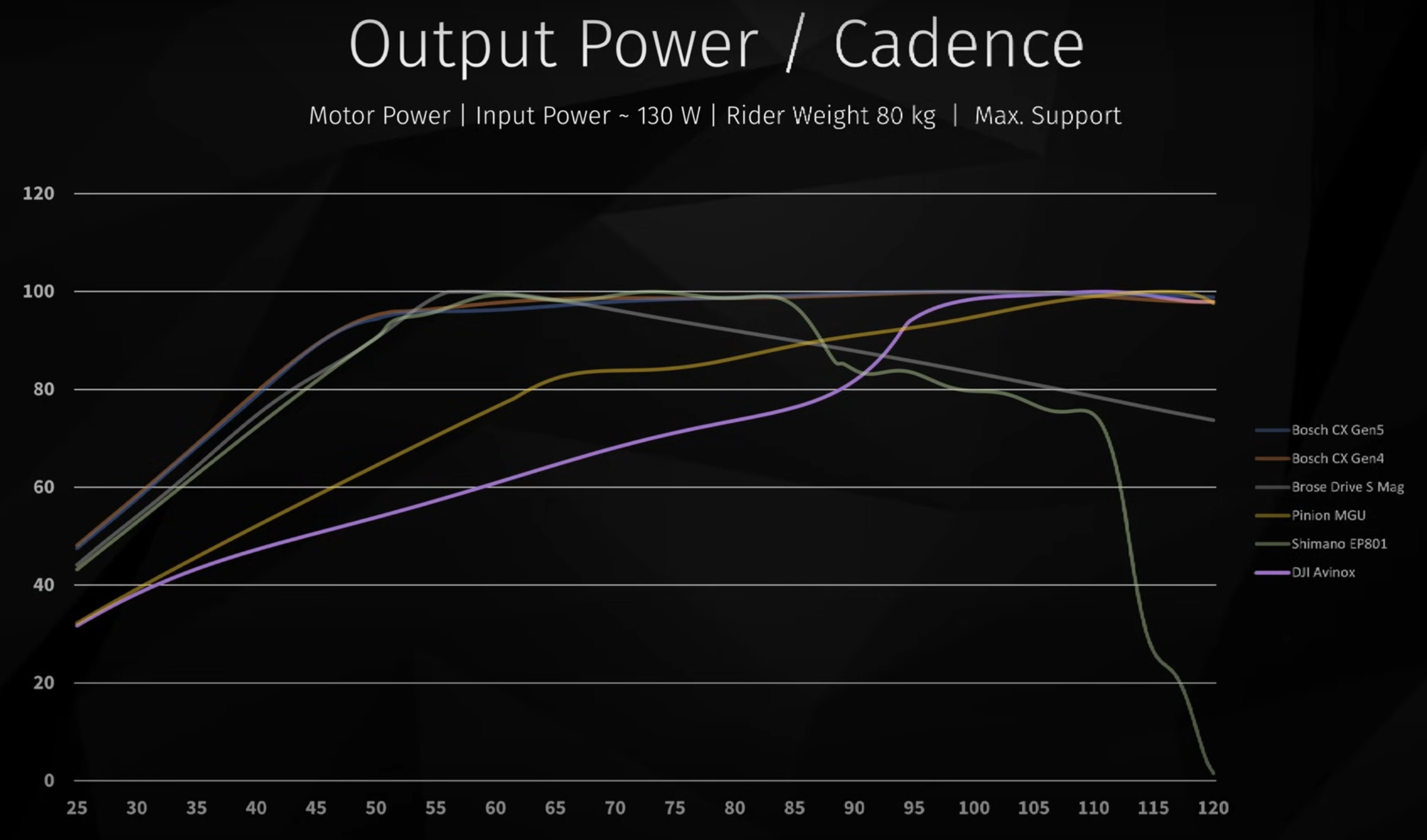

If the new Levo motor is anything like the current one, you may be right:
As can be seen, the DJI Avinox will only produce ~100% of the peak power (850W) at a cadence of 95 or over, where the Brose motor only requires 55 rpm. But you also have to factor in rider power as DVI Avinox has a 800% assistance where the current Brose has 410%.
If you haven't already, check out the Velomotion channel: Velomotion Magazine EN
That was with the first firmware.
Now the graph from the same magazine is this:
Lets wait for the line of the new Levo….

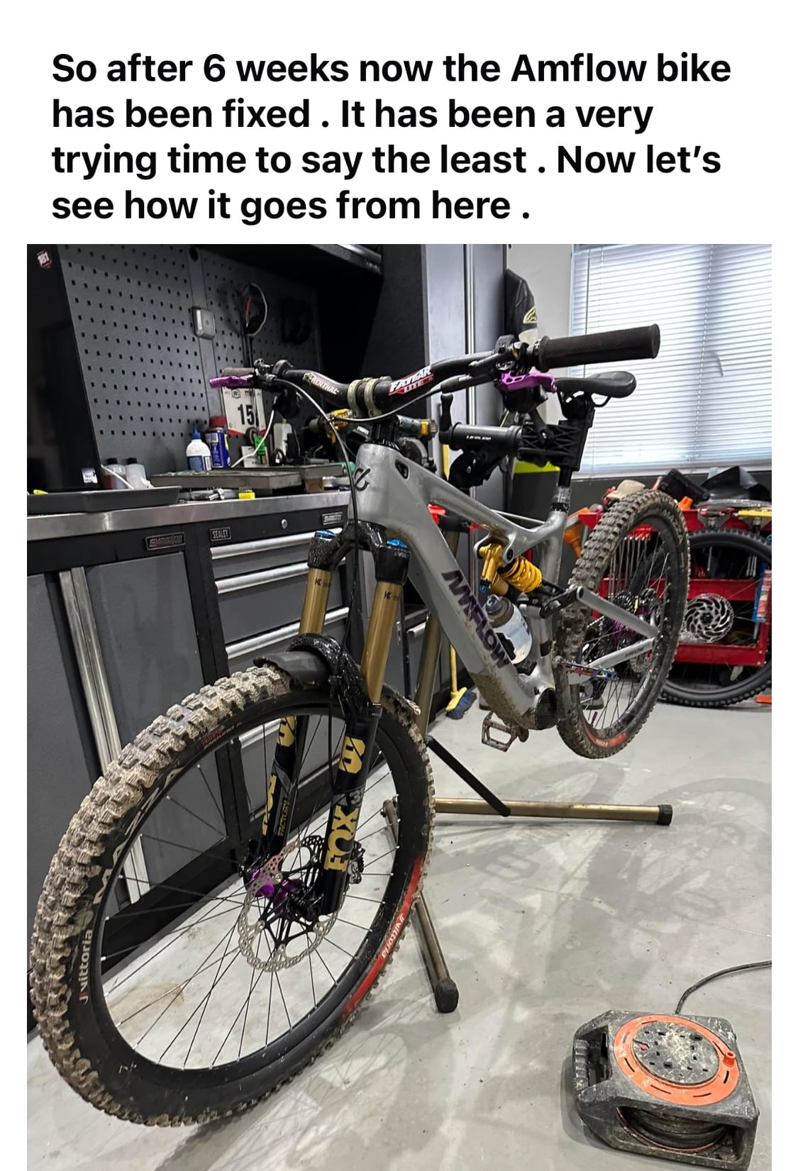

He has a point though, the shop any shop for that matter is only as good as the support from the supplier. My AMflow has been perfect but I do know one chap who’s new 3 weeks old AMflow was broken for nearly 6 weeks while waiting to be fixed, in the end the shop stripped down his own demo to fix the customer bike. I don’t mind paying a bit extra for the Spec S works taking into account the back up and support I have received over the past 6 years from my local Spec shop.
A decent dealer would have maybe acted much sooner than 6 weeks though.
It wouldn’t take much for said dealer to determine what was wrong, speak with the bike supplier and get an approx date for the spares to be supplied, or a solution (using parts off of the demo bike) for the customer.
6 weeks? Crazy. That dealer has put his own needs in front of the customers needs.
Apparently the fault could not be diagnosed.

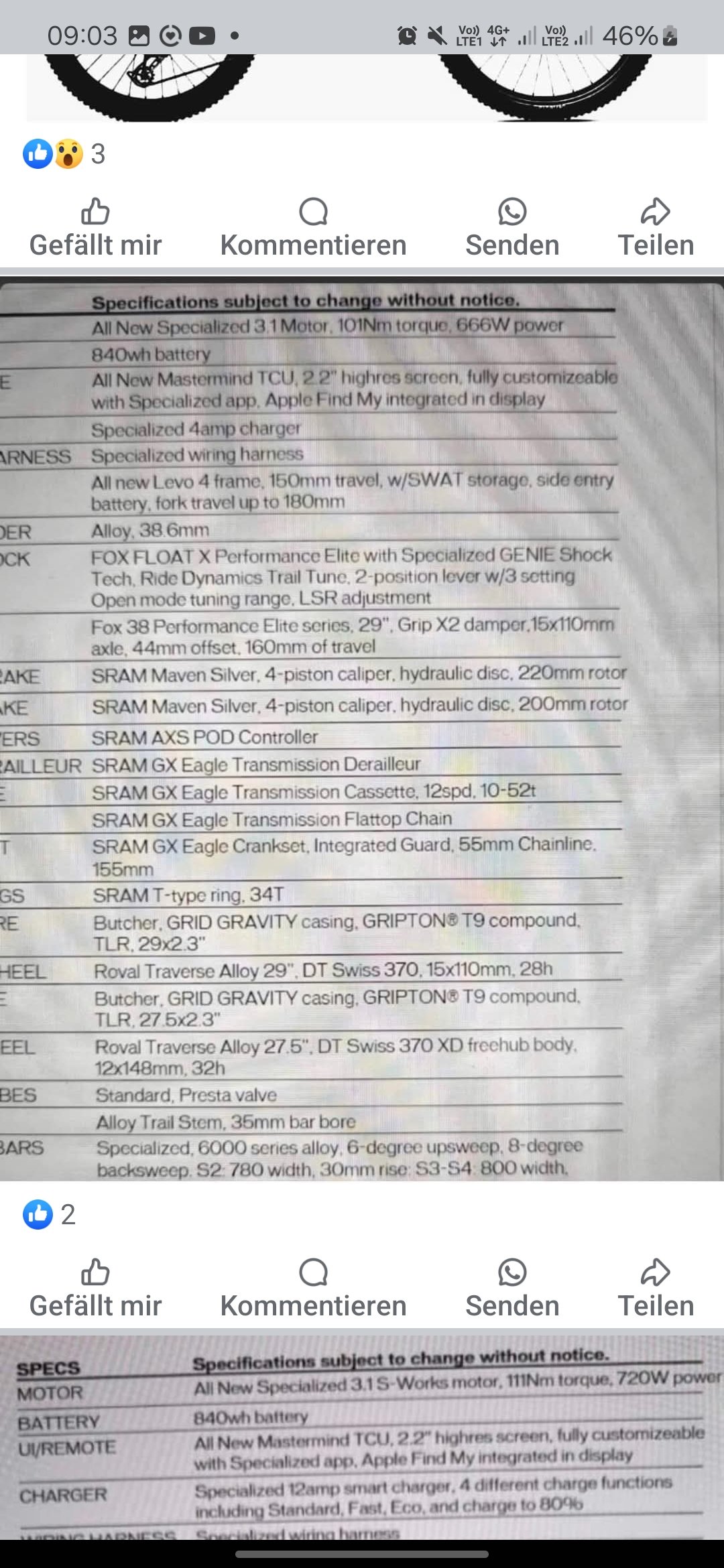

Thank you to those that posted the specs .... It has really helped me decide...
I don't need 112nm and I don't want fast charting, I have also already build my G3 expert level to close to S-work spec.
This means I can get a Comp ..... put all my components over from my G3 expert over to the G4 comp....
and ill have a close to s-works specs G4 ... and I can then convert my G3 to wireless Shimano when it comes out.

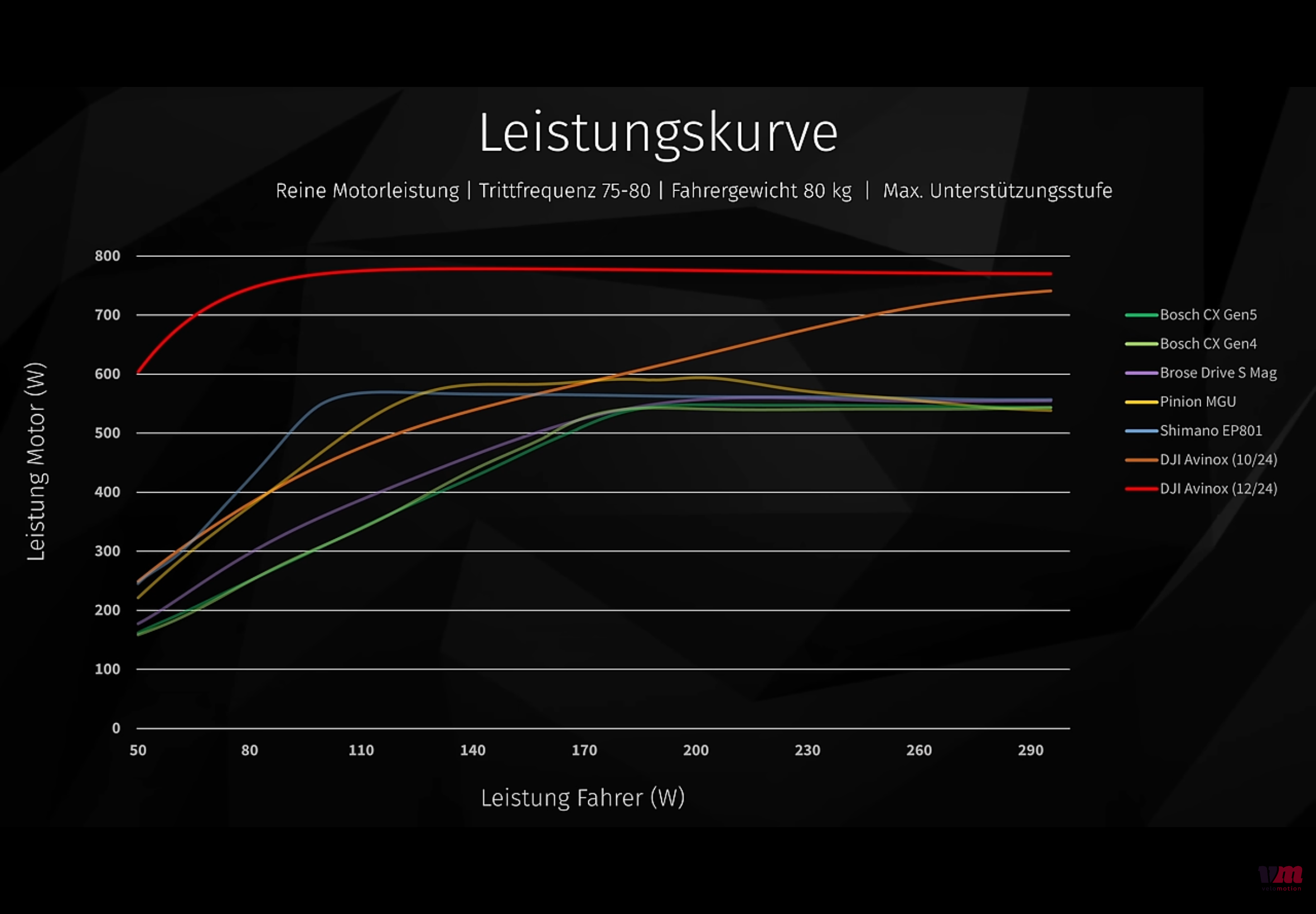

That's output power/rider power graph, the one above it was output power/cadence. It would have been nice to see a torque/cadence graph also. But I guess they don't really measure the torque at the crank and they are using output data from motor electronics. Specialized gen2/3 will pull up to 20amps so will get to about 800W electrical power when the battery is fully charged.

Sorry, but the guys saying the Levo could provide more torque at lower cadences are probably on to something. The guys from Specialized also pointed in one of their last year interviews they are working on a good cadence curve, also Brose motor was always good at that. This low down torque is mostly based on the motor mechanicals, not software-the larger the big internal motor gear the more torque down under there is, the previous Giant motor was/is also a good example.
To clear things a bit, the graph u posted is not the correct graph to compare to the other one:
The graph you are posting is Power based at almost(75-80) fixed Cadence input:
》Bike power output(vertical) based on Rider power input(horizontal)《.
The previous graph, the one you are answering to is Cadence based on fixed Power input:
》Bike power in %(vertical) based on Rider Cadence input(horizontal)《.
Shortly, the base for the graph is different so you can't compare it, one is a so called Power Curve the other ia a Cadence Curve.
Unfortunately Velomotion Magazin didn't include the Cadence Curve Graph in their video done after the Amflow software update, I don't know why, maybe they could provide one if asked.
