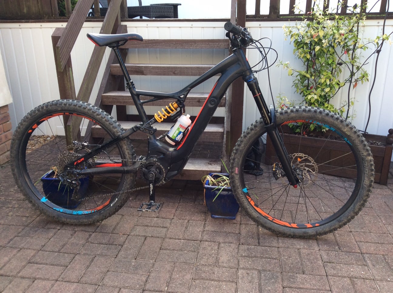

Hi All,
I have been a bit busy with other things lately so have not had much time to visit the forum.
TF Tuned are the people to contact if you are based in the UK. Greg and Dave created my custom shock. It took a few attempts as the Specialized website eye to eye measurements were incorrect so the first attempt ended up being too long.
I will not go into all the gory detail of what we tried and what did and did not work as I do not what to confuse things :)
The following is what was done to my 200mm eye to eye Cane creek DB Coil with a 57mm stroke
1. Changed the 200mm shock body for a 190mm shock body.
2. Shortened the stroke down to 55mm.
3. Installed an off set bush.
4. Using their on site lathe TF Tuned skimmed 1mm off the connection point of the shock and yoke.
5. I weigh 75KG all kitted up so for the above stroke I went with a 525lb spring which gives me what I wanted on the sag front which is 30%.
6. TF Tuned tuned the shock to my weight and riding style.
The end result was the DB Coil shock length was reduced to 187mm which was almost the same length of the my original Fox air shock which was 185mm. See the picture below regarding where I took the measurement. The Fox shock had a 45mm stroke. I now have a 187mm x 55mm stroke customised DB Coil. That gives the DB Coil shock an increase in stroke of 10mm. Travel wise I believe it has increased to around the 159mm? Please Feel free correct me if you think my travel calculation is wrong.
There is still room for a bottle in my bottle cage as well although it is a very tight fit....
Since my last post, I have also put some SRAM Roam 60 Carbon 30mm wide wheels on the Levo. Running a 2.6 Magic Mary DH on the front and a 2.8 Butcher on the back. I will be changing the Butcher back this week to a Magic Mary 2.6 DH as the grip is far superior and the side walls are indestructibly thick.
I have also changed out the ‘Pushed’ Fox 36 180mm to RS Dual Position 180mm to 150m Lyriks and loving them a lot more than the Fox 36’s as to me, they feel a lot nicer on the small to medium hits as in, I can’t feel them anymore, they are that good :)
Hope the above answers your questions and is helpful to you all.

Hi All,
The end result was the DB Coil shock length was reduced to the same length of the my original Fox air shock which was 185mm. See the picture below regarding where I took the measurement. The Fox shock had a 45mm stroke. I now have a 185mm x 55mm stroke customised DB Coil. That gives the DB Coil shock an increase in stroke of 10mm. Travel wise I believe it has increased to around the 159mm? Please Feel free correct me if you think my travel calculation is wrong.

180mm Dual positon Lyrik on the front which allows me to drop down to 150mm if I feel the need.
159mm on the back
Plush, plush plush

You've turned your Levo into a Kenevo! (almost)
Hi Tori,
That was always my plan.
I bought the 2017 Levo secondhand at a really reasonable price to allow me to make the move into ebikes and with the view to carry out some major mods.
Now that it is done, I am really enjoying it.
Sounds like the compression ratio of the Levo is 3:1. You had a 45mm stroke giving 135mm of travel. You now have a 55mm stroke shock, so does that make it 165mm rear travel (3x55=165)?
Kiwi in Wales
Short cranks rule!🏴󠁧󠁢󠁷󠁬󠁳󠁿
Jan 24, 2018
1,241
1,589
Carmarthen, Wales
Hi Rob,
Looks like I made a mistake. I did the calculation using 46.5mm for some reason....... not sure why.... However, I have just taken all the air out of my old Fox rear air shock and compressed until it bottomed out and you are right it is a 45mm stroke so.....
135 divided by 45 x 55 = 165
An extra 6mm of travel I did not know I had. Thank you ?
While I was checking this I also double checked my sag and with the 525lb spring I am running 18mm sag which is around 33% to 35% sag. No wonder the back end feels plush. Happy days ?

Super nice! So you're running 180mm F and 165mm R. Bet it's a ripper!
