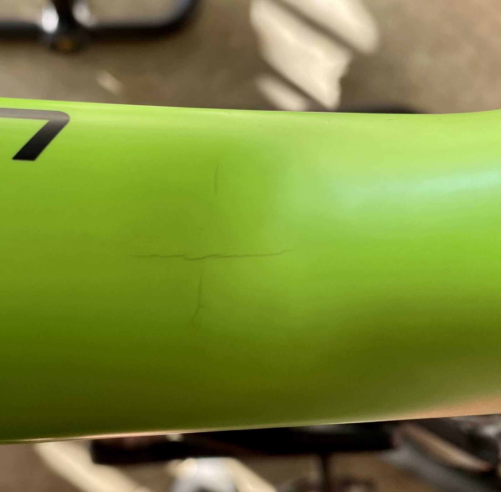

Seems my frame is cracking at the top tube seat tube area. I have about 2,180 miles on the bike and will be taking it into the shop on Monday to see what my options are. Anyone have a similar issue?

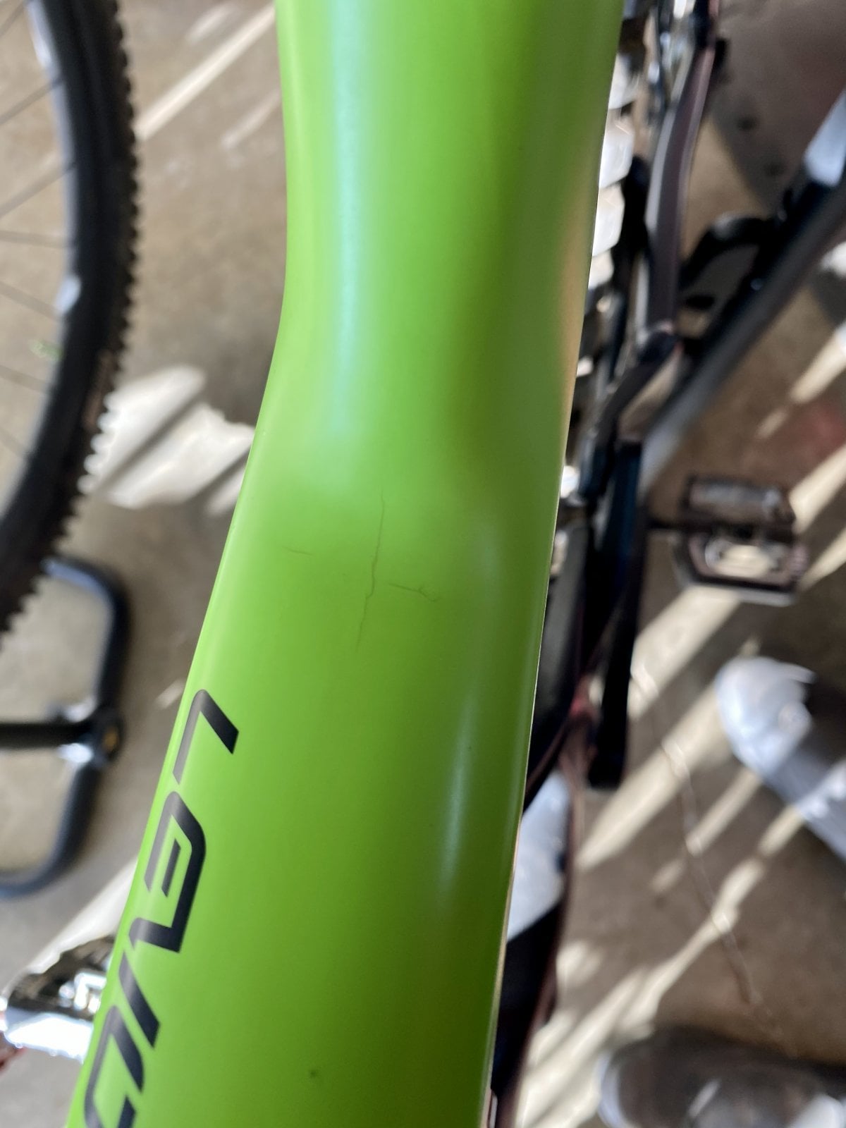

I also have one nasty looking crack below the L E V O text. There is also some creaking noise when the frame is under "twisted torsion". I don't know how to say it better.
The manufacturer has info about this. Local bike shop said that it's safe to ride and I should come back if something new comes ahead. It's SW frame from Nov 2018 and 5 000 km when I noticed the crack. Now I have 1 000 km more and nothing new has appeared.

Is there a way that Bike shop can certify if it's paint or not. Like rubbing down with wet n dry paper? I would want peace of mind even if it meant a bold patch

Cracked carbon frames are not safe to ride. As apac says, someone needs to certify whether its paint or the underlying frame. I would absolutely not take the bike shop on on their advice "if something new comes" as it could crack instantly which could cause a very bad incident.
Not sure where you guys are based but for you TMS, as you're out of warranty there are various carbon repair places that have scanners which can confirm 100% whether it is the frame or not - such as Reverie or Target Composites in the UK.
Fingers crossed for you both its just paint.

Well I'm from Finland but thanks anyway. The frame is inspected only with eyes and fingers. Pictures are also sent to Specialized. No scanners used.
I have good relationship with my local Specialized bike shop so I'm not worried about warranty or any other issues. But that's true, total and instant frame failure can hurt badly. Maybe I should be more active again with this issue.

Shop is contacting USA Rider care, I will let you all know what the solution is. Since I am on the east coast and it's is only 8:12AM on the west coast it will take a bit to get in the office and figure it out.

Hi There are plenty of places that can fix hairline cracks in carbon now days. Also a simple test they can do to tell if its cosmetic or structural. Worth search the web and asking for recommendations from your LBS.

You have had better luck than me, Specialized told my dealer the cracks are just the paint. I am contacting rider care myself as I do not agree that it shouldn't be replaced.

I installed Lupine R14 rear light and because of that I had to remove the seat post. And afterwards the creaking noise was gone. 200 km and it is still gone. Weird that the creaking noise was there even I stand on the bike and shook the bike from left to right. I couldn't guess that that was the problem. The paint is still cracked tough. I don’t bother to worry about it at the moment.

Update on my crack, Specialized thinks it is just paint but to make sure I am happy they have sent me a replacement frame. A nice new 2021 S-Works in Oil Slick & Black.
They went beyond for me once again and why I continue for 18 years to buy Specialized bikes.
I've only ever experienced customer service like that when visiting the U.S. That is a good outcome.
