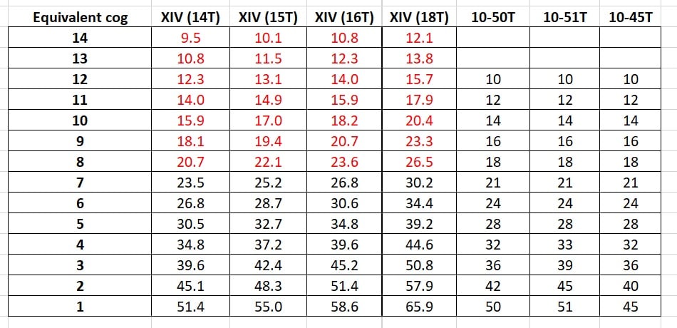

Since we are used to cassettes these are the equivalent numbers:
14T is equal to a 9.5-51.5T cassette.
15T is equal to a 10-55T cassette
16T is equal to a 10.8-58.8T cassette
18T is equal to a 12.1-65.9 cassette
source Kindernay/Facebook

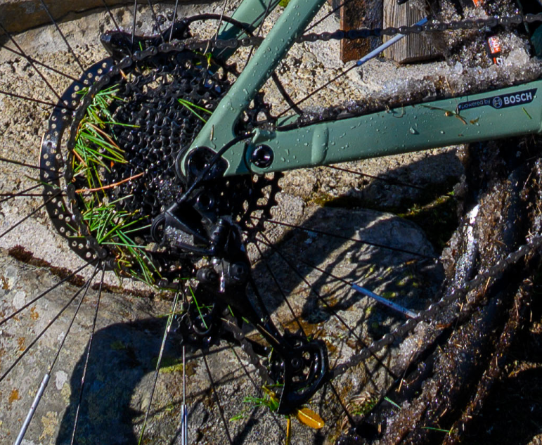

Have less problems with the chain eating things

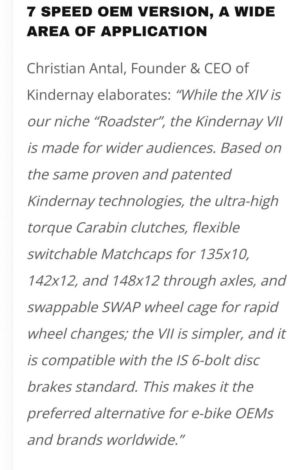

This was from the press release for the K7 and is the only reference I can find to the IS 6-bolt disk.
I told my shop to try for the 6 bolt, but get one coming regardless. The shop says they have a shipper, and the K7 is on the way.
