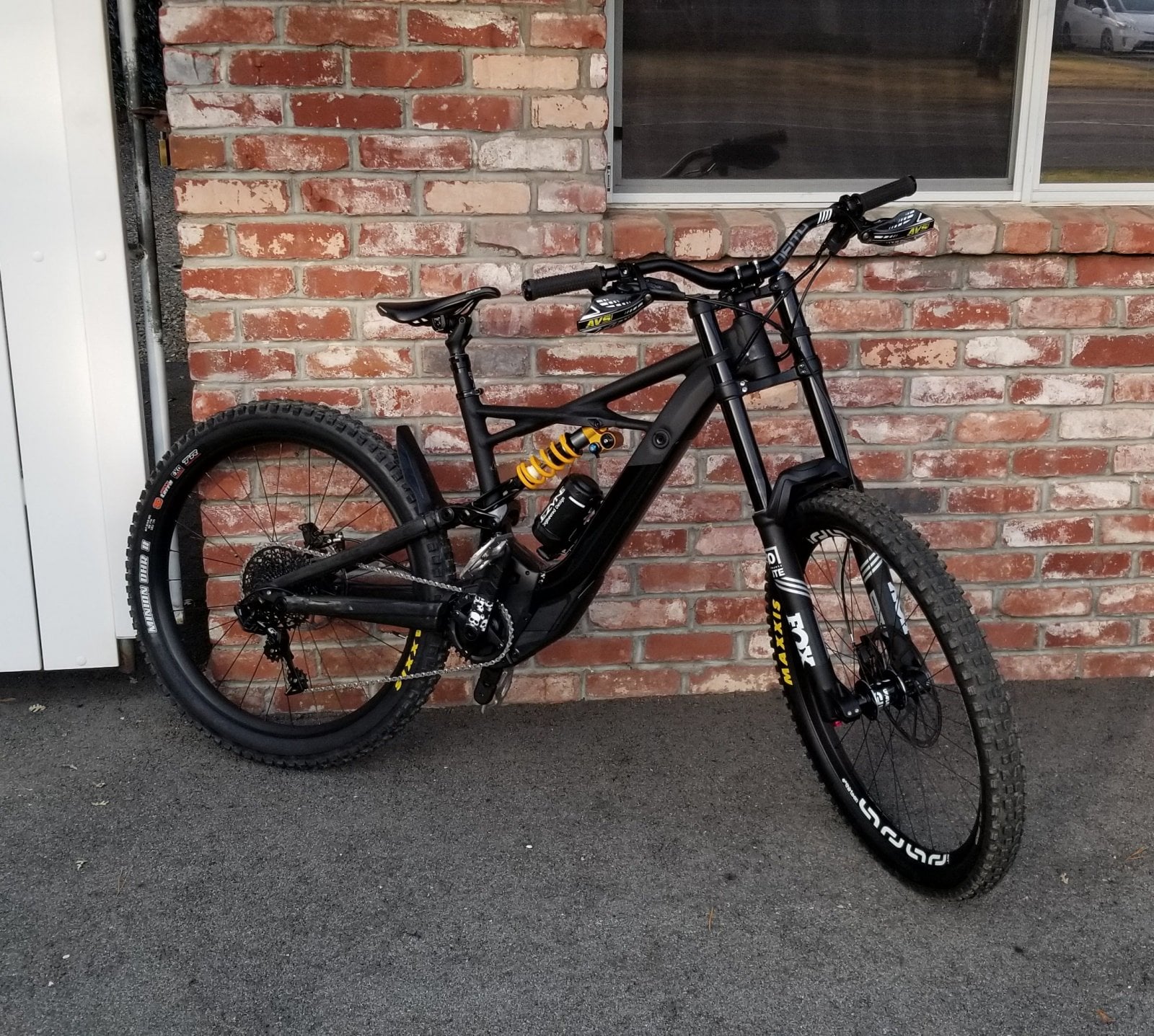

However full DH Kenevo do look the nuts and there's a certain unquantifiable confidence that having a dual crown gives you! This is my personal favourite, a shop n the UK did a limited run of these

Is there much gain going to 200mm, is it a 29 front?
The 40s look great in black
Thank you No stayed with the 27.5 up front but went with a 2.6 and 2.8 Rear
I'M 63 AND LIKE THE EXTRA TRAVEL!!!!!
Really like the way the dual crown Works and Feels
