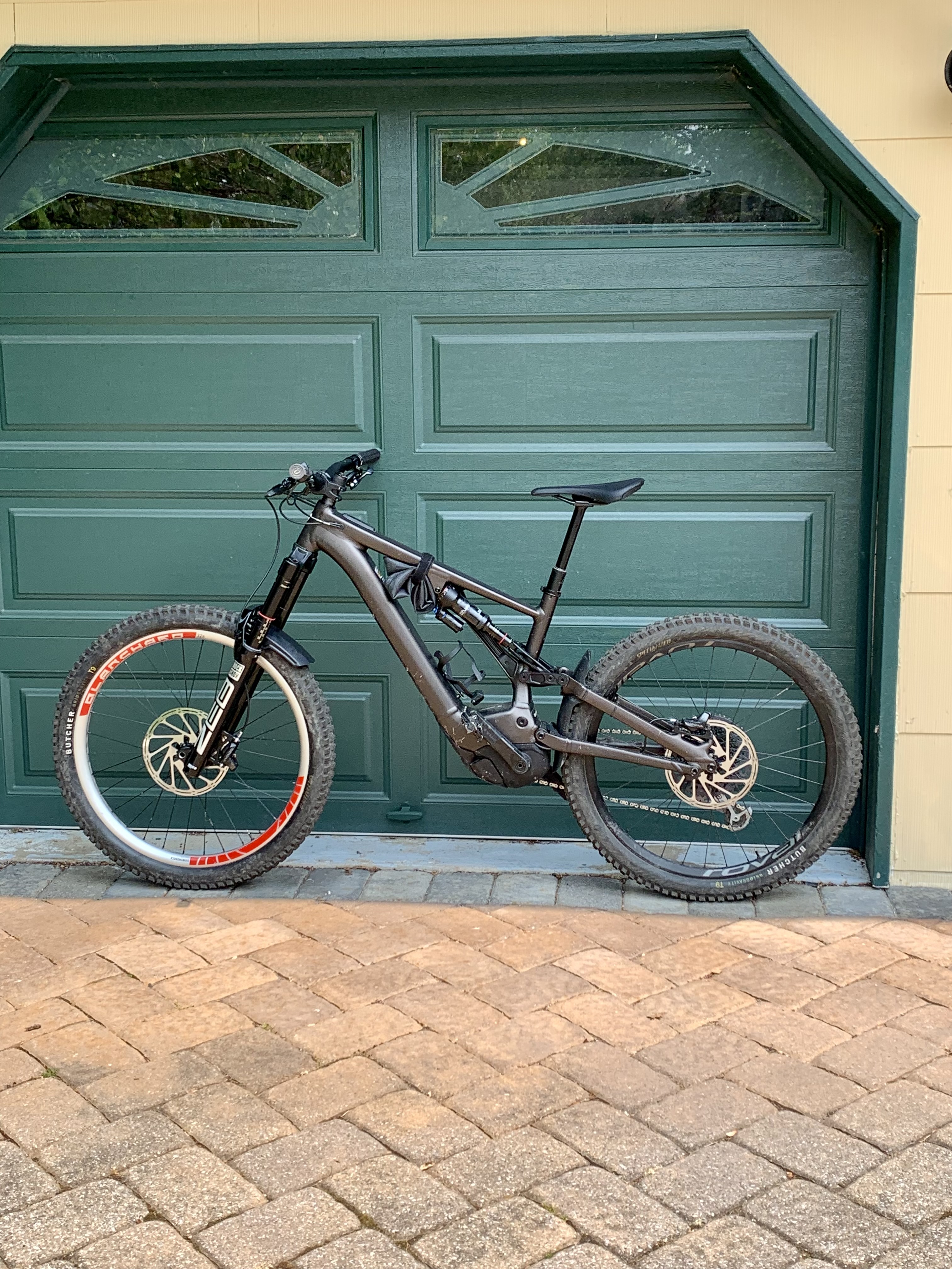

I own a 2021 Kenevo expert and I exchanged my dual crown boxxer fork for a 27.5 fox 38 with 180mm travel. My question is, does that change my reach at all? It might just be me overthinking it but my reach feels a lot shorter than when I had the dual crown on… I have a 35mm stem with 3 spacers underneath it.
Also I have ordered a 180mm zeb 29er to replace my fox 38. Will that change my reach at all too?

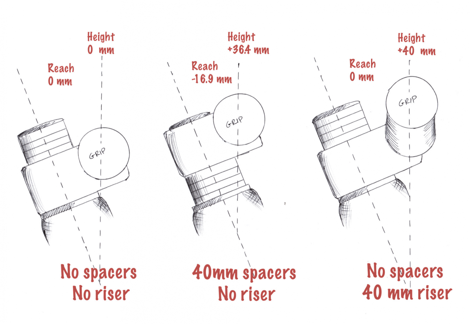

@Alexbn921 is correct - the dual crown 180mm Boxxer has IIRC a lower A to C than the single crown 180mm 38, and when you fit the 180mm 29 Zeb the A to C will be even more.
As such you are shortening the effective reach by swapping out the forks.Slamming the stem, longer stem, and bar rise can mitigate this, though obviously a longer stem also affects the handling.
