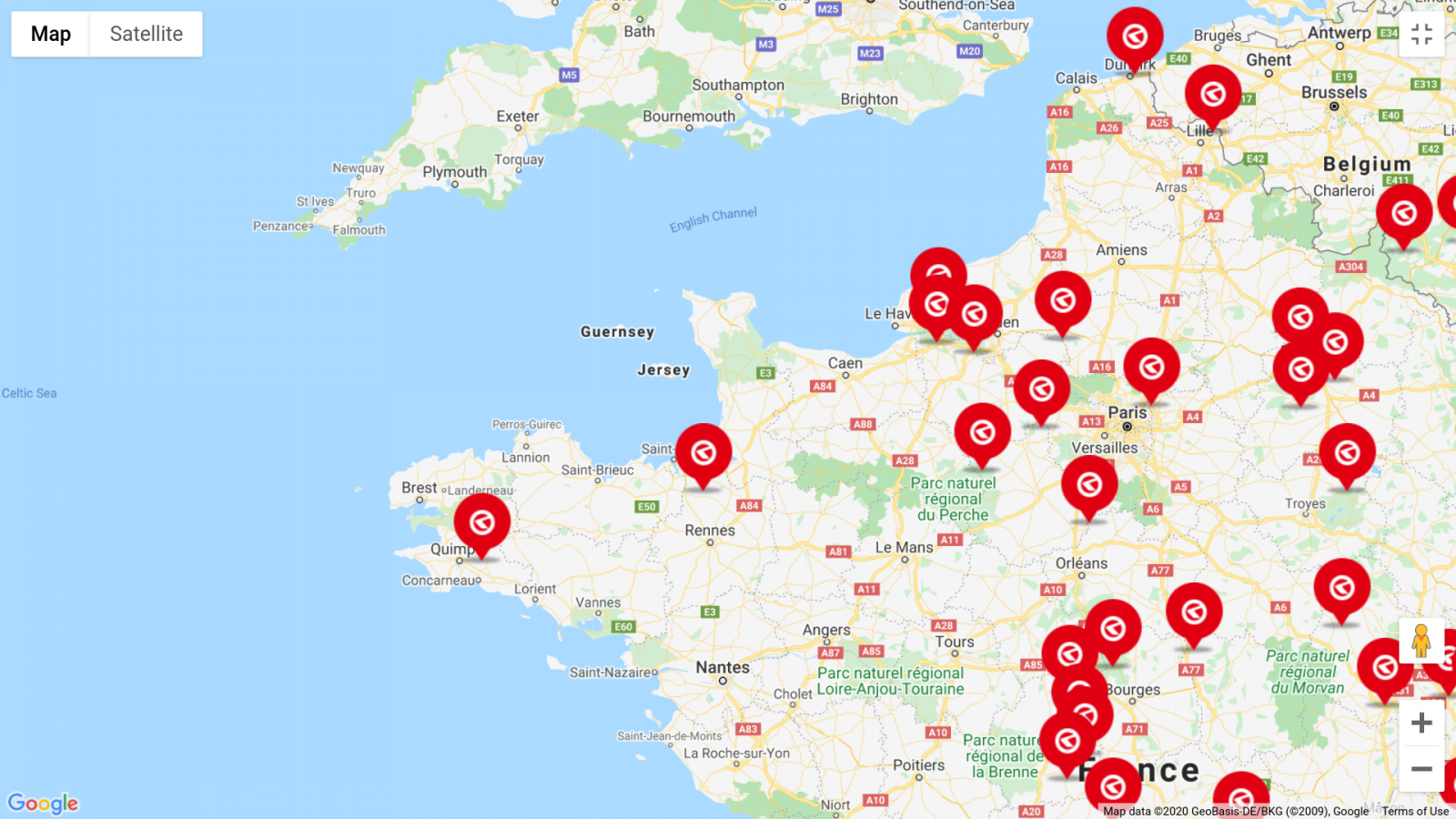

I was going to say I can't buy one as there aren't any dealers around - because the search doesn't work properly, but once you get in the map .. there are a few :

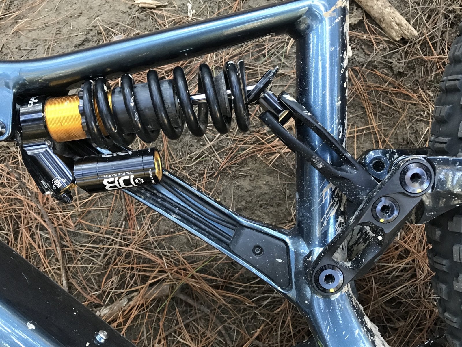

There's a lot to love on this bike but I'll never buy a yoke driven shock like the specialized again... Shocks shouldn't do anything structural, just dampening.
9,349
9,911
Good call, well noticed. :) I hadn't noticed, so I went back to look at the pics of the bike. The use of the word "yoke" implied to me that extensions from the shock passed either side of the seat tube. Not in this case. The shock appears to be mounted offset to the non-drive side, with a single extension central to the shock passing the seat tube and picking up the suspension linkage in one place on the non-drive side. Although the shock is offset, it remains parallel to the bike centreline. But the forces on the rear linkage are offset. I can only hope that the bearings have been beefed up to cope with that.

It's just silly putting the shock in a position where it's being asked to be structural. Should be damping only... There are sooooo many bikes that use this design but it's totally flawed imo.
Interesting Kelly's DH Bike has a direct linkage driven shock via a shock tunnel – but obviously droppers and motors make that hard on an enduro emtb. Pity, the design is nice otherwise.
