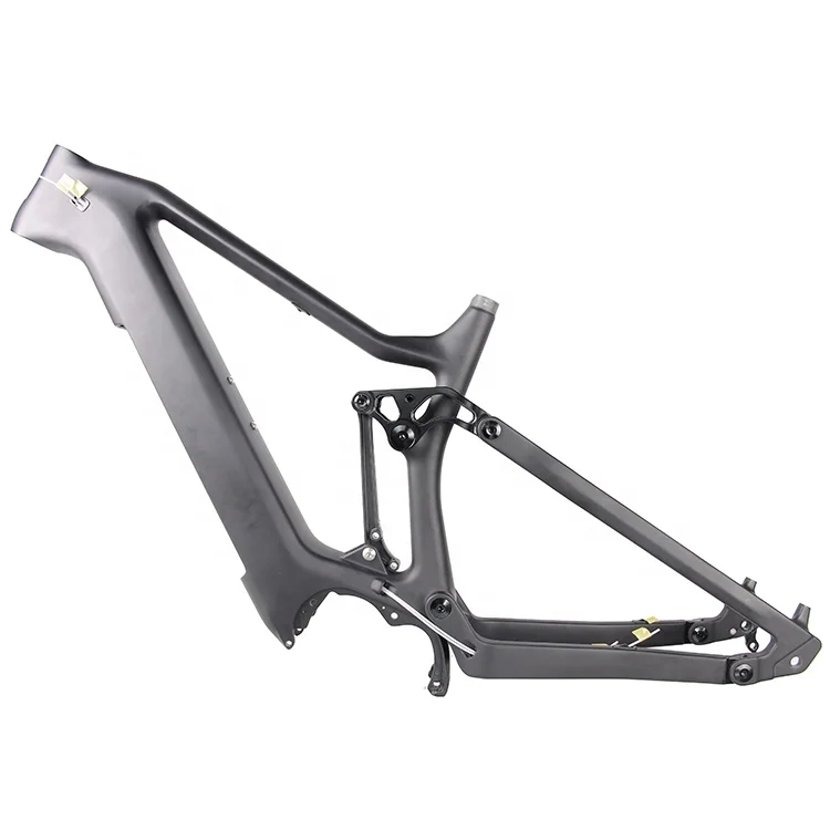

This question has been asked way too often. So I'm starting this thread to DELIBERATELY challenge brands who feel obliged to only offer complete builds for emtbs, knowing that a vast majority of riders are buying entry level emtbs options within a given model and upgrading them to a specification where they're satisfied with the build. Which somewhat proves that their is a market for emtb framesets.

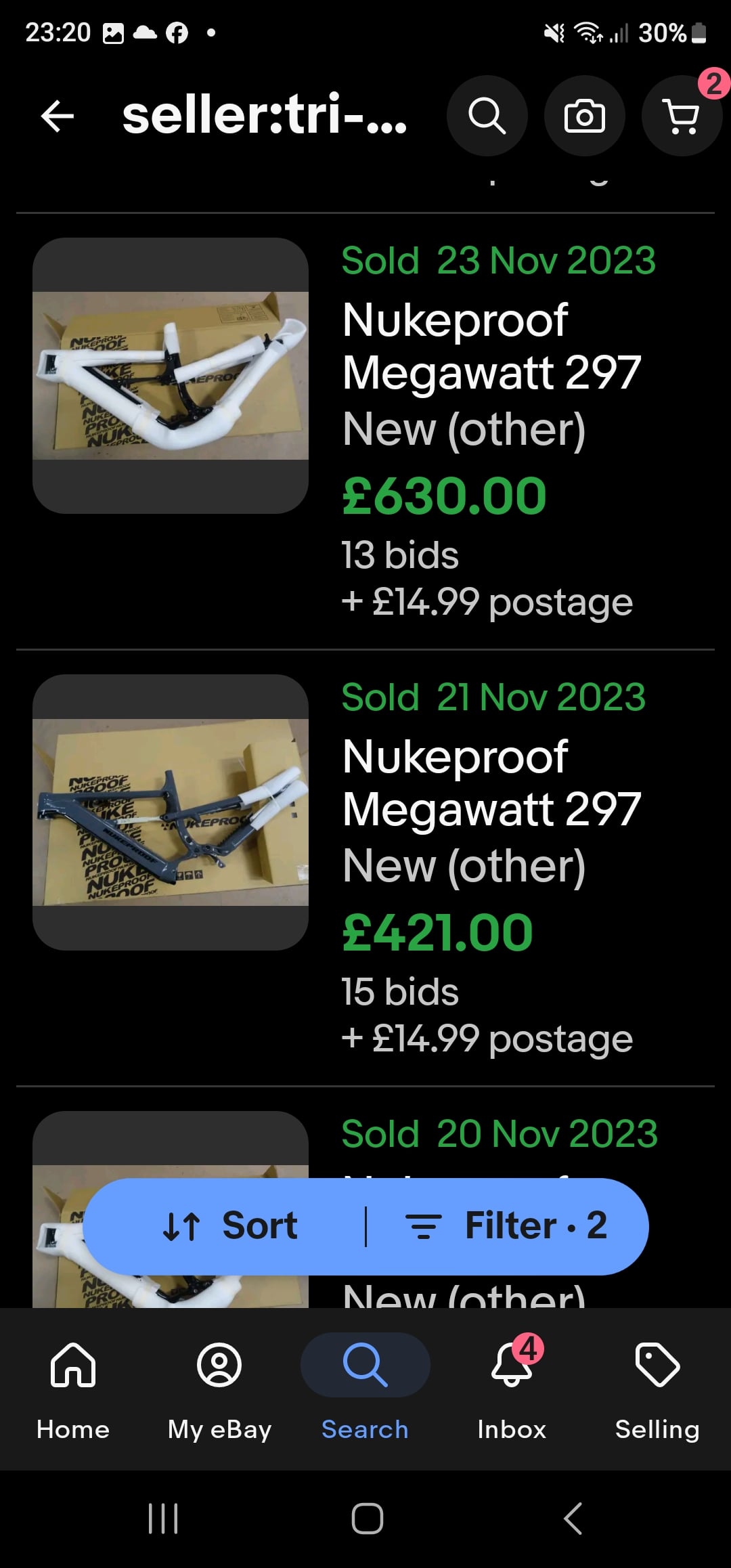

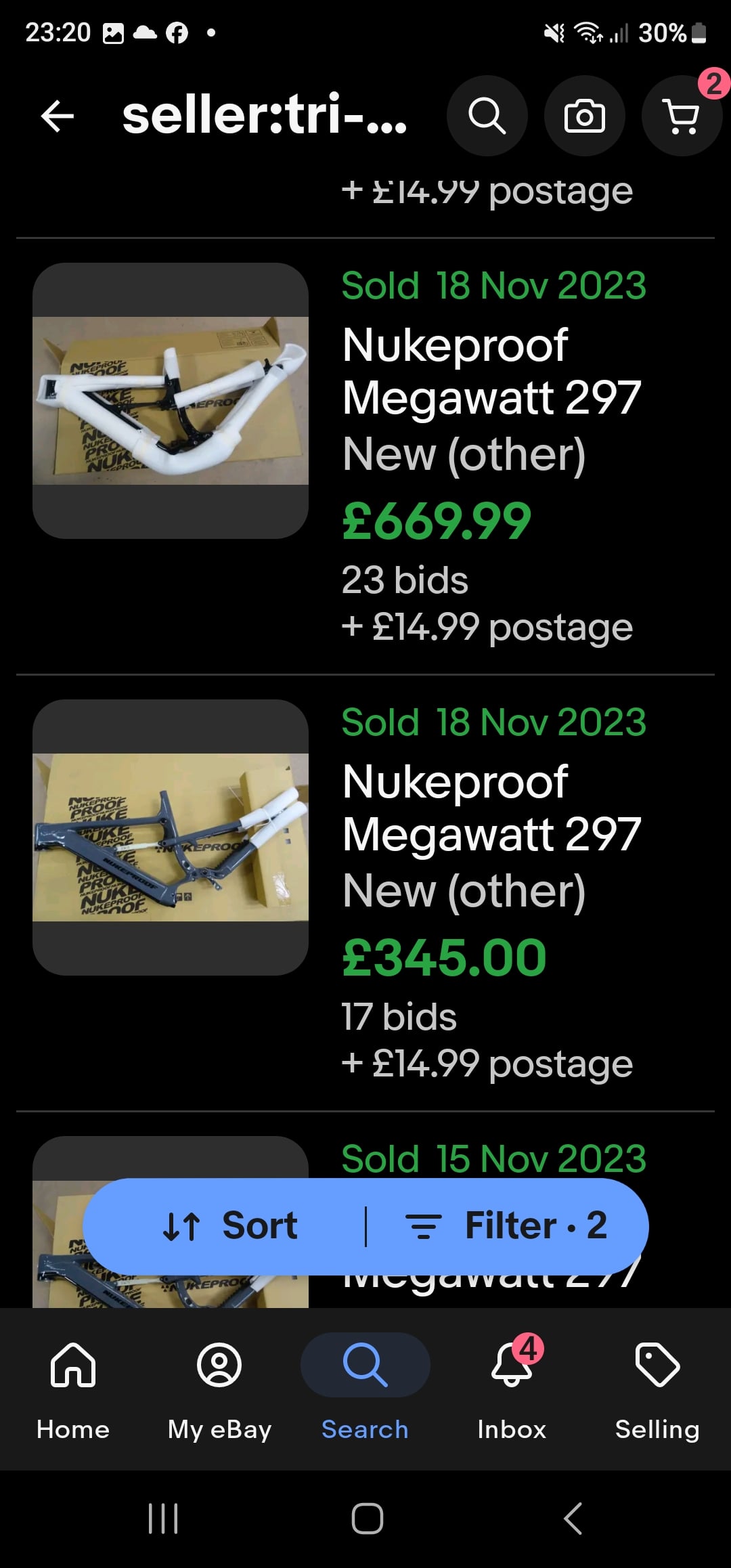

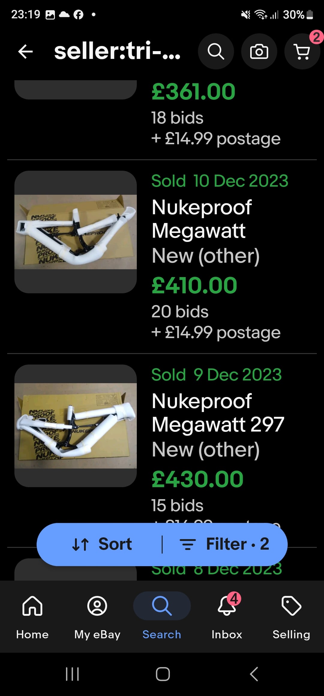

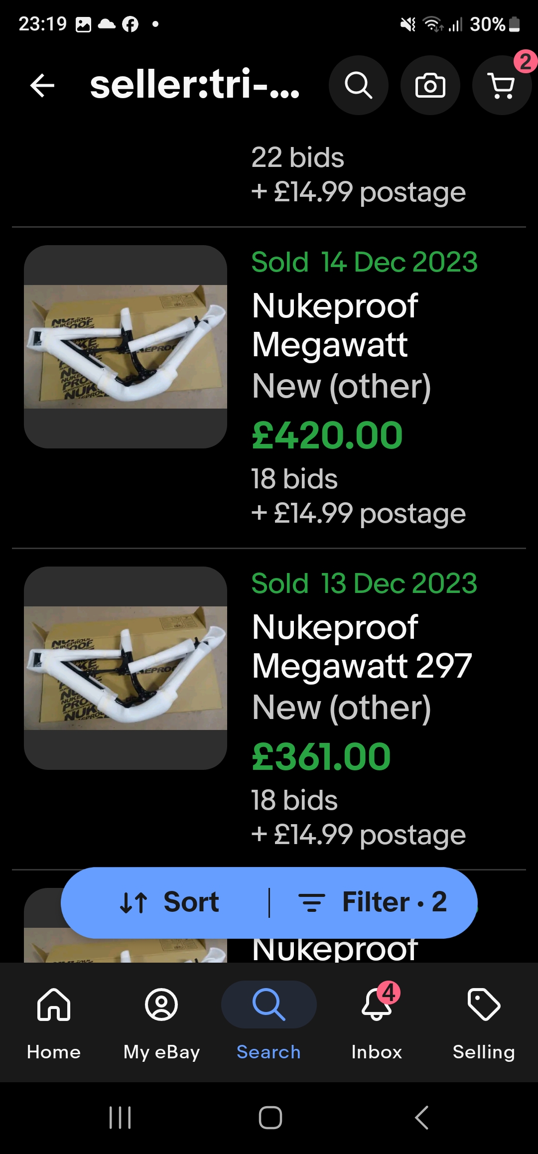

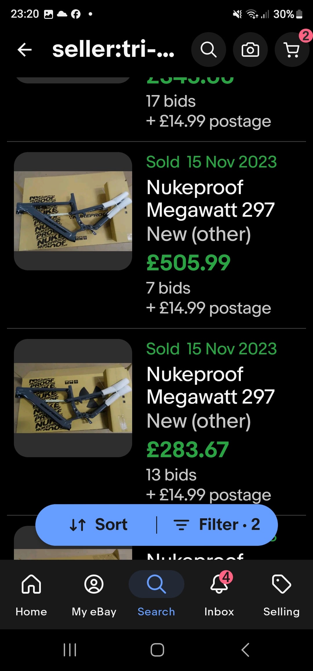

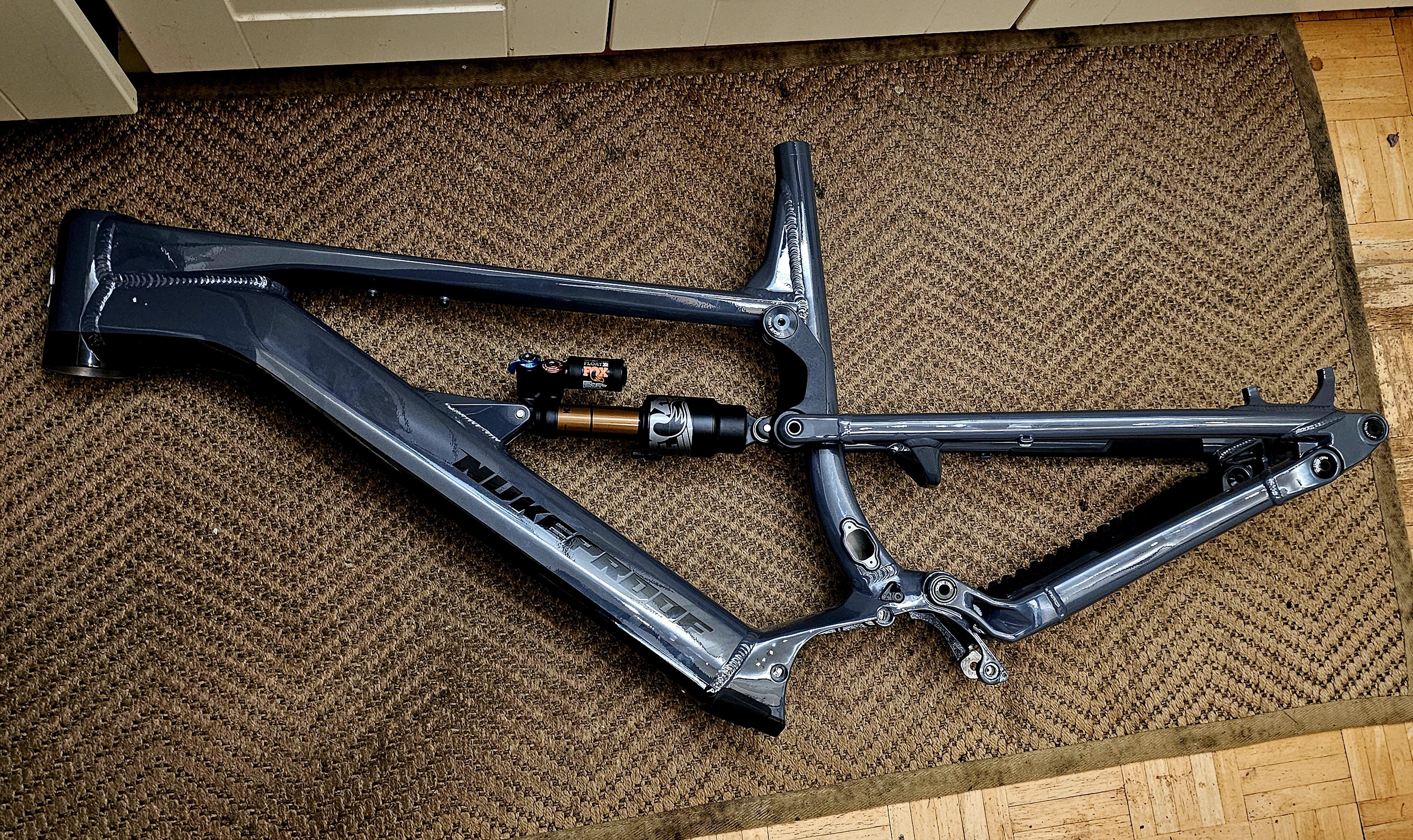

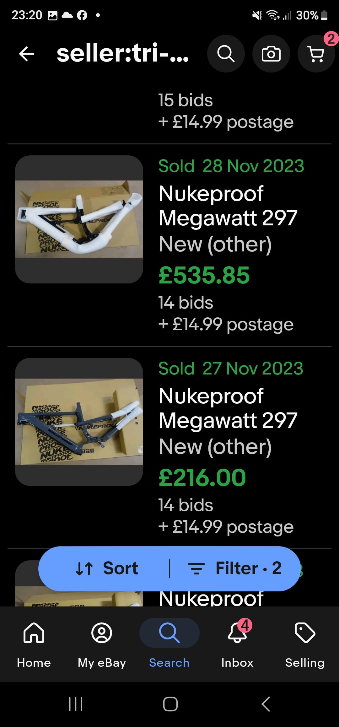

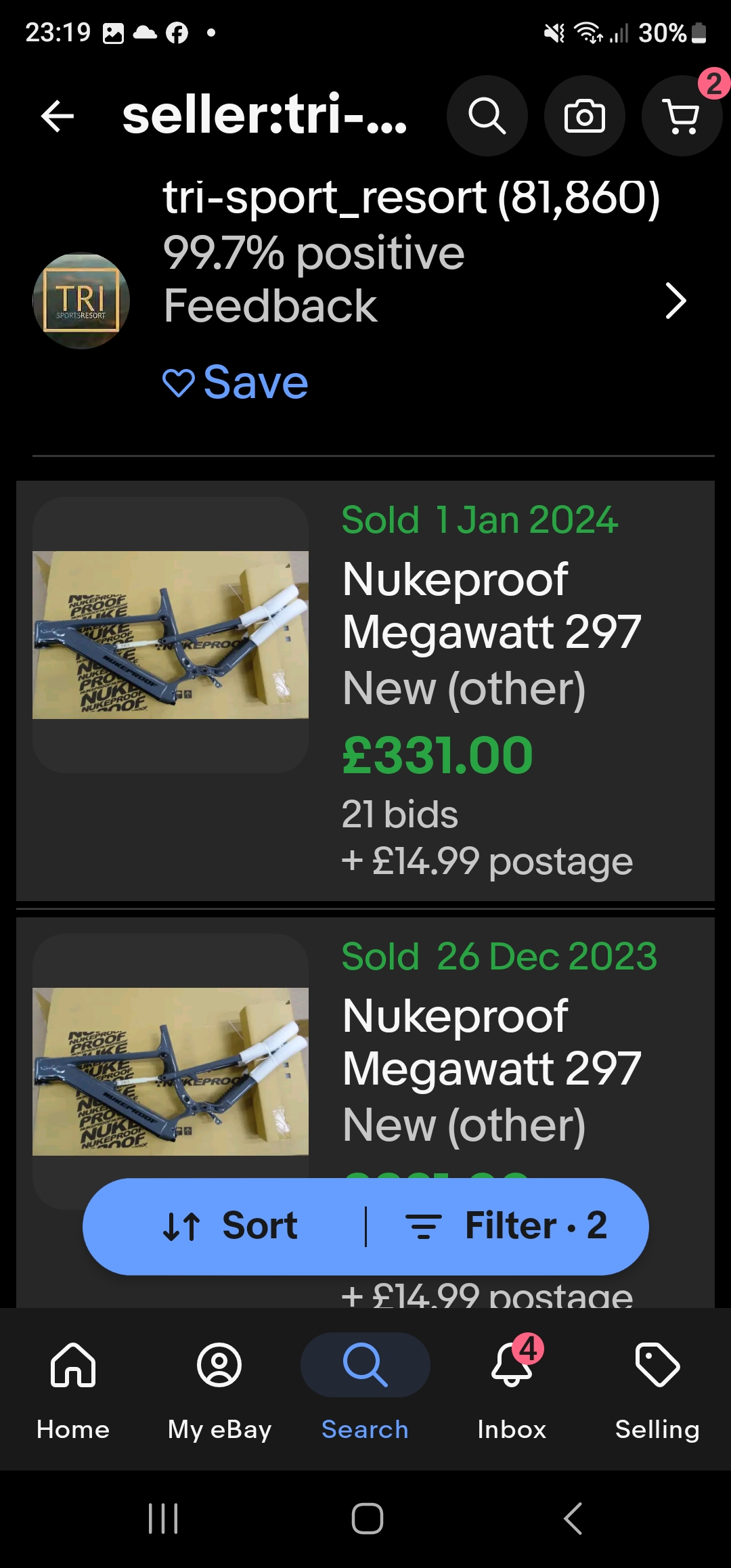

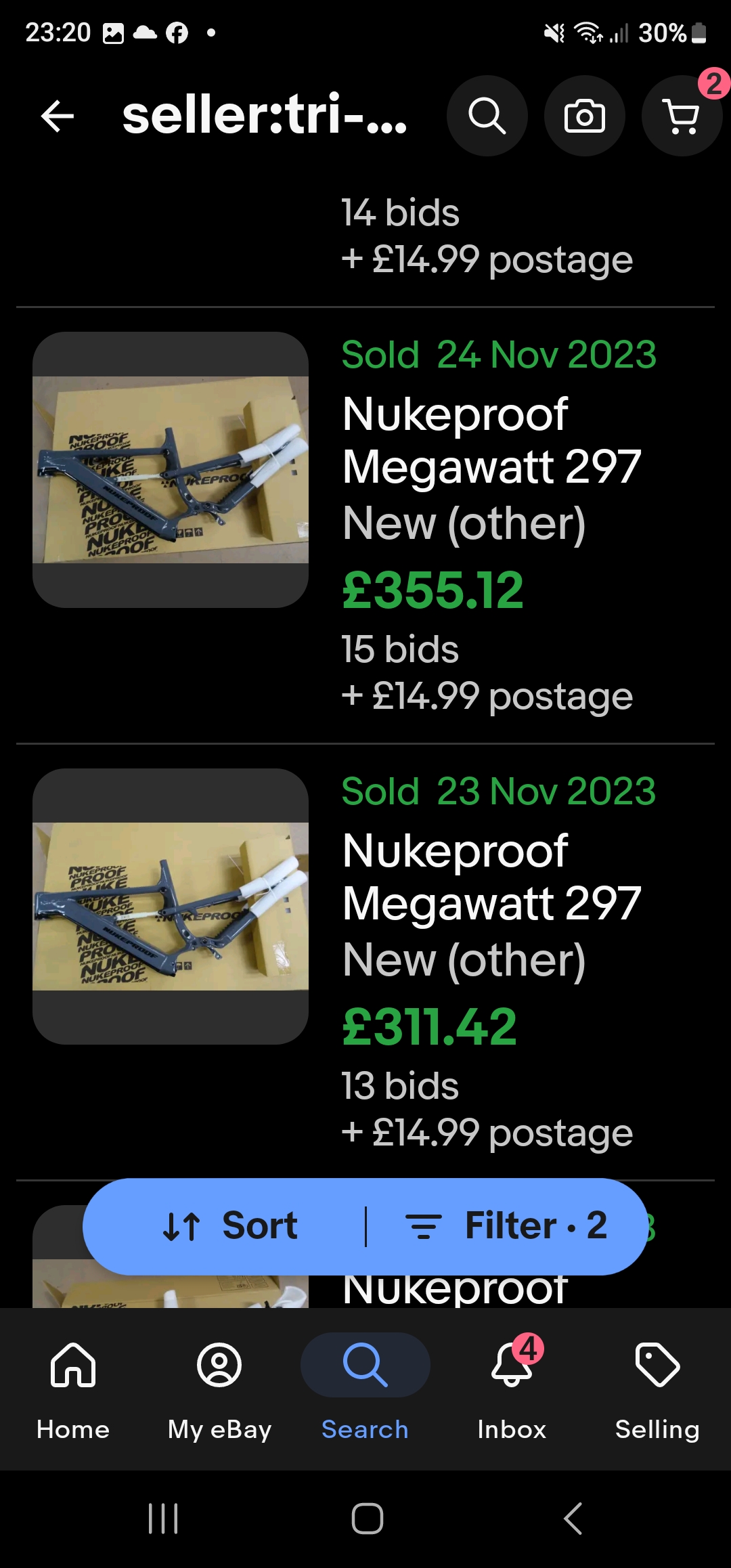

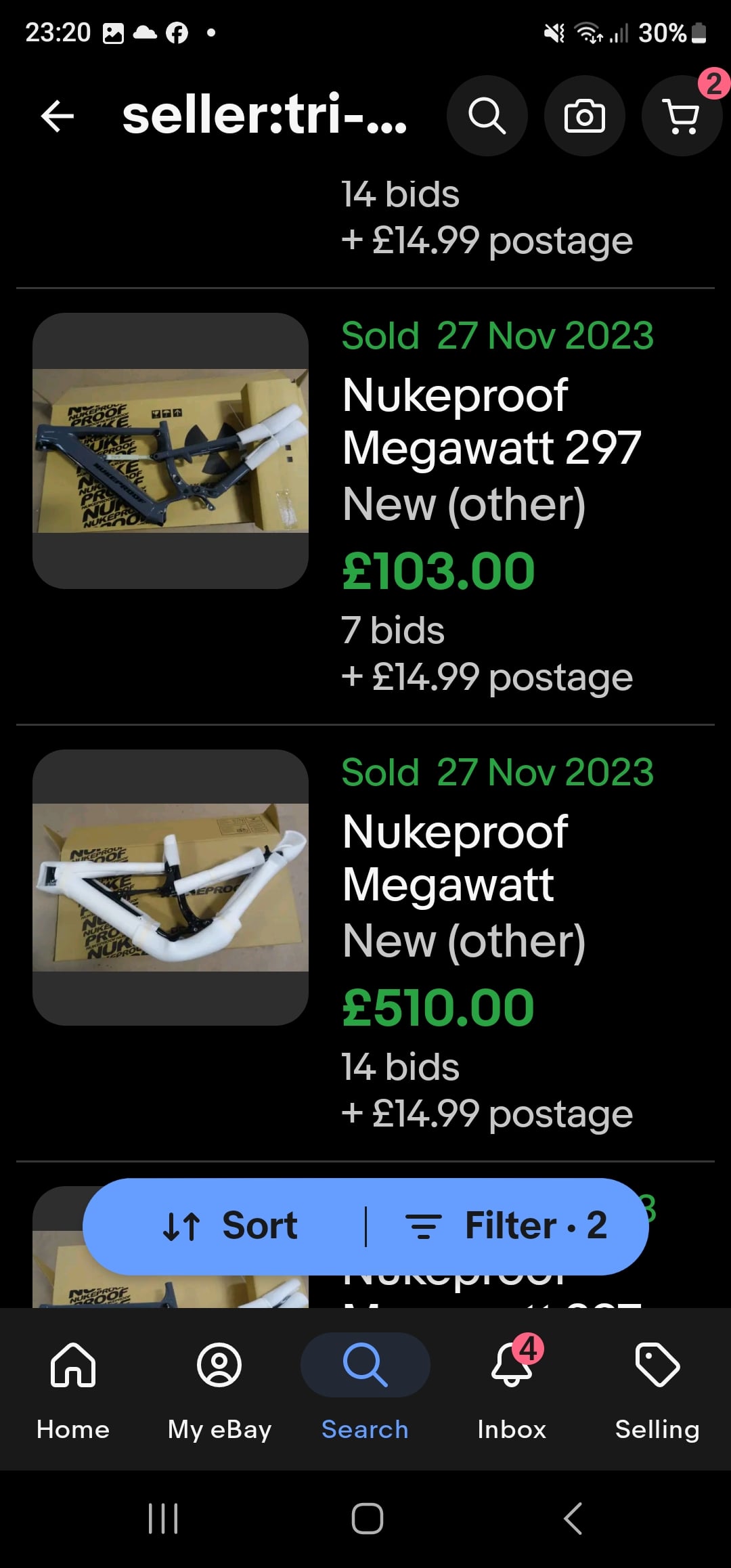

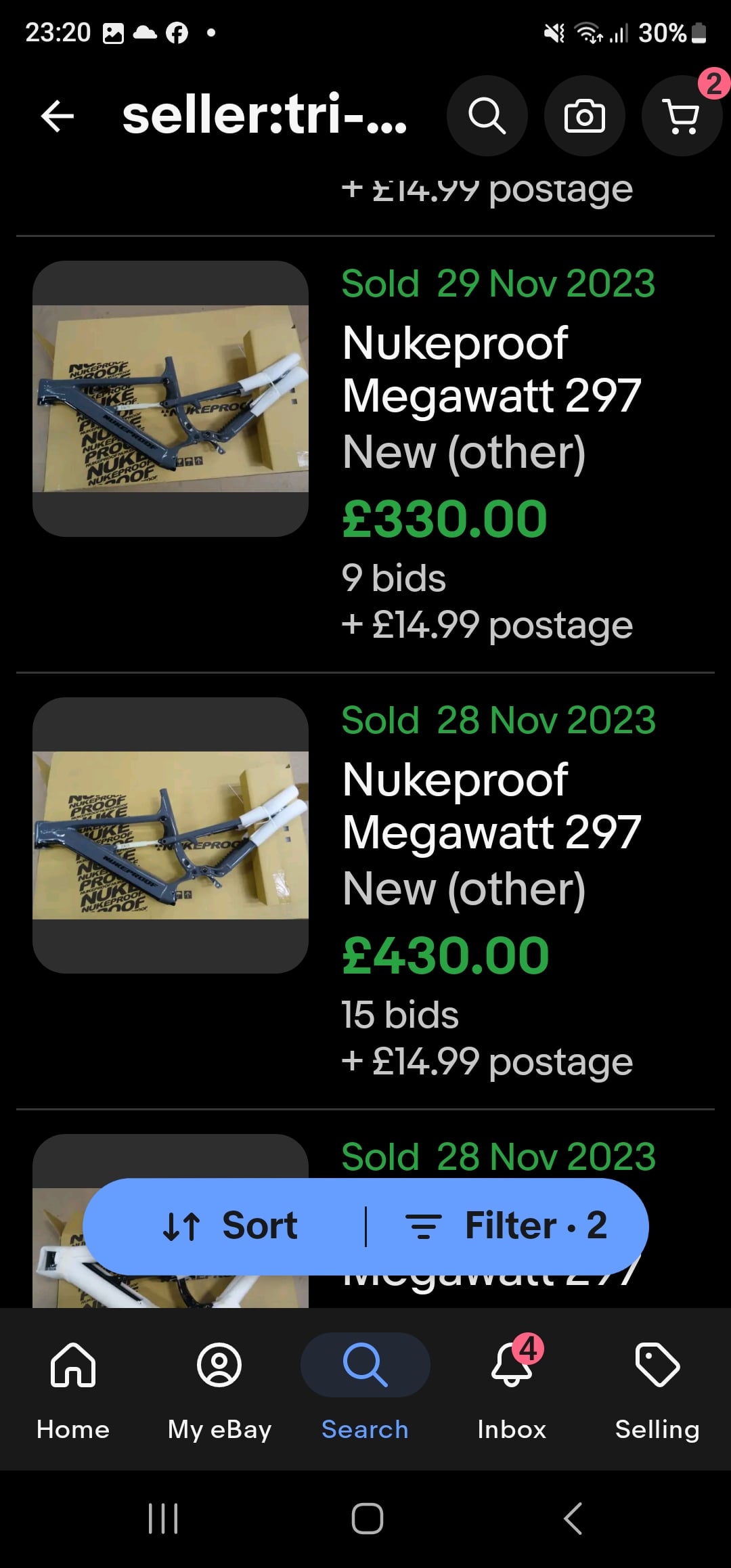

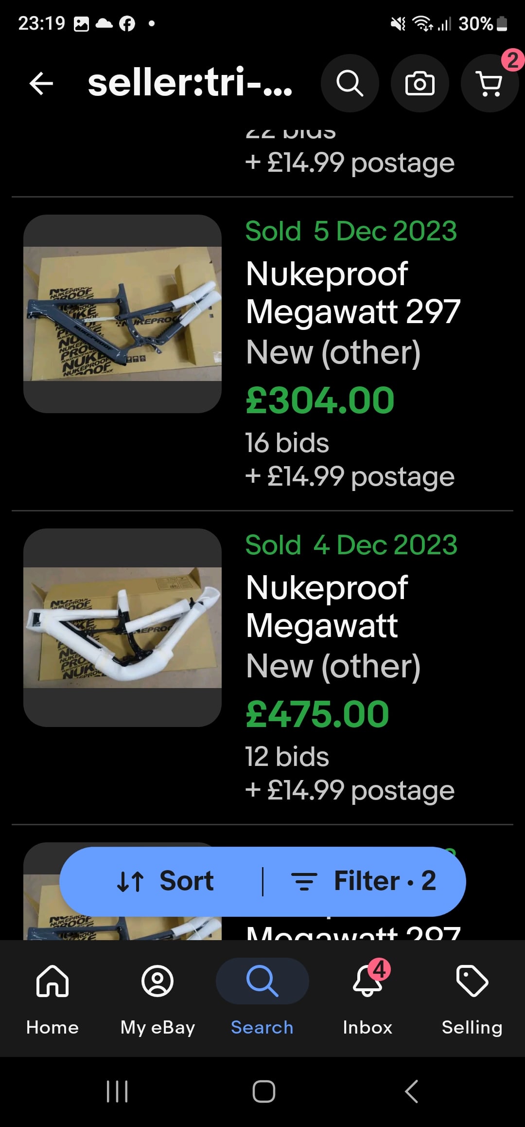

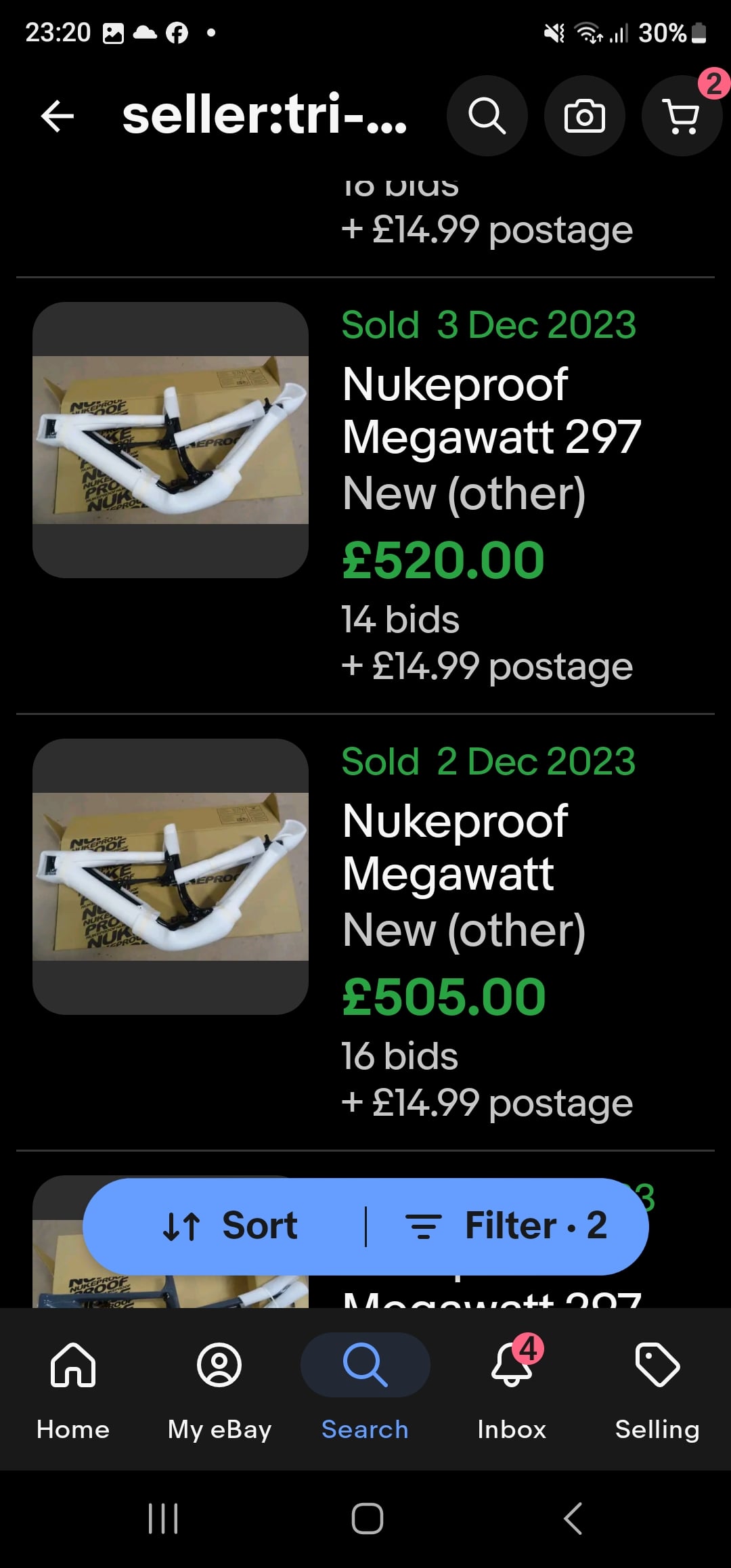

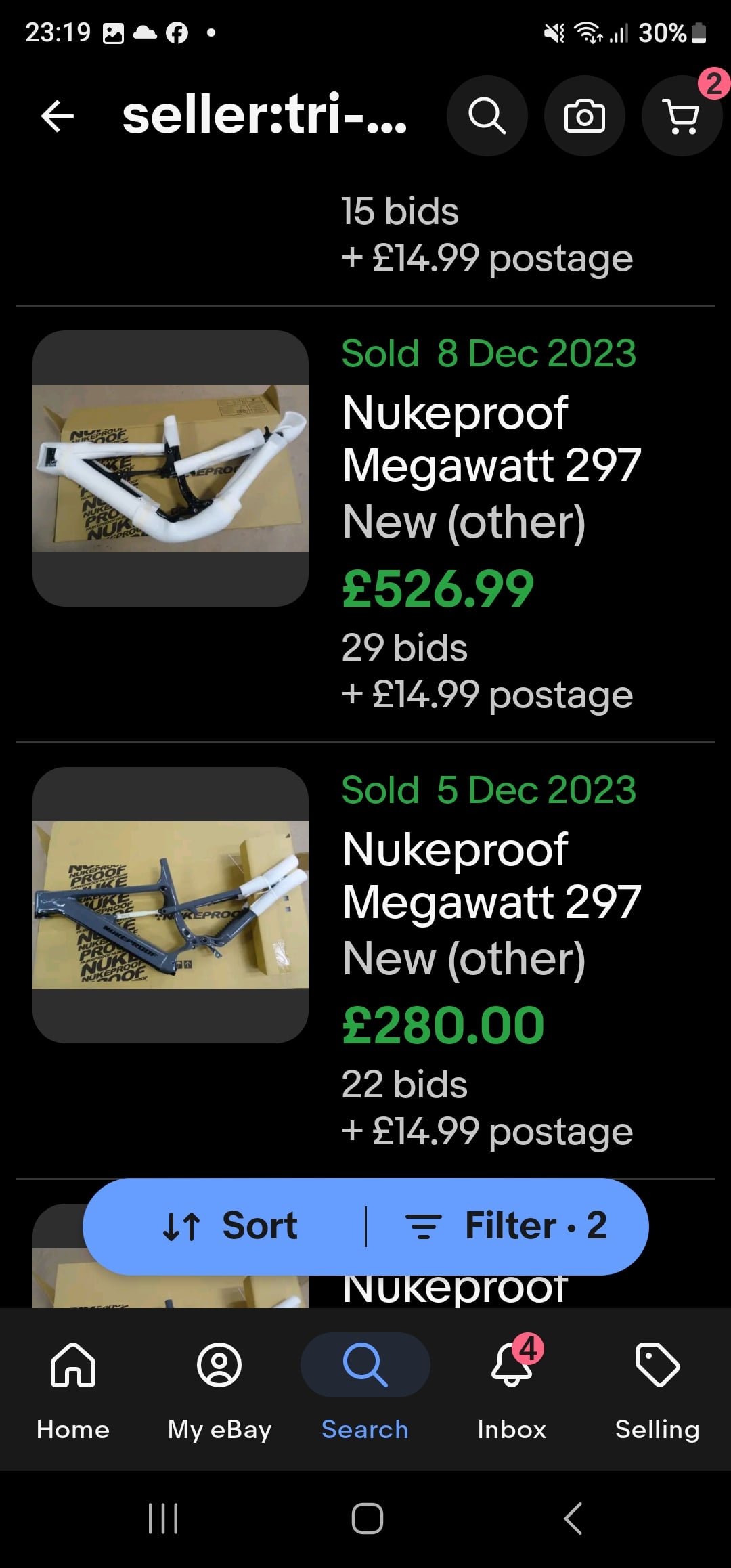

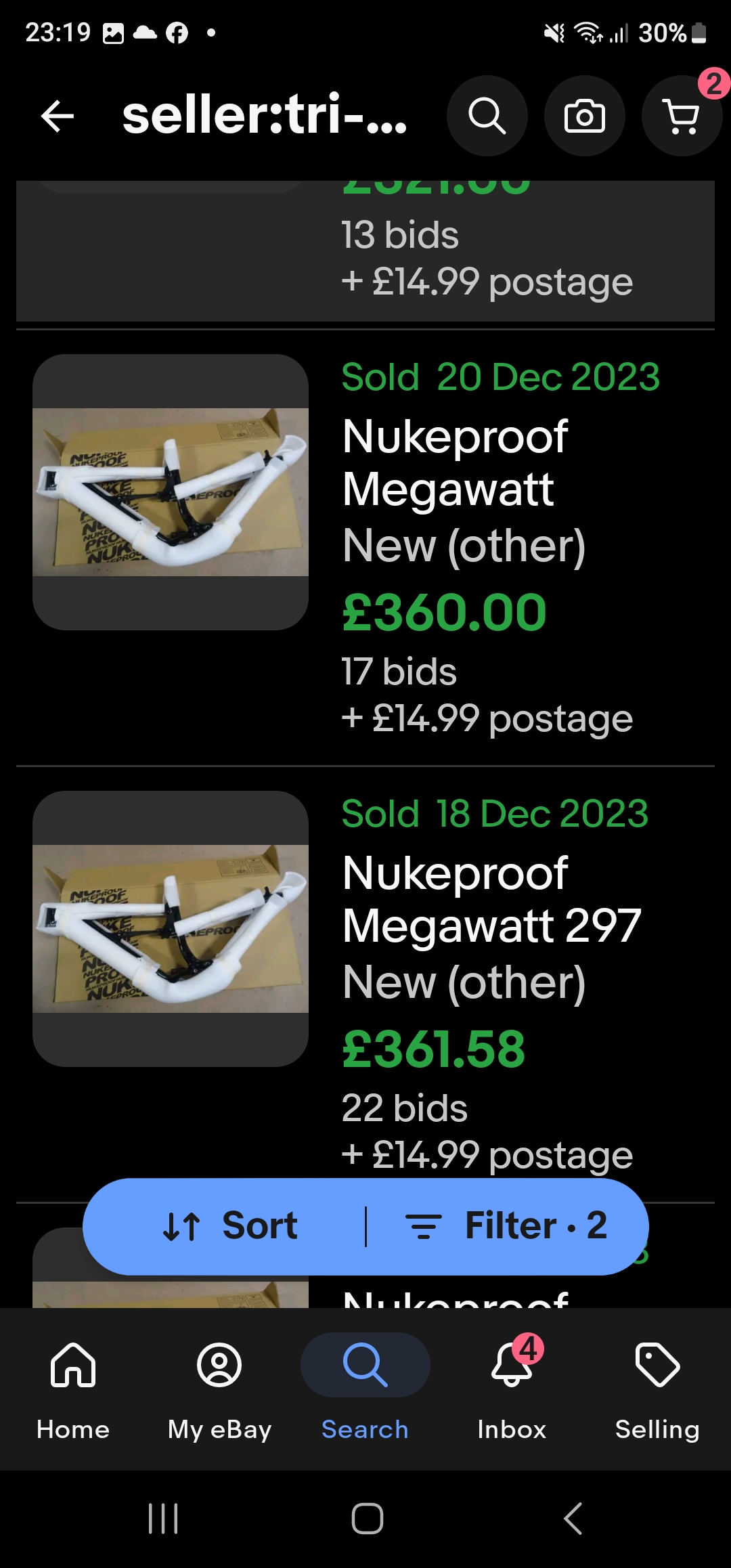

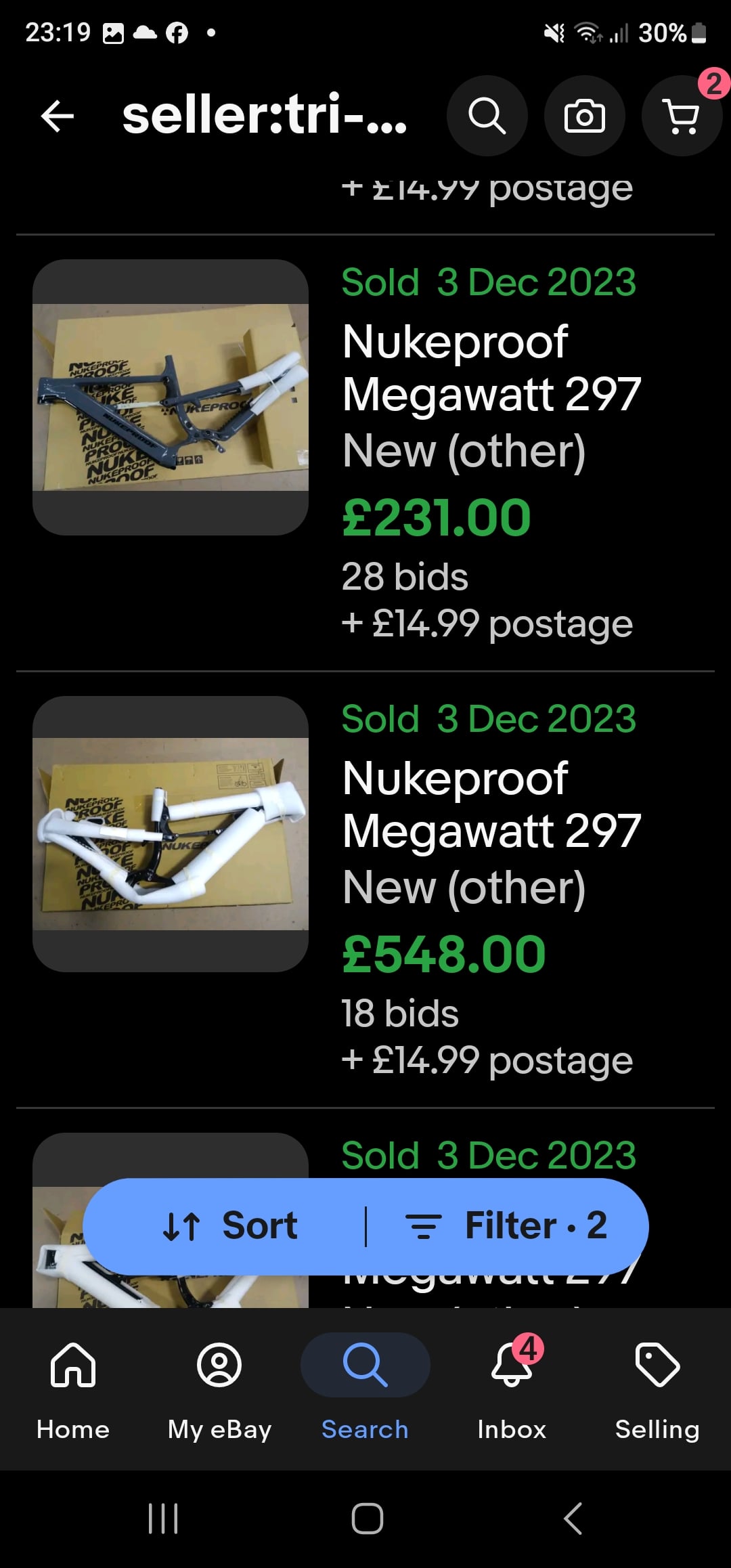

Take this Nukeproof Megawatt frameset which those who use ebay.uk may have spotted being sold by ebay seller:Tri-sport_resort (which is basically Wiggle, Wolverhampton).
This frameset (without the motor battery, shock, system etc) on average has sold for £300-£500 between November 2023 - January 2024.
Say what you will about the reason why this frameset became available. But it cannot be denied that when the opportunity presented itself, people bought the frame.

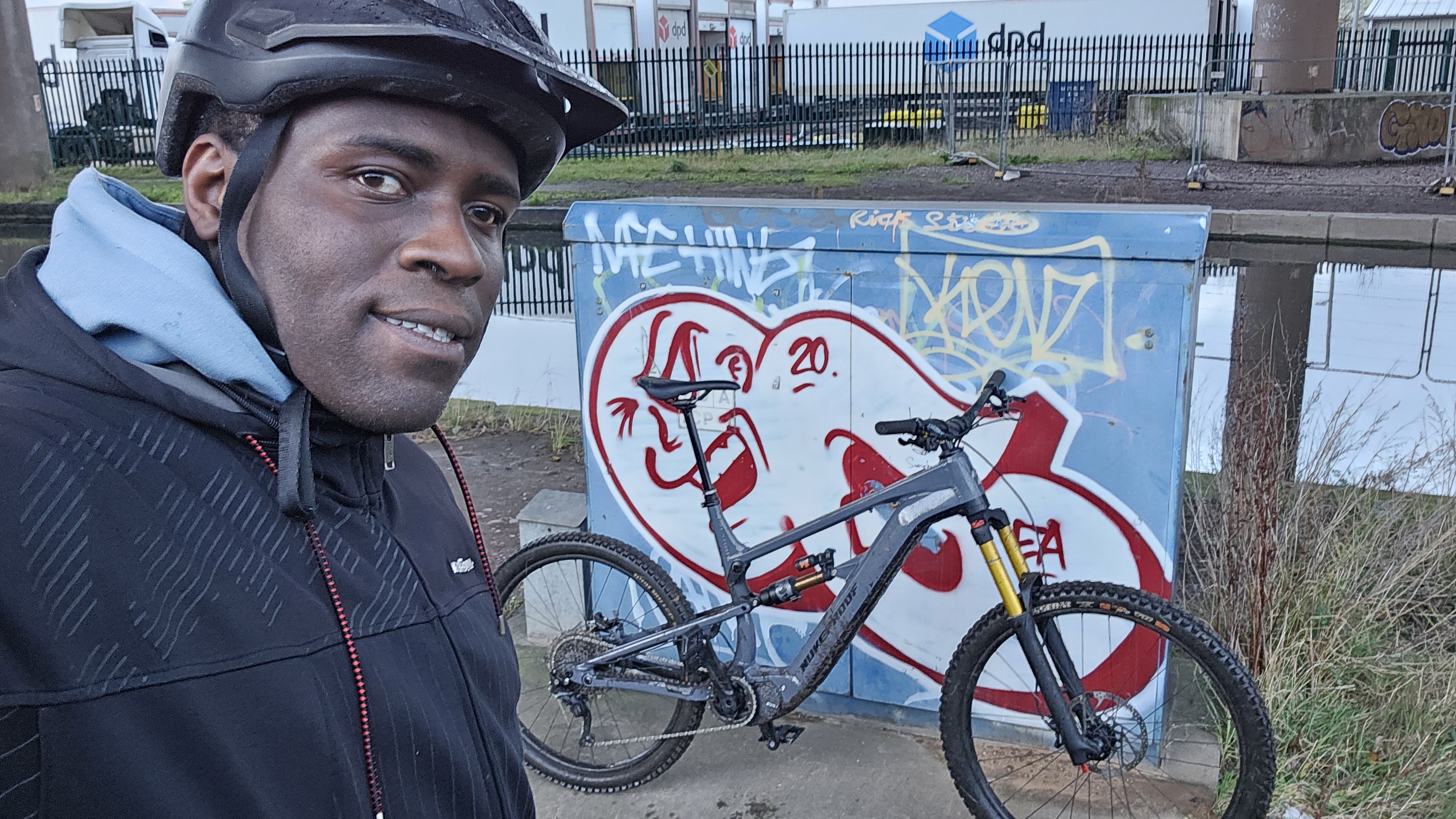

And even I decided to pick one up.

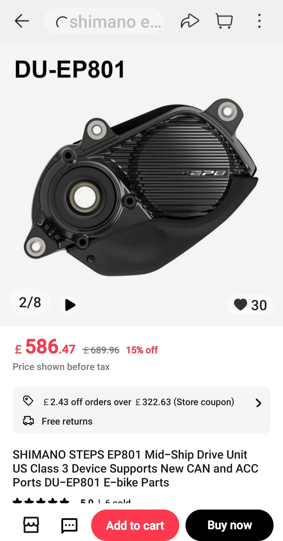

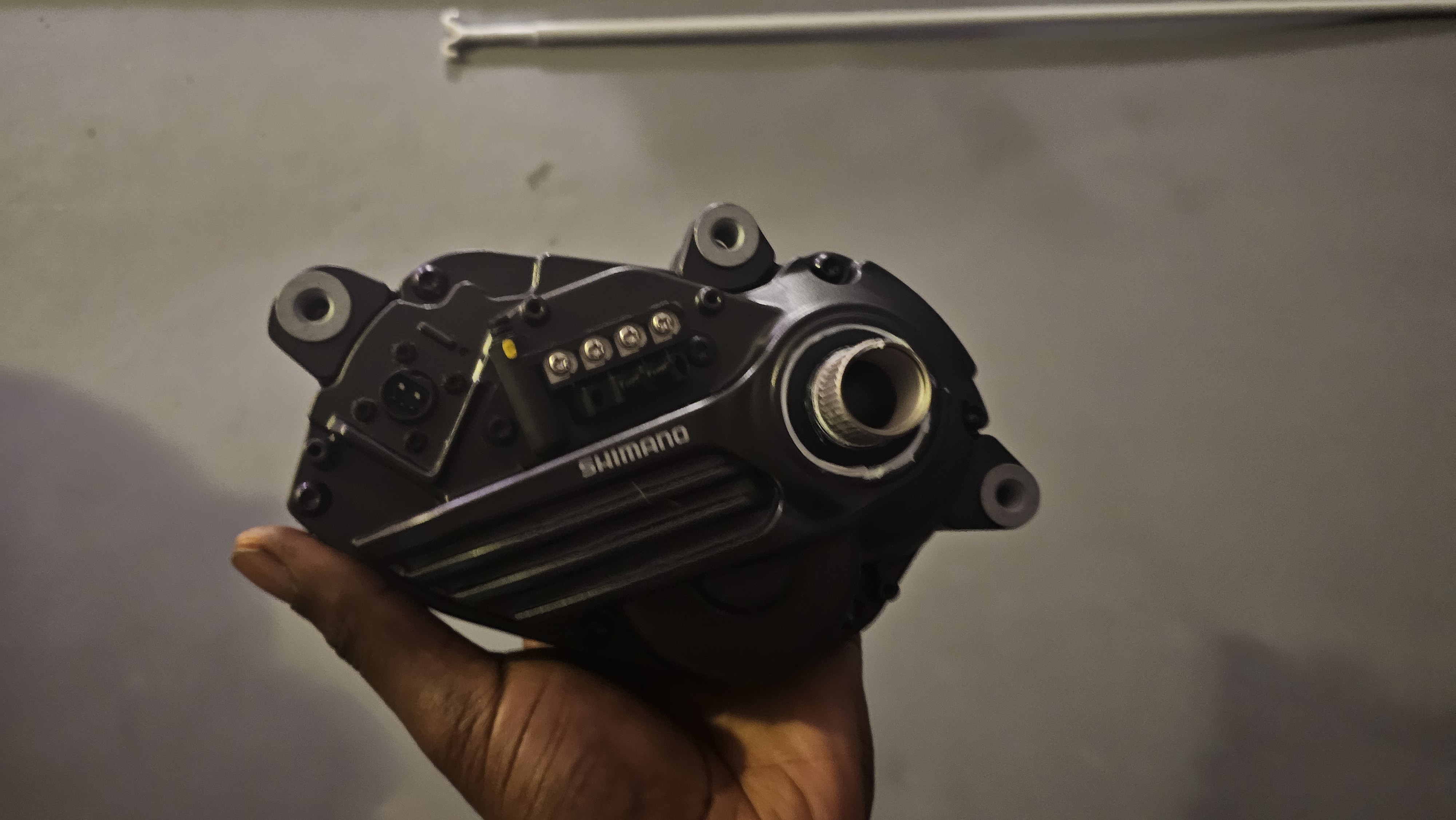

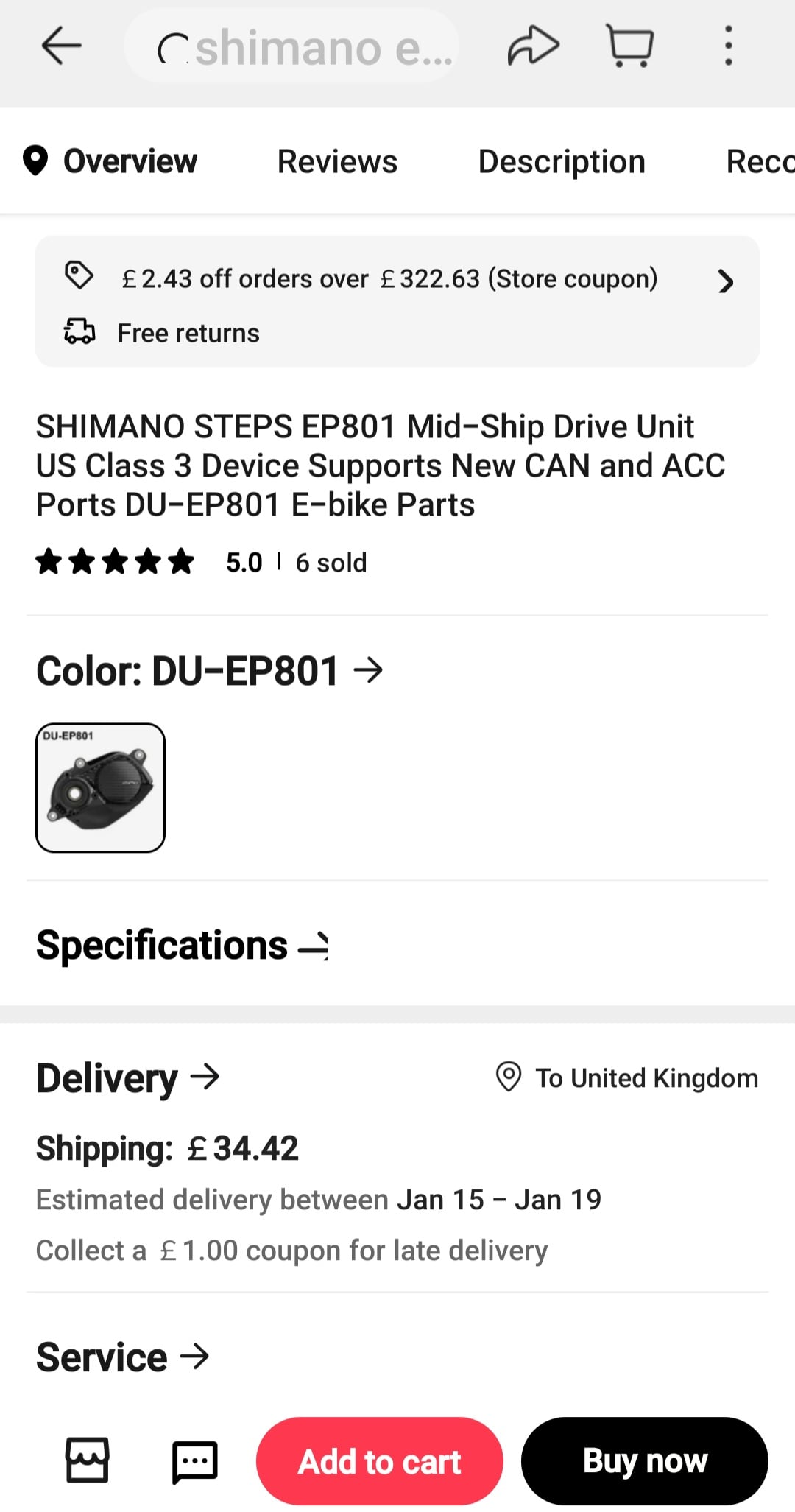

And sourced the necessary components and system to complete the build.

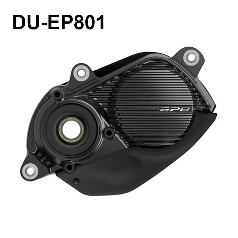

The EP801 was sourced fairly easily and I note that others have followed the exact same route as myself WITHOUT COLABORATING WITH ONE ANOTHER.
Clearly demonstrating that their is a market for those who ARE GIVEN THE OPPORTUNITY.
£2679.56 to build from a frame only, using a combination of existing parts and some brand new. Whether you consider the price good value or expensive, is dependent on how you look at ebike ownership overall.

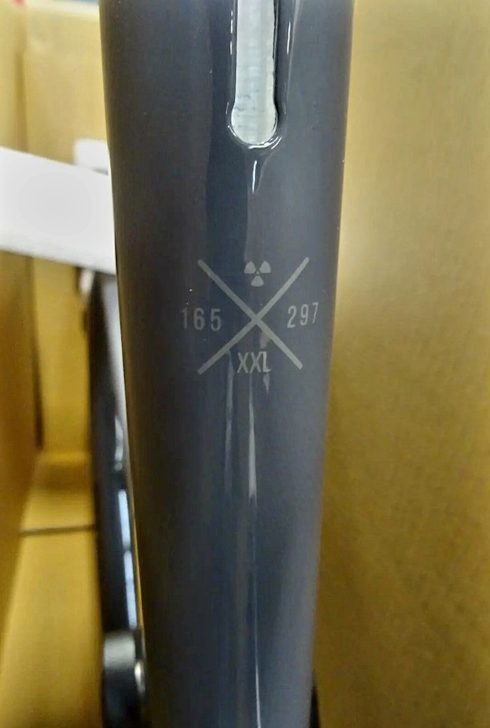

Although on a personal note, I don't typically stumble on many XXL frame sizes often in any of my local bike shops.
But like I said, I think the question needs to be asked AGAIN for the mainstream industry brands to FINALLY consider. I.e.
WHERE ARE THE FRAMESET EMTB OPTIONS?

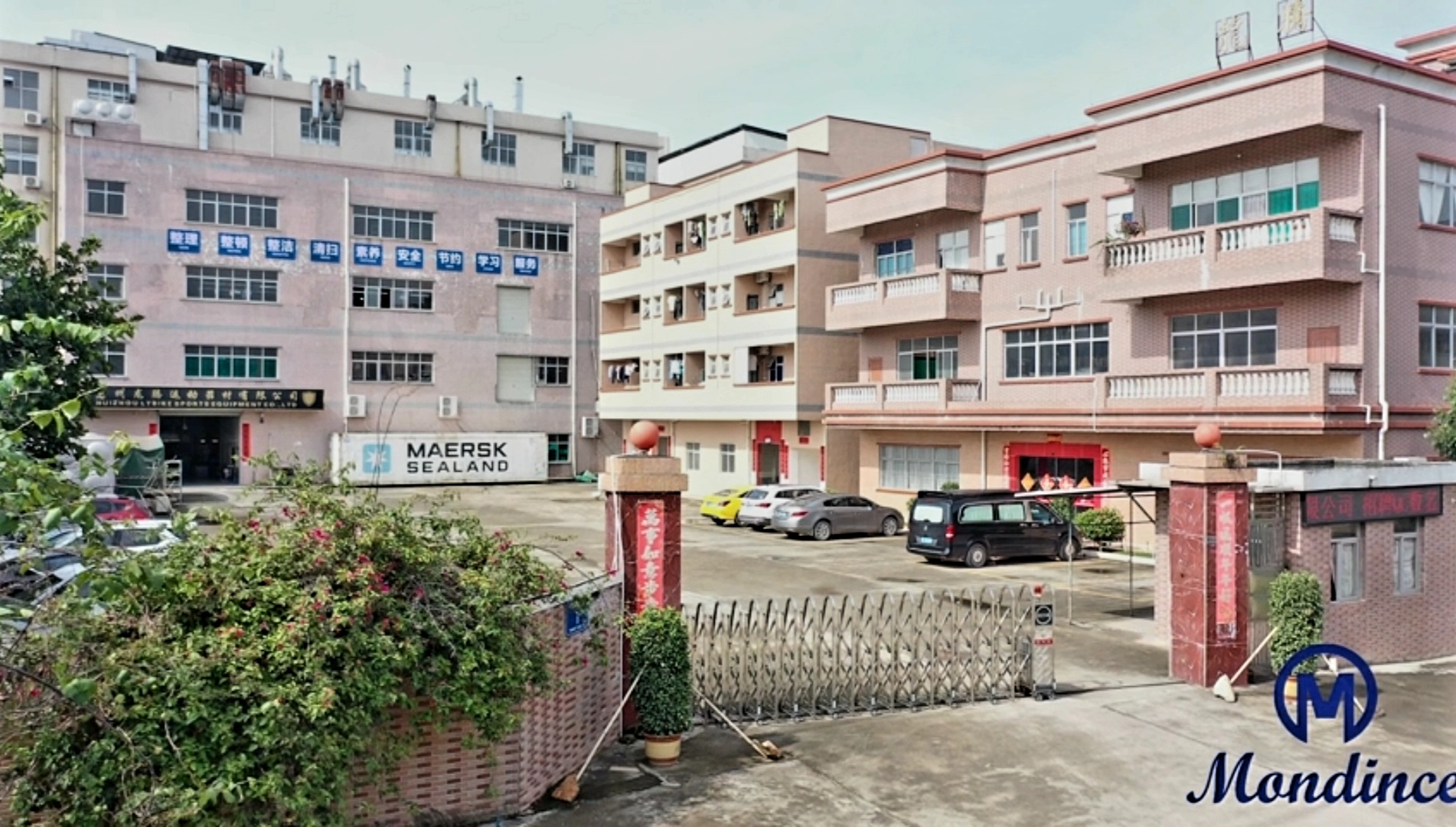

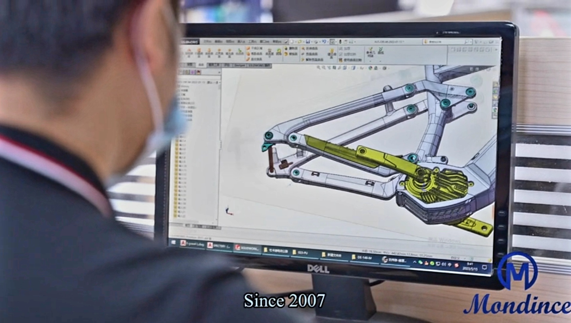

Gone are the days where the fabled arguments of 'geometry' & 'quality' could be used to sway opinions from frameset offerings from the east.

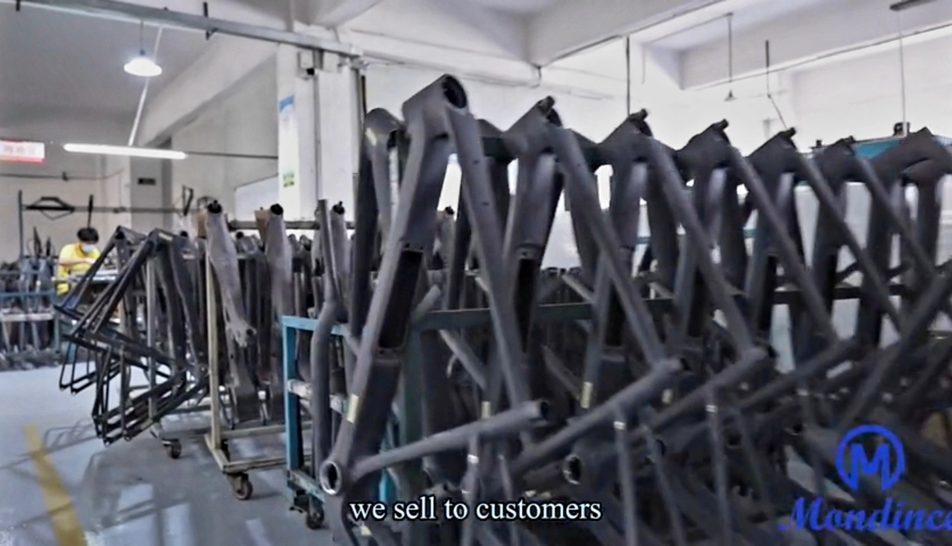

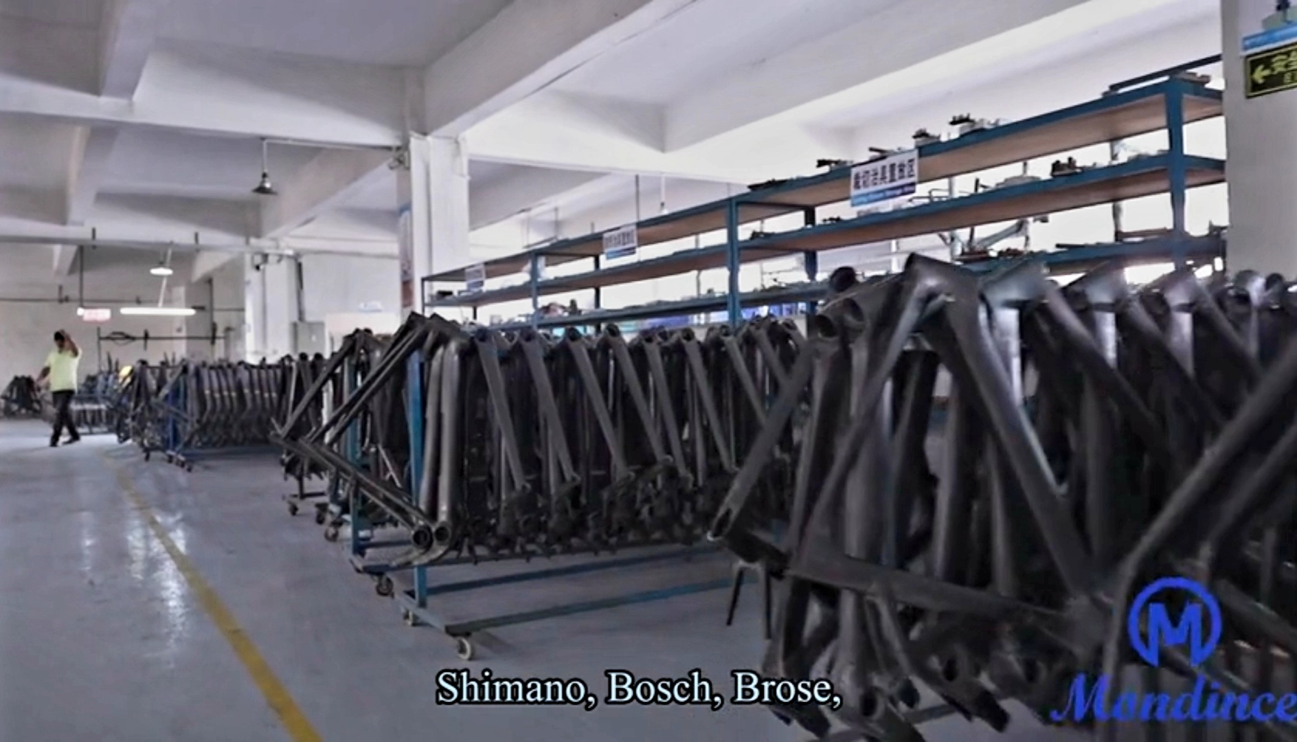

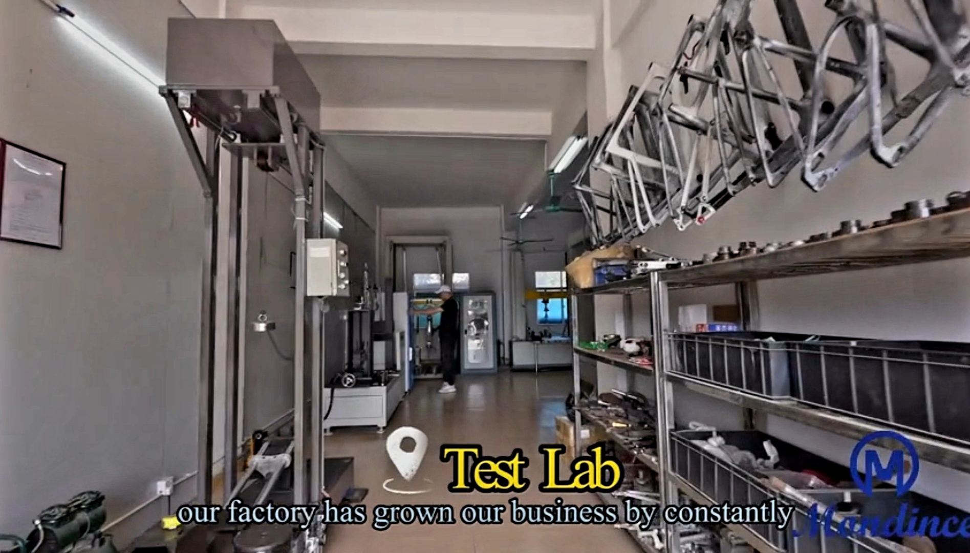

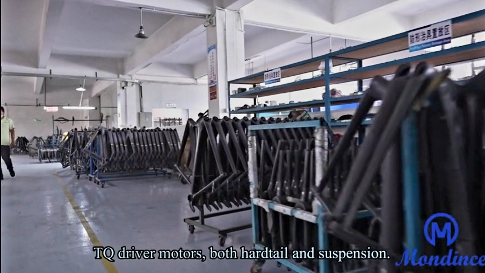

Because I'm sure many of you recognise that quite a few brands have their frames manufactured in the east.

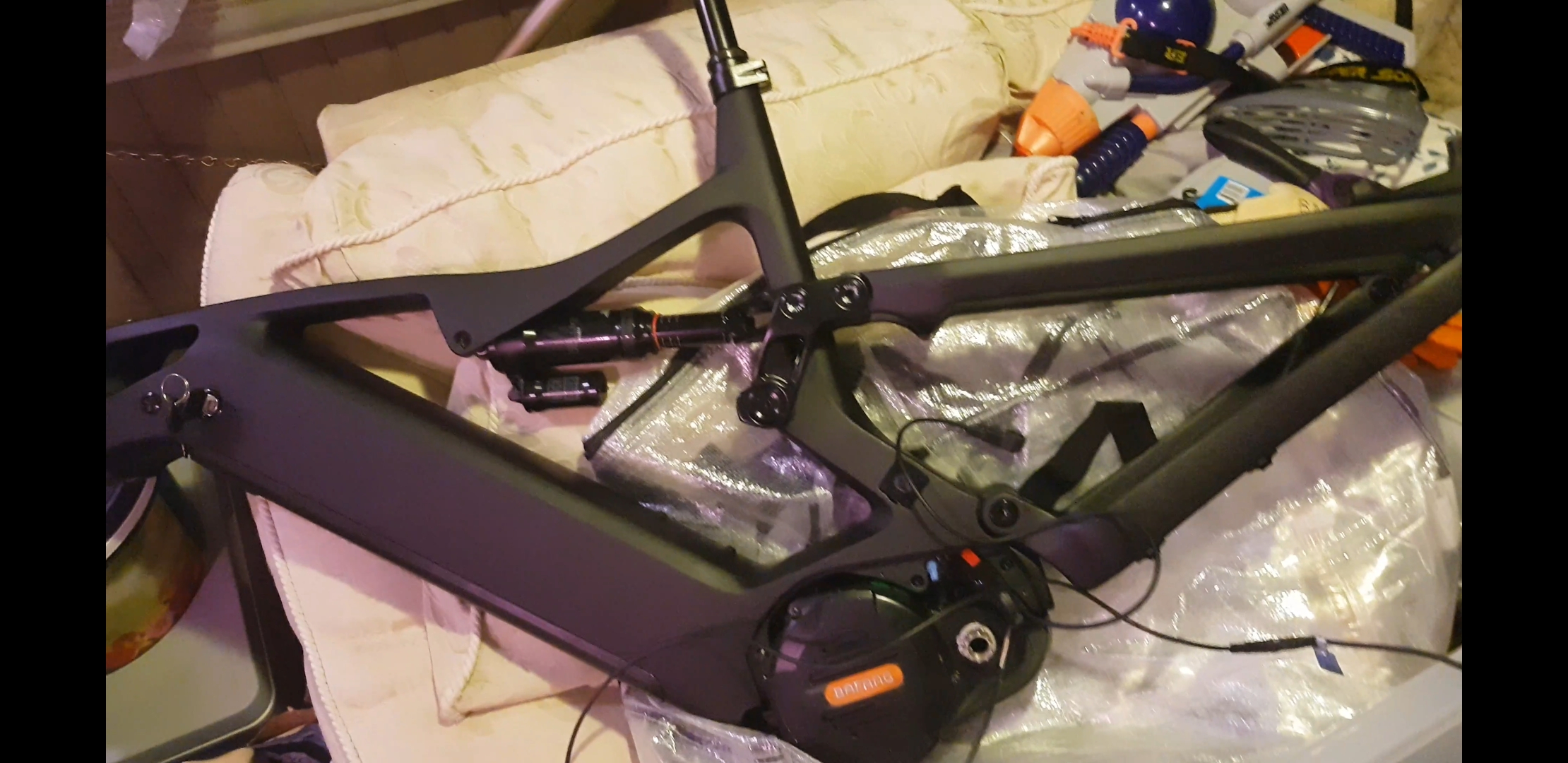

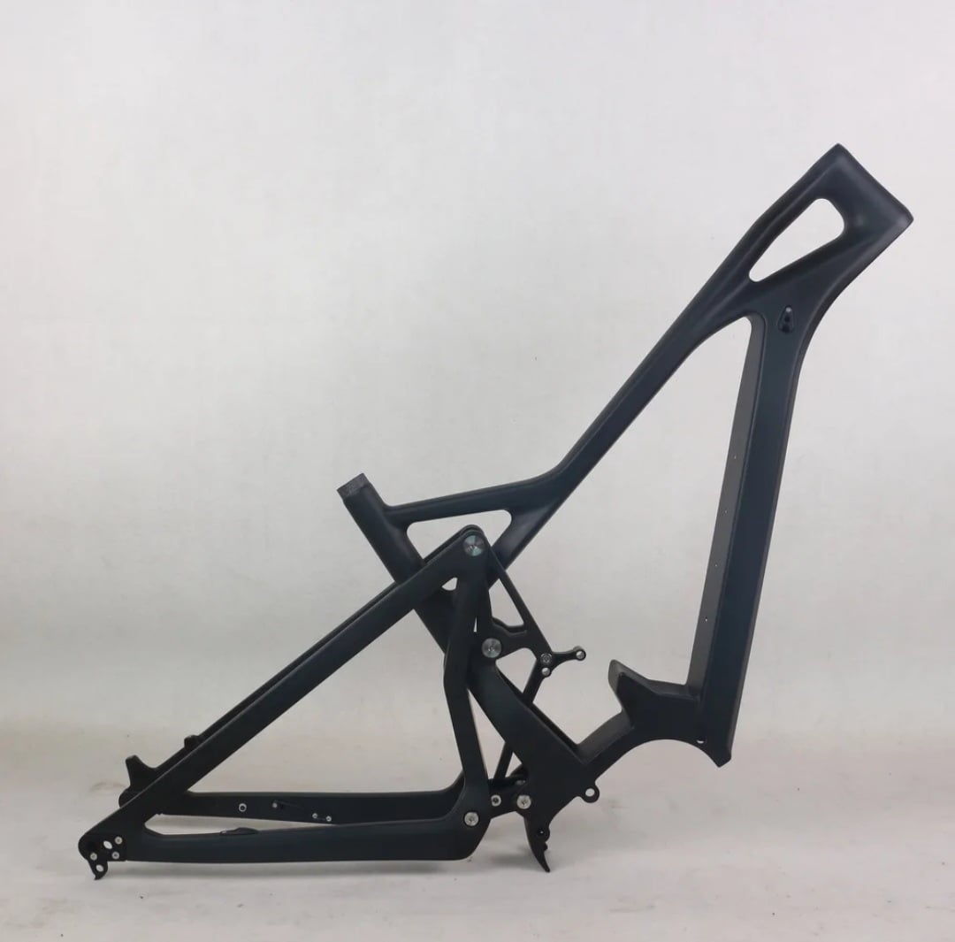

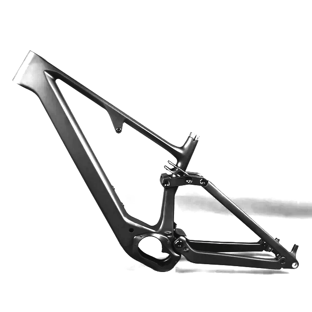

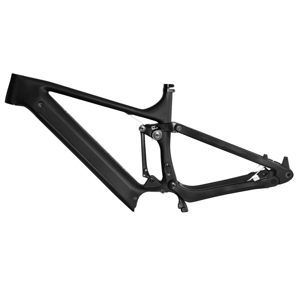

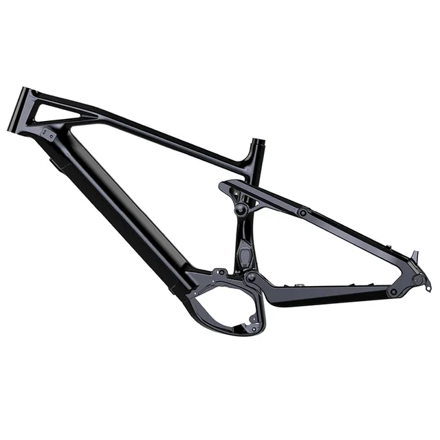

Some of whom, even sharing the same manufacturering facilities. And these frames are quickly proving themselves as being just as capable in terms of durability and quality.

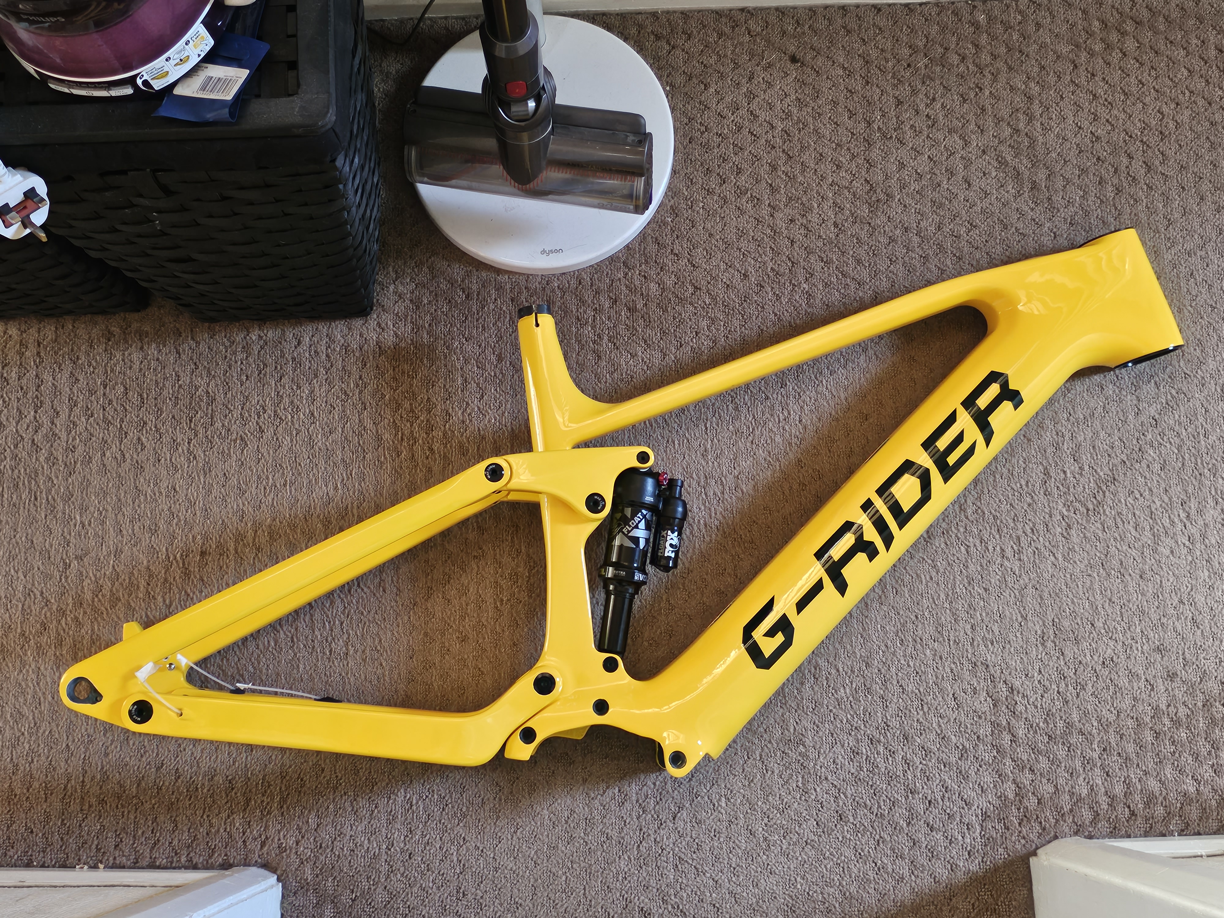

But I digress. The mainstream brands CANNOT AFFORD to overlook brands who do offer emtb frameset options. Otherwise,
They'll quickly find themselves competing and contending with brands from the East which they wouldn't have saw coming. And some of these brands are using motor systems like Shimano, Brose, Yamaha, TQ, Bosch etc.
Food for thought!!
Their is a market for emtb framesets.

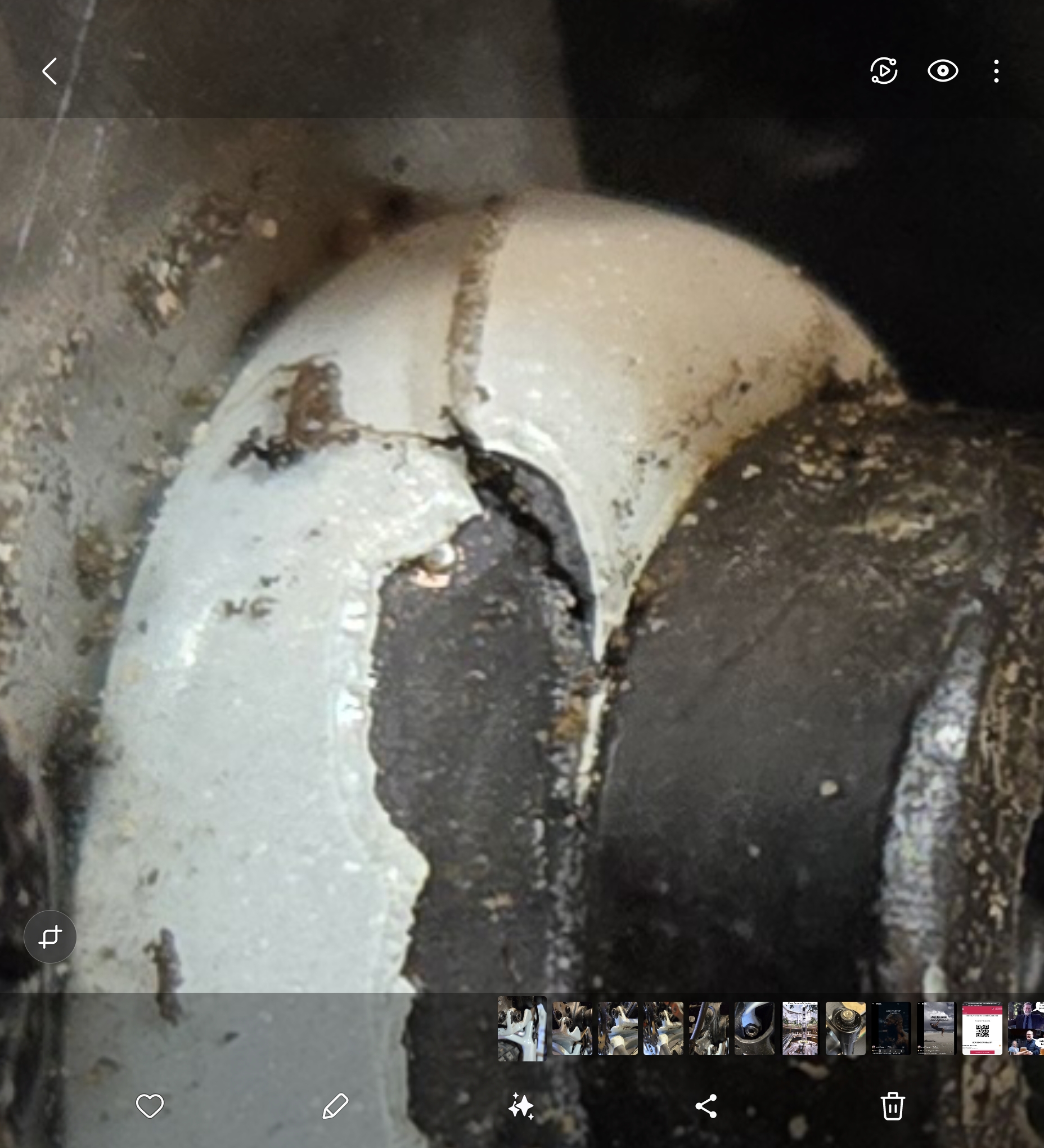

This doesn't sound good, what's happened to the Cube?
It turns out there's a major defect in the cube carbon frames. One of the motor mount points is made from extremely thin carbon fibre and the threaded insert is barely held in. These have been failing and cube have been refusing warranty claims saying it's either 'wear and tear' or damage has been caused by misuse.
The cube emtb Facebook group has quite a number of people now reporting this issue.
It didn't help either that cube specified 20nm as the torque value for these bolts when it is actually 11nm (20 is for aluminium framed bikes, not CF).

I've seen the comments and wondered if this was the case for you, sorry to hear of your trouble 😔
Has yours completely failed?
I was checking the motor bolts on mine a while back as I noticed a creak coming from somewhere, turns out it was a loose motor bolt.
Looking at the frame I did notice the carbon around the bolt holes looks a bit substandard, I said to myself at the time that it could easily be damaged if the bilt was over torqued.
I mentioned this on a post on the cube Facebook page, suggesting not to over torque these bolts, instead to use a lower torque value (12nm) and to use thread lock, I was shut down by most saying the correct torque is 20nm.
I've secured mine to 12nm with thread lock and I'm going to keep a close eye on them, it's worrying as I can see how easily the frame can fail at these points if the bolts come loose, cube should be stepping up here, don't go down without a fight.

I've not checked mine yet but I did torque them to that value. I was just testing the water to see what options are available.
You were shot down as one of the admins reached out to cube themselves to get the official word on the torque value, which they told us was 20nm. If that's what the manufacturer says, who are we to argue?
It turns out that figure came from Bosch and it was the value for the bolt of that particular tensile steel, nothing at all to do with what material it was being secured into!
@Doomanic I did pay half on 0% credit card, that's a good shout and if there is any damage I'll be sure to get them involved.
I've just lost faith with that frame though, the mount is so poorly constructed it's not fit for purpose.

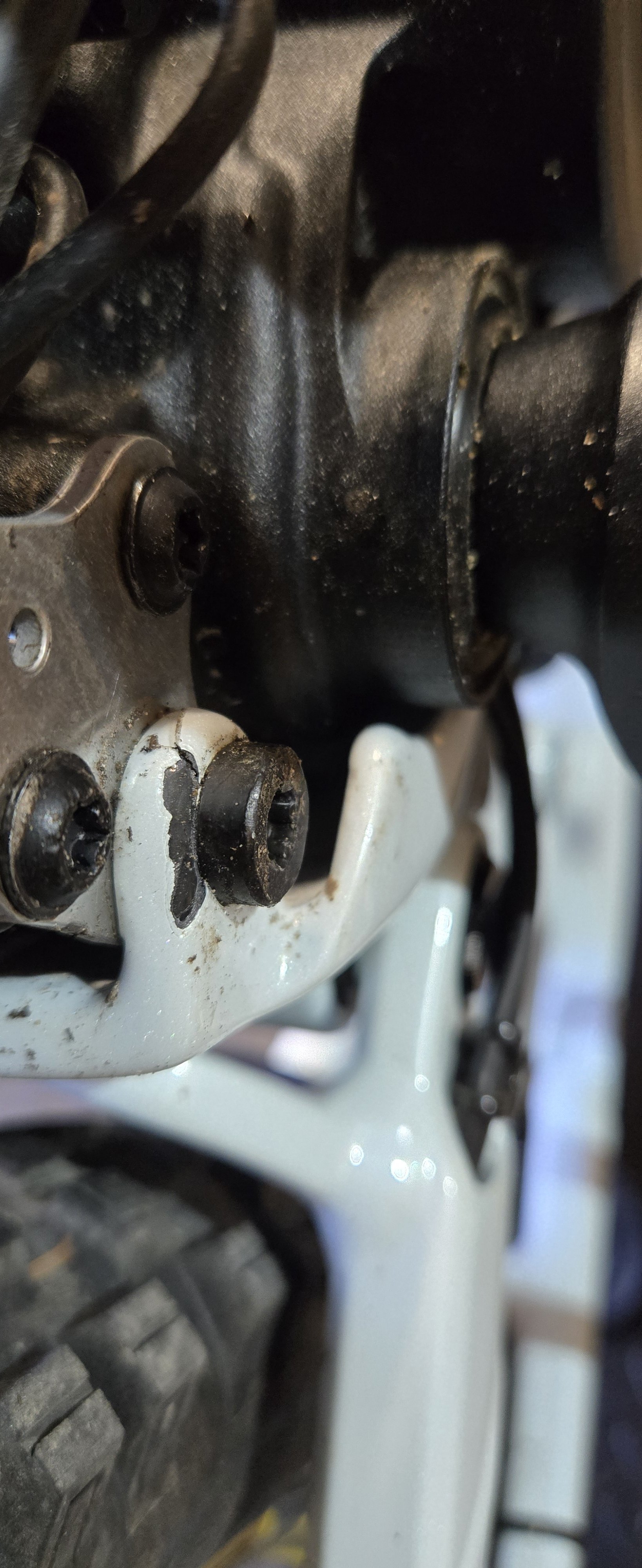

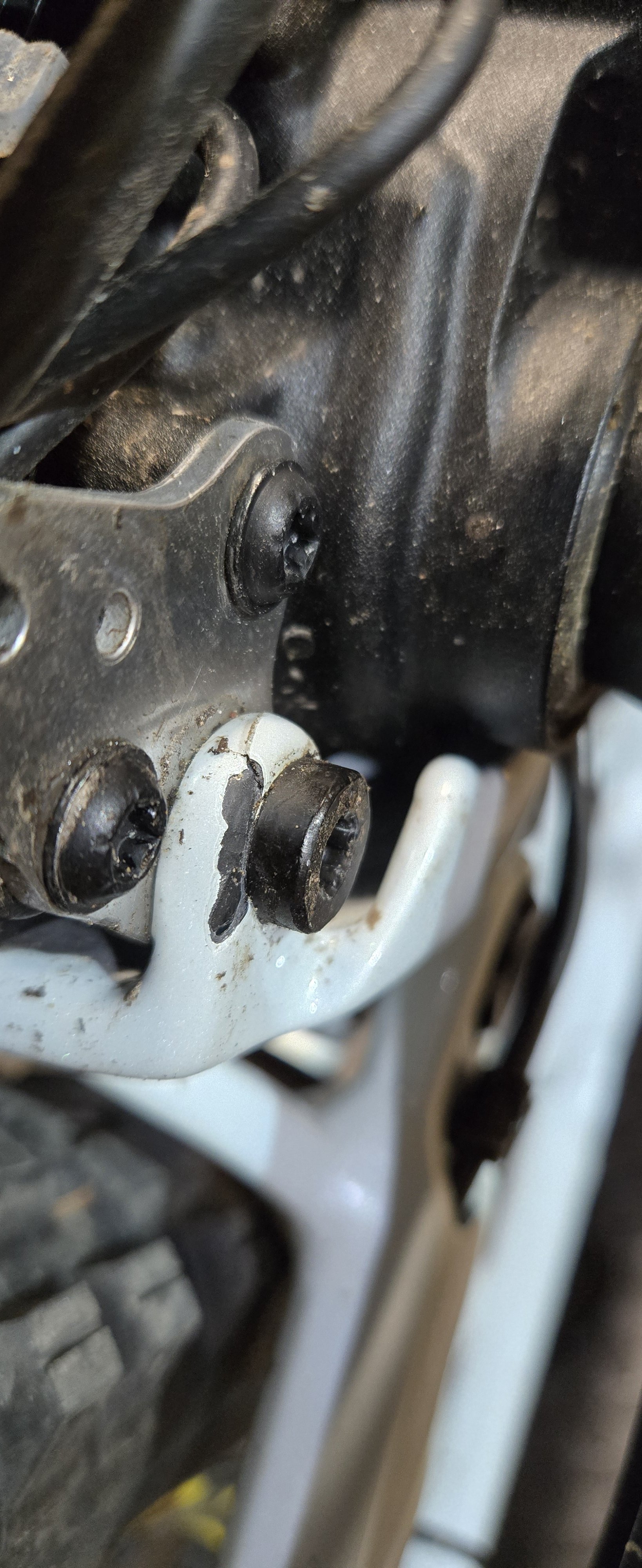

One of my inserts fell out. This was after the bike shop I was using gave me the wrong figure for torquing the motor mount screws. I was assured it was 40Nm. I wish I had of given that figure more consideration……..
When I fitted my motor I got to just past 30Nm and I stopped. It just didn’t feel right and I knew I must have done some damage.
When I next took the motor out one of the inserts came loose. Also, the inserts are just aluminium and pretty soft.
Anyway, I just glued it back in and carried on.
If you are unlucky enough to have this happen to you then VM100 glue from Materials, equipment and training for advanced composites with next-day shipping and expert technical advice. - Easy Composites is what you want. I bought a 50ml tube (loads more than I needed) along with the Cartridge Gun and nozzles.
Thread with photos here - 2021 Cube 140 Action Team Bosch motor mount torque setting

I was fortunate and found torque values of 12nm and 22nm for carbon and alloy respectively before securing mine, though it seemed strange to me as all cube 160 hybrid frames are carbon, so why list a value for alloy at all? Unless, like you say it's a generic value from Bosch for the gen 4 motor.
I totally agree that the mounting holes look a bit under engineered, but they should be adequate as the frame gets its strength and rigidity from anchoring to the motor.
The issue seem to come when one or a number of bolts work loose, this causes the motor to twist in the frame, which in
turn damages the carbon and inserts.
The other issue I've read is over torquing of the bolts, which results in the carbon being crushed around the insert.
When I was torquing to 12nm I feared to go any more as I could hear the carbon compressing at this value.
If It were me, I'd remove all of your motor bolts one by one and inspect the carbon and inserts, fingers crossed there is no damage.
Clean the bolts and inserts thoroughly with brake cleaner or acetone and reinstall the bolts with a good quality medium strength liquid thread lock, torquing to 12nm.
I'd then put witness marks on all bolts as a quick visual check, while also checking them frequently with a torque wrench to ensure they are not working loose.
With all this said I currently have no concerns of the over all strength of the frame, if you're a lighter or average weight rider it should take some abuse, though time will tell on the motor mounts, hopefully with regular checks they will hold up.
Don't give up on the frame just yet though if yours is damaged, I have seen someone cut away their damaged motor mounts and replace them with an alloy bracket, it's another option if Cube are not playing ball.
I'd be really interested in how you get on, maybe it would be good to start a dedicated thread so as not to derail this one too much.

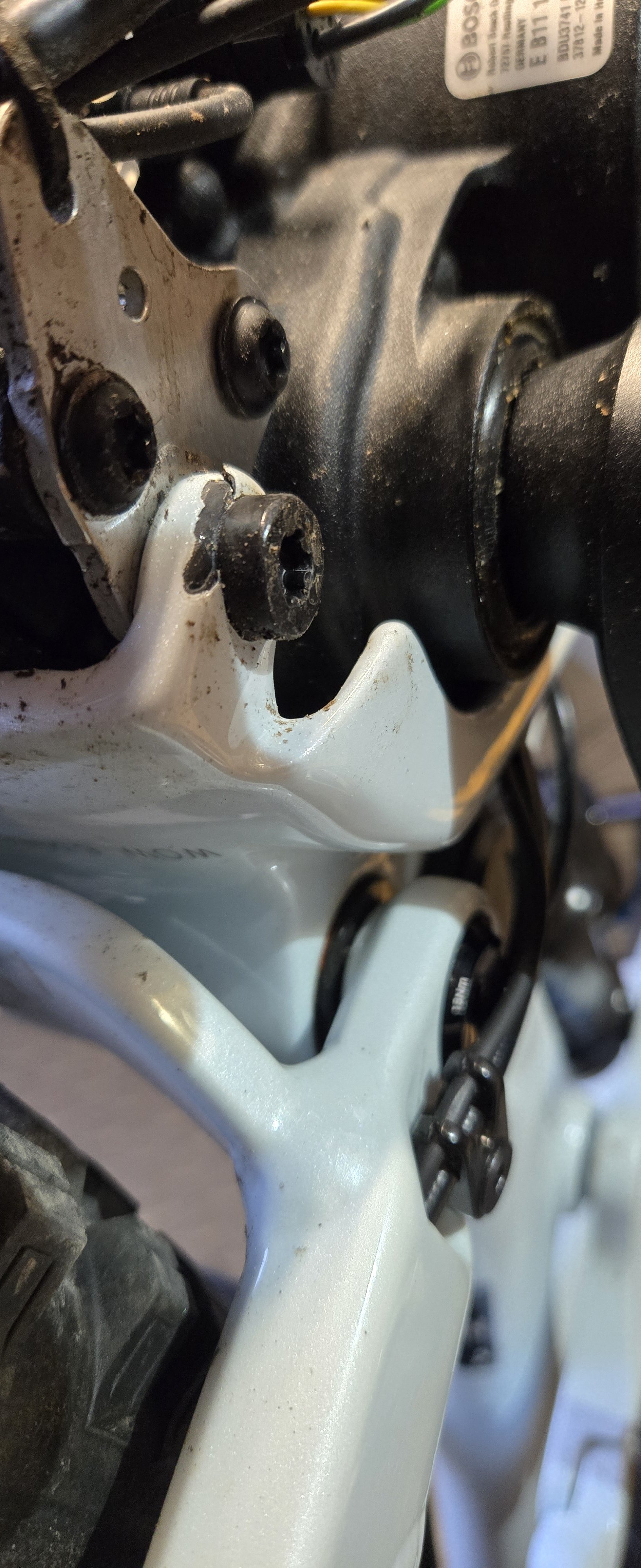

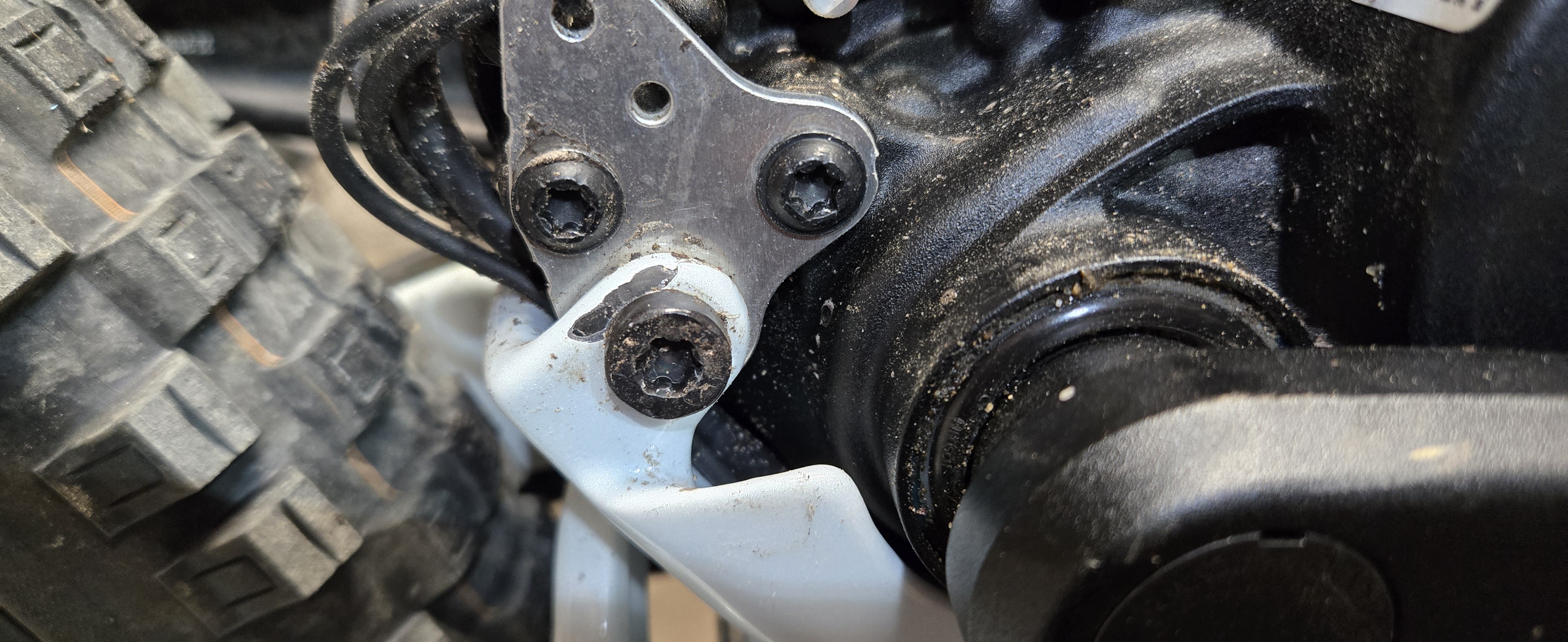

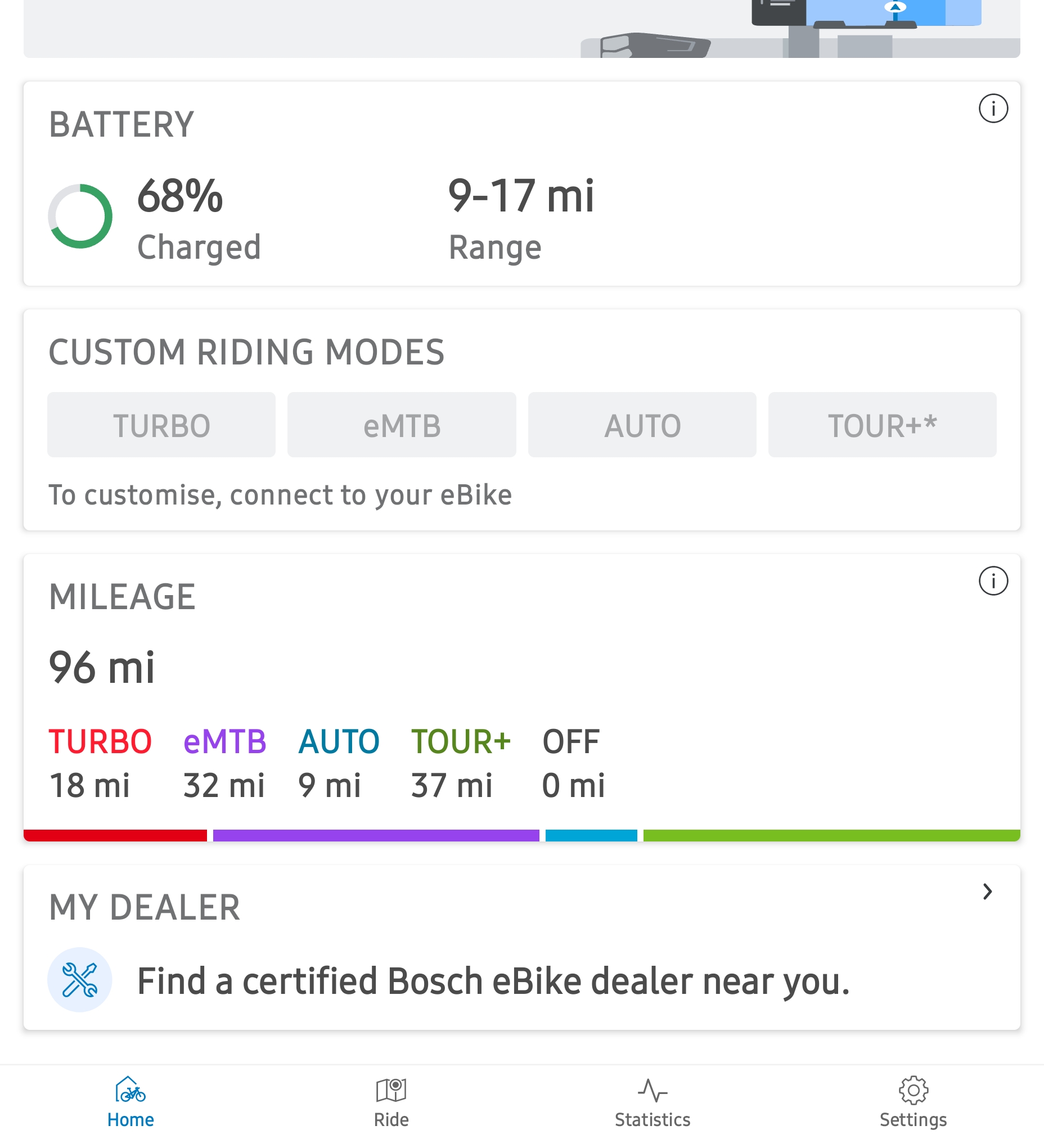

Hi, just found the threads on the cube motor mounts.
My stereo hybrid 140 pro 2024 is in the shop now after finding the rear carbon mounts have cracked, not all the way through but bad enough.
Rode the bike for 96 miles altogether before hearing a creak from the motor area.
I'm hoping this can be sorted through warranty but it's been nearly a month so far and cube just keep asking for photos and diagnostic reports from the motor for some reason.
I haven't rode it hard so I'm thinking it's over or under torqued bolts?
