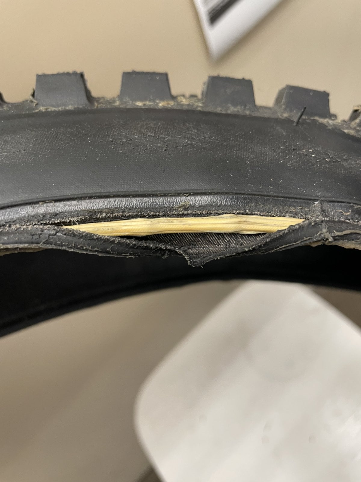

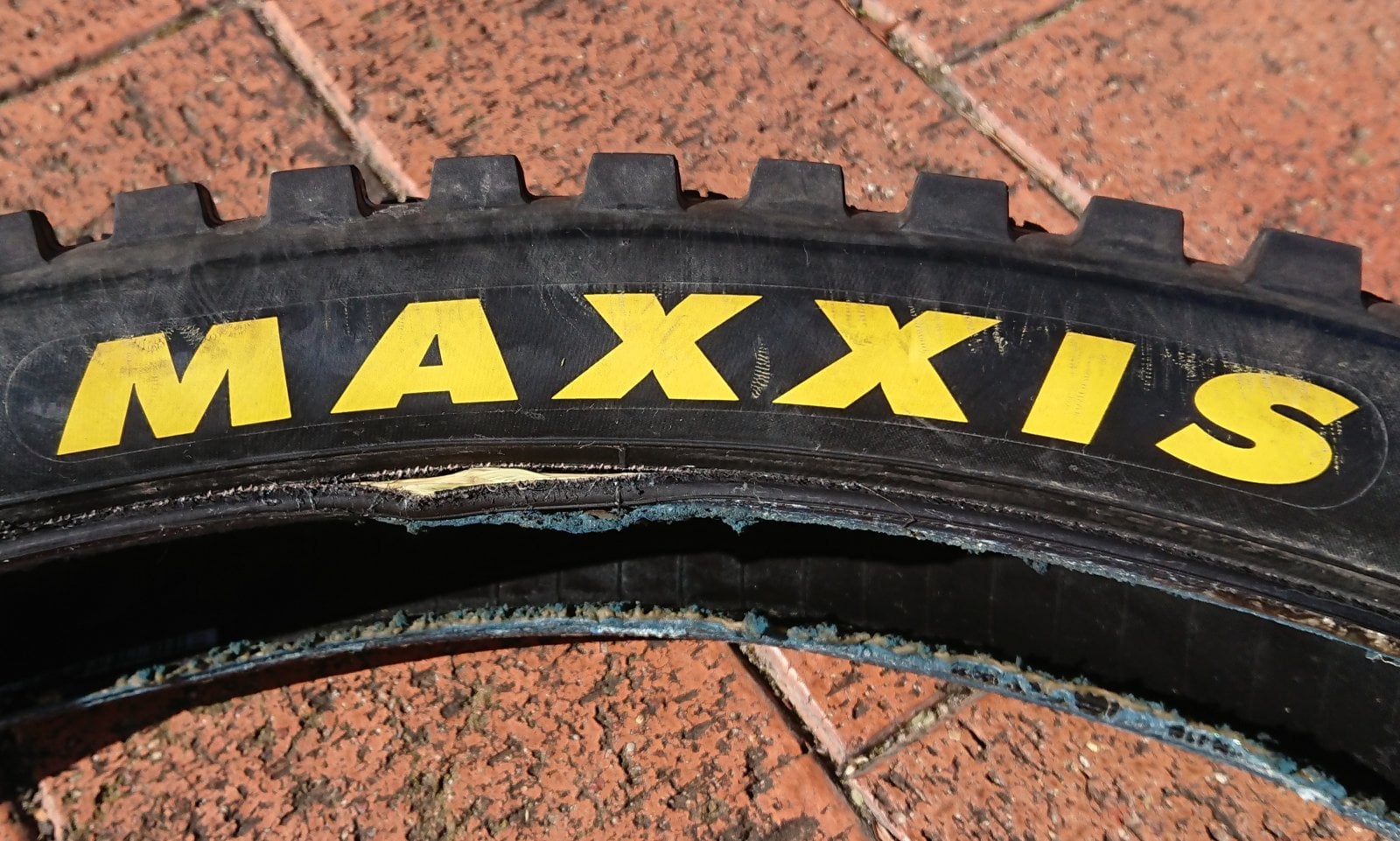

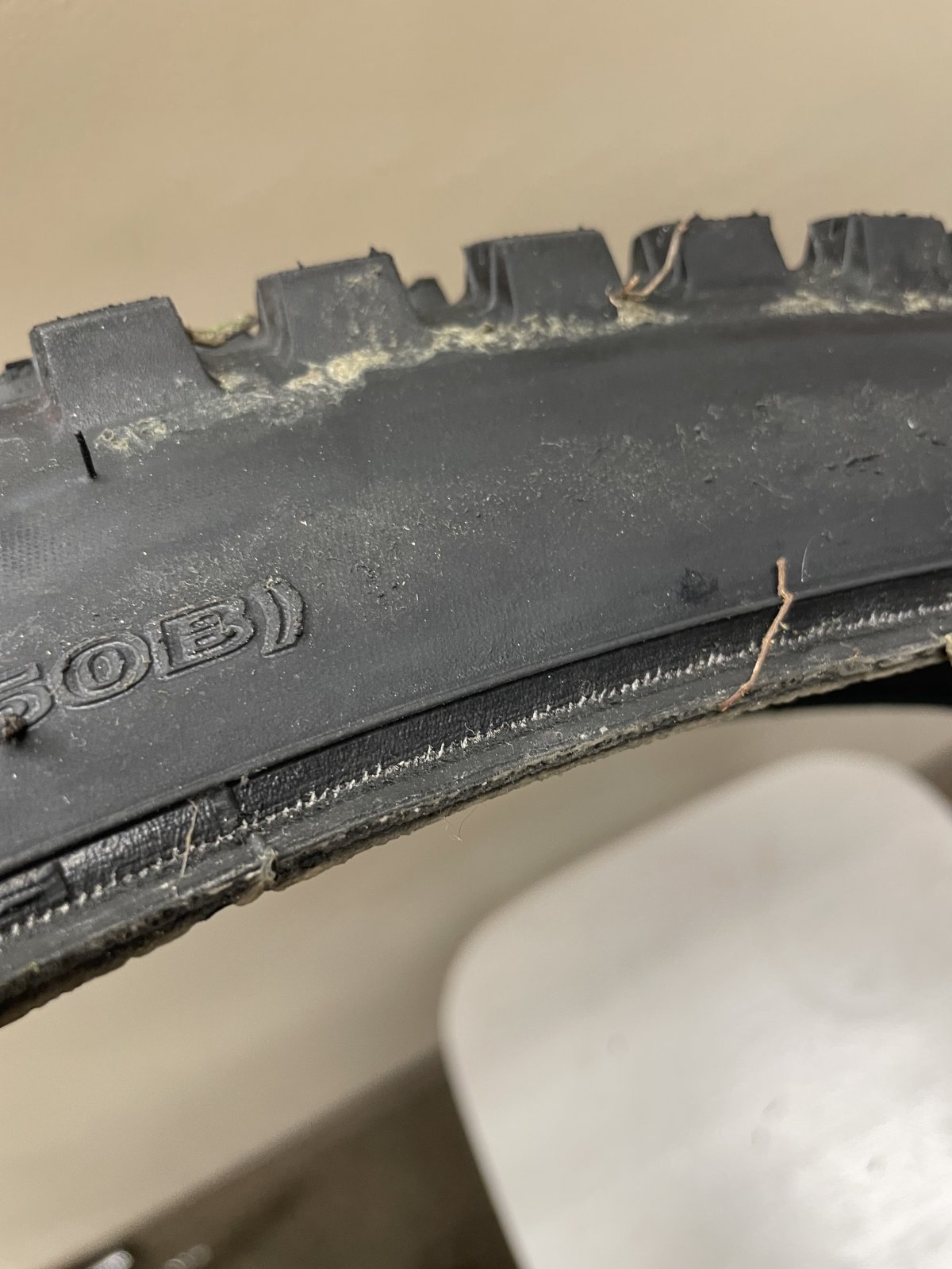

has anyone seen this on Maxxis DHR II 2.8 27.5 x 2.8 EXO tire 3C maxx terra
e13 Carbon Wheel , 27.5 DHR II , EXO, Maxx Terra 3C , 27.5 x 2.8 30-35PSI
Tire bead breaks, pops and in the second picture you can see the premature wear . looks like the rim is rubbing on the rubber and showing wear marks along whole tire.
No issues with the rim. LBC confirmed rim is fine.
Why??? Thoughts ?
This has happened 4 times now. the sidewall bead separates...
also if you look close, you can see the wear marks on the bead where the tire and rim must have movement.

I had something similar on one of my DHF tires I was running on the rear. I thought it might have something to do with the low tire pressure (20 PSI with Cushcore) I run. I ride a lot of rock slabs so I was thinking the tire was slipping on the rim under heavy braking but really have no idea. I built the area back up with some Shoe Goo. I am using DT Swiss 511 rims and your carbon rims are probably hookless so YMMV.

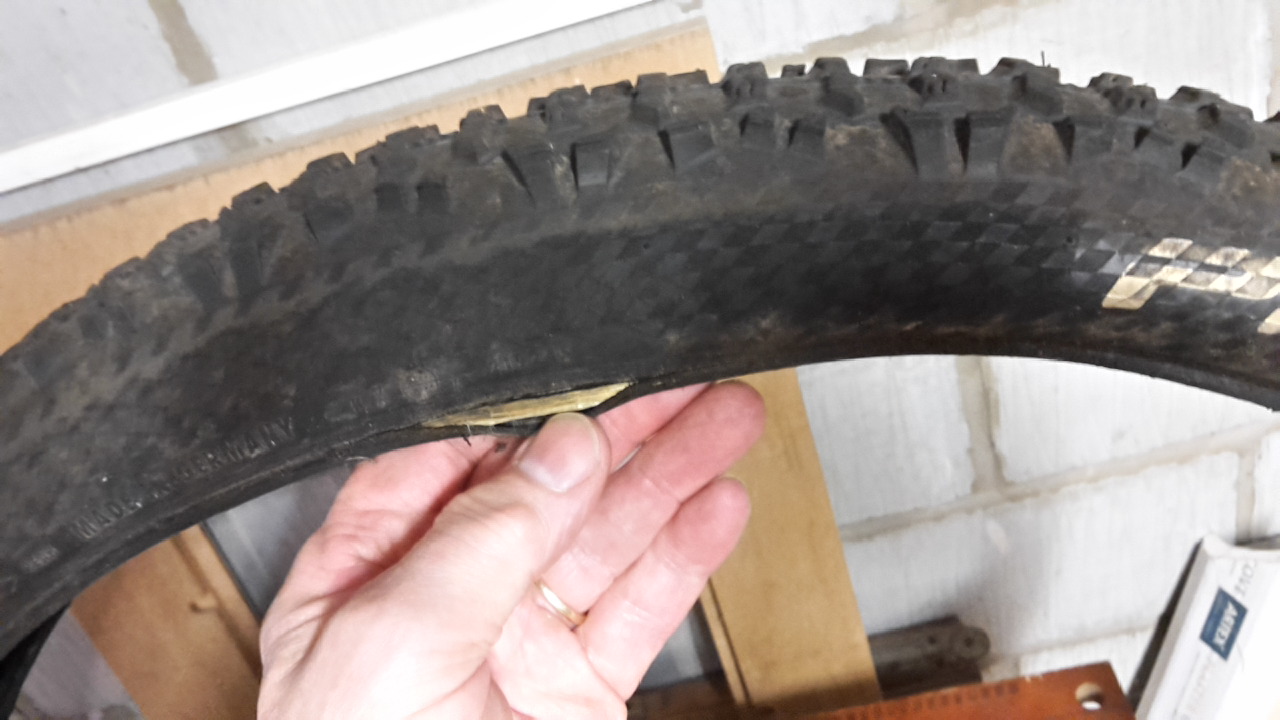

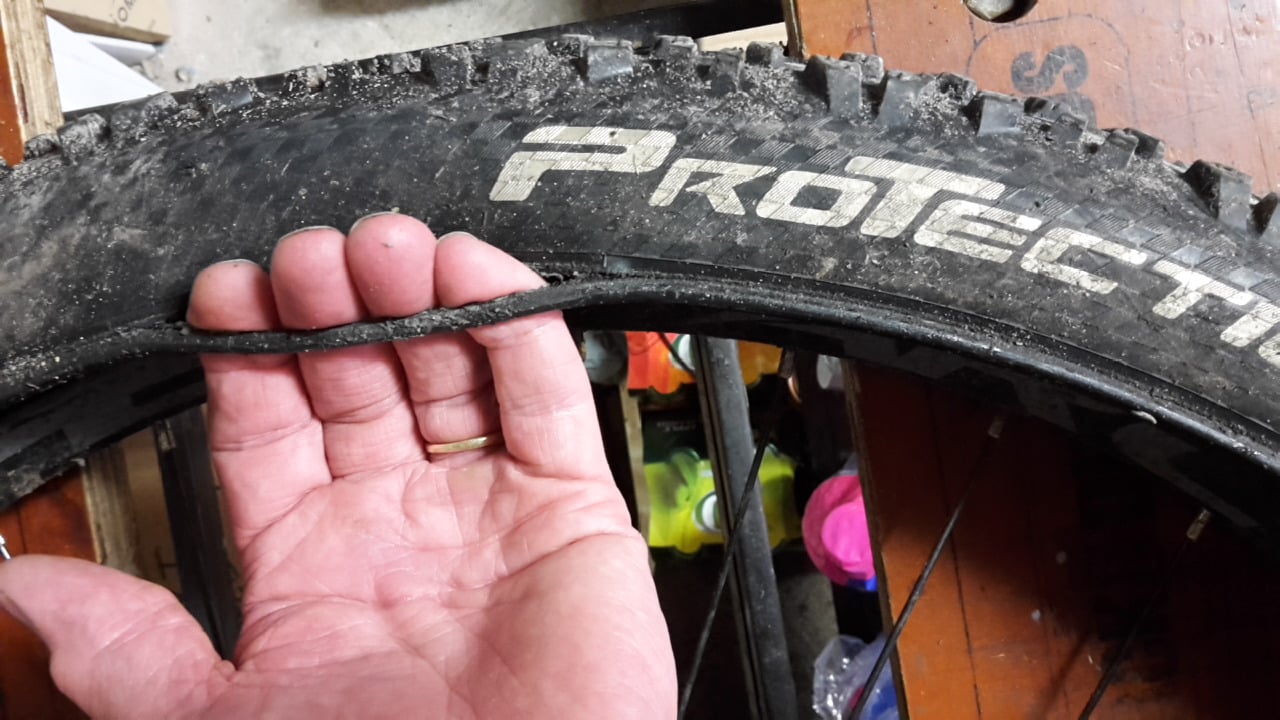

I had the same problem on some Continental Trail Kings. 27.5x2.2" on my mtb, run tubeless. It happened twice with successive tyres, both in the same place with respect to the Conti logo and at about the same miles travelled (ca. 700). See pics
On each occasion I had zero difficulty in claiming a manufacturing defect, but I didn't buy a third tyre.
Despite the success of my claim that it was a manufacturing defect, I am pretty sure it was my low tyre pressure that exploited a latent defect. If my pressures had been higher, I may not have had the problem.
