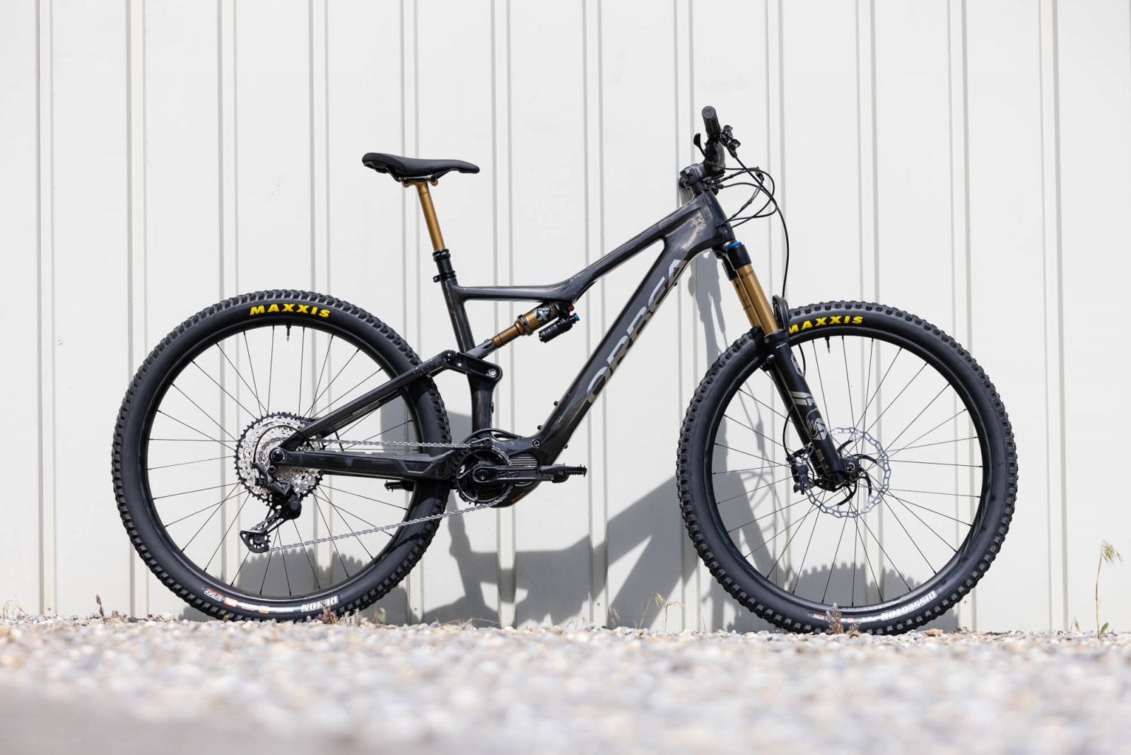

There are two things I notice on my new Orbea Rise M10. The "glue effect" when you go over the 25 km/h limit (Europe), which I'm really not sure if it's motor drag or just the expected feeling you get after the support stops (this is my first E-MTB), and at about that speed as well, I can feel an engagement gap, which creates an audible noise every time my input overcomes it (of course that doesn't feel nice either). Is this a normal thing on E-MTBs and if yes, can it be improved with a rear hub which has faster engagement, like the Hydra from i9?
PS: My new Rise:

it's not motor drag you're feeling when pedalling over the assistance threshold. it's just normal resistance (wind/tyres/terrain/gradient) and all of a sudden no longer having 250w helping you.
The motor basically has a freewheel in the crank/chainring interface so you now have engagement of the hub and chainring so that's why your Emtb feels as if it has a lower engagement hub. And Yes. a faster engagement rear hub will help.
