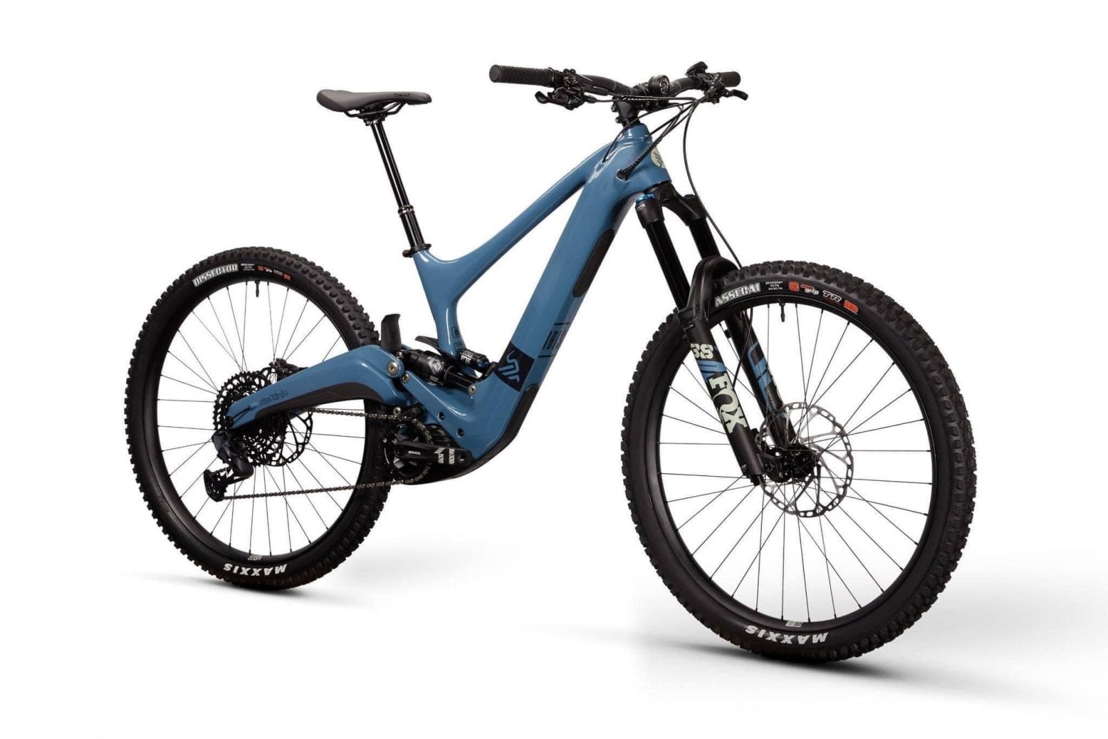

Photoshop is certainly possible, but the only bikes I know with a high swingarm like that (Siryon and Wolf Ridge) have a very different shape.

They have done away with it completely by abandoning their iconic logo and headtube badge. Really don't understand how they could do that.
i guess the focus is on cost savings. A printed logo is said to be significantly cheaper than a riveted headtube badge

Love it! Just the fact that your front chainring never can destroy your rear triangle like on a Trek Rail is pure love :) Them using Bosch over Shimano is also a big bonus.
Price - let's guess..... -One million space-bucks?

Shit, I really hoped Ibis first ebike would be a lightweight trail bike same as pivot SL in a eRipley flavour.
But it’s rather beefy enduro, heavy motor and questionable design… Not for me.
Well if it comes in at 49-50lbs with the Bosch motor and a 750wh battery I’d say that’s pretty damn good.
