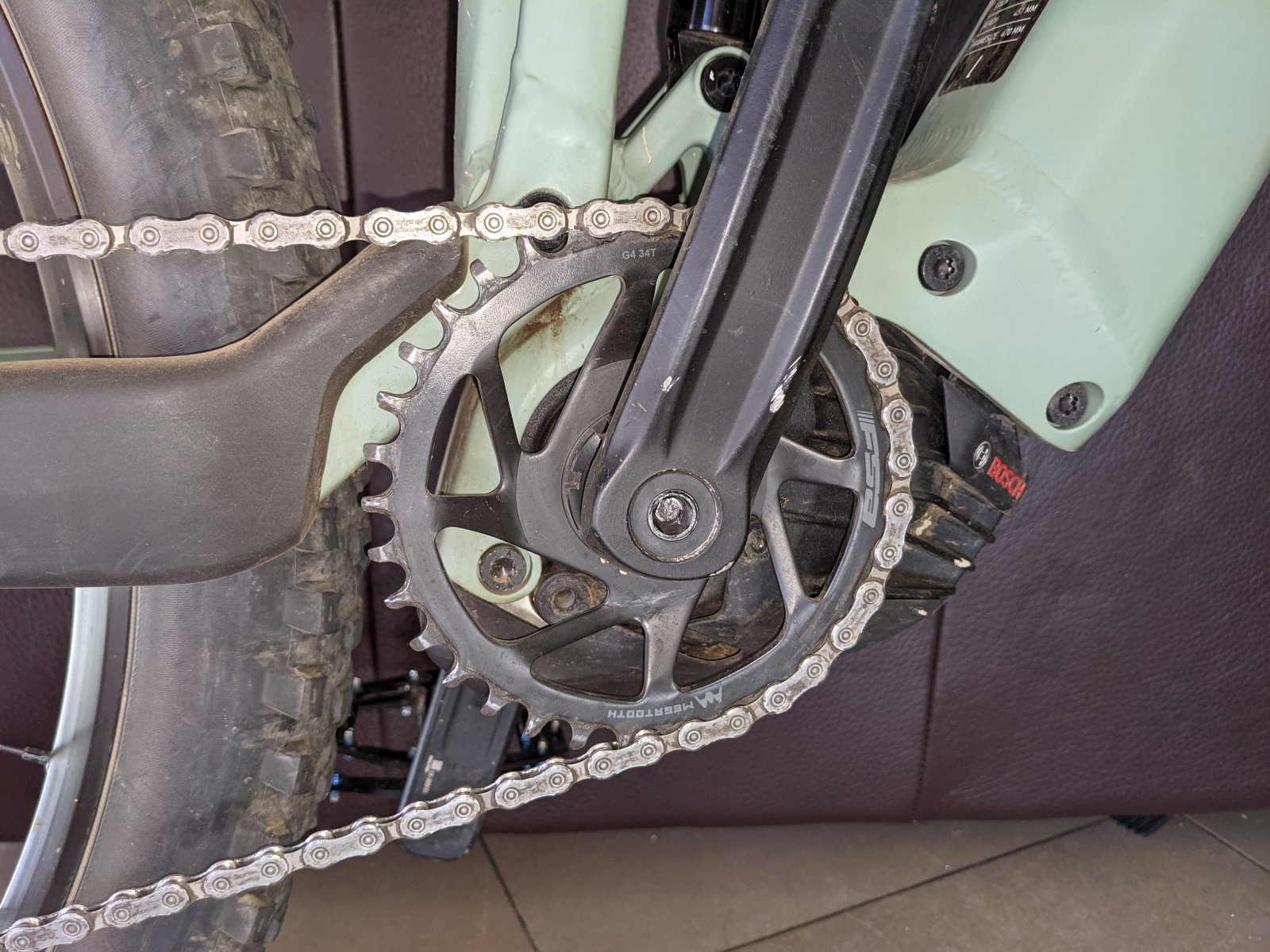

I think the are using now the correct ones, SH12...see picture, sorry for the quality

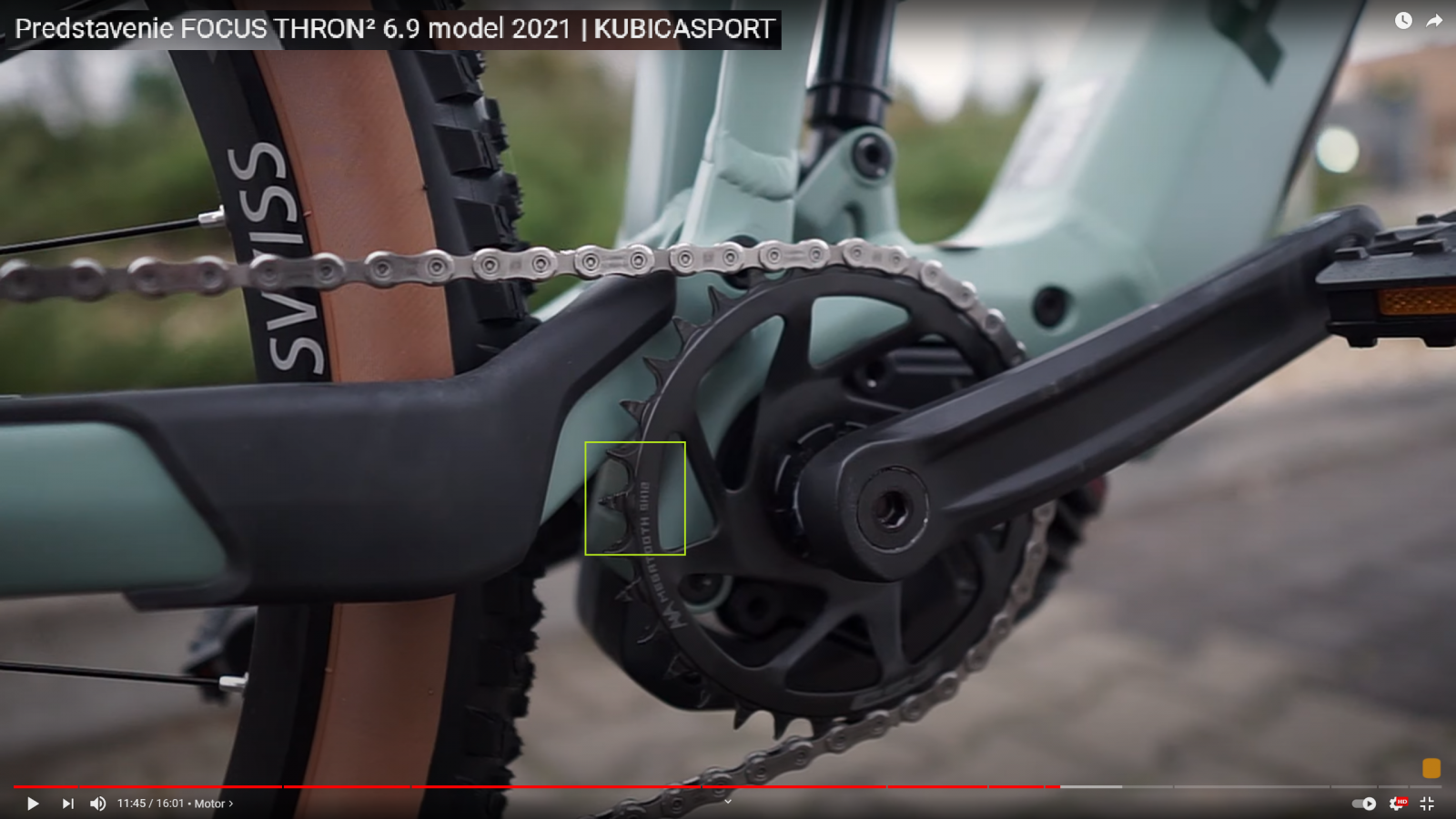

Got a better picture of the updated chainring from a youtube review of 2021 thron model.. (Mine was 2021 too though)
Now clearly with the big difference in the teeth profile you can see why the old one was a problem..
contrast that with the original

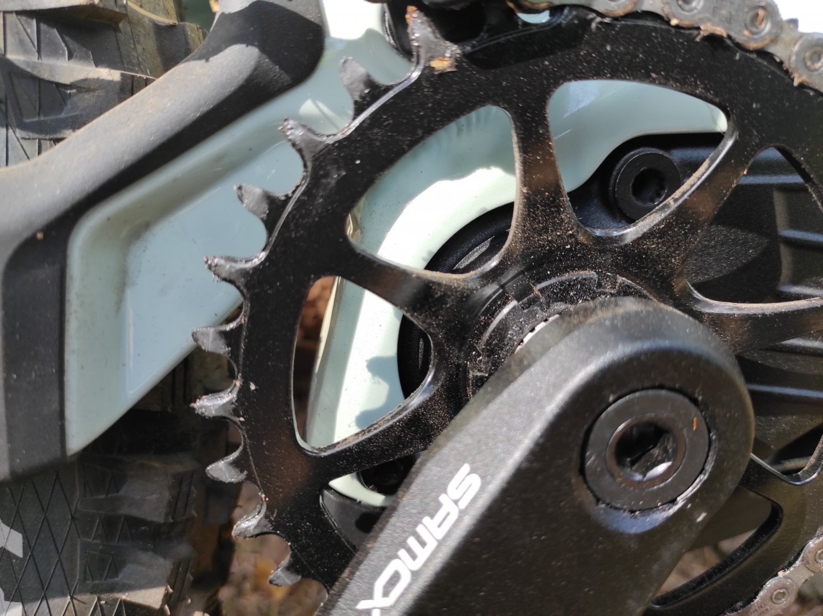

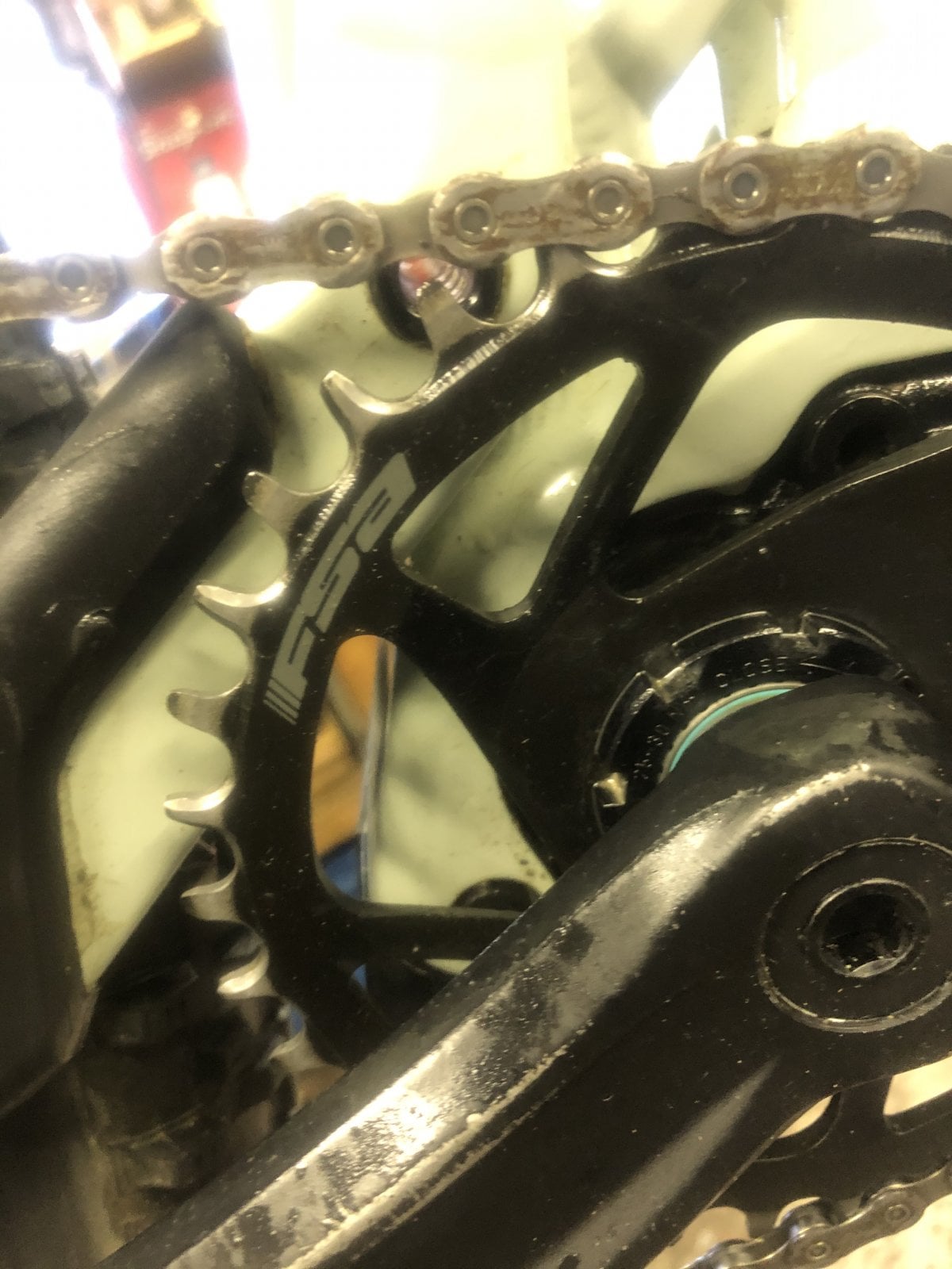

Wow, you can really see how much the chain has worn away at the chamfered edges of the big teeth!
I'd imagine that chainring probably performs okay now, that it's been worn down so much.
How much distance have you logged on that bike?
Landy Andy
Feb 8, 2021
192
191
Herts

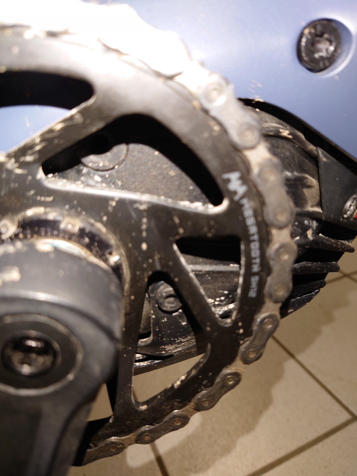

Good news. Thanks to this thread. I contacted my LBS who in turn contacted Focus Australia and am now getting it replaced along with a new chain under warranty. Thanks again for your time and effort in posting this issue! I have ridden approx 1120km since April. Albeit my chainsuck has reduced now, probably due to wear on the chainring and chain. But no doubt it would return if a new chain was fitted. Im looking forward to a smoother ride with the proper chainring!
niczoom
Aug 24, 2020
7
Adelaide
Wow, that seems to be a lot of wear! You can see quite clearly that a lot of the black has worn away too. Ive attached a phot of my chainring which is after approx 1100km. My bikes in at the LBS to fit the new chainring and will be getting in back in a few hrs from now :)

It's normal for the black to wear away at the contact points on all chainrings. Obviously its going to show less wear if it had the proper chain/chainring combo and was making contact in the right spots though..
Interesting that your chainring has no written markings Zimmerframe maybe you could check on the rear side for a model #?

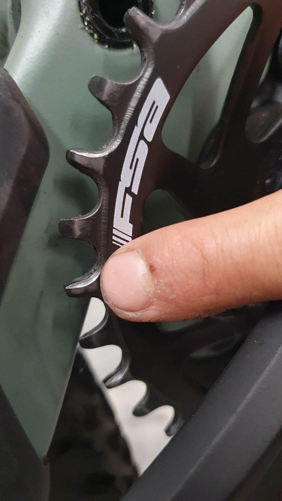

On my spectralon with shimano 8000 I started having the same problem as the OP since I first had to change drivetrain parts, it has 11 speeds. It seems the tolerance on the chainring is critical.
I have had the sensation these noises were associated to bearing wear, since there is so much hype about this on the forum.
Finally last month i resolved to try and use a non wide/narrow zee chainring and all those noised disapeared.
Now my motor at 4.500 km is as “silent” as new. Will try to find a new original shimano N/W chainring to replace the zee one, but its allmost impossible here. But stay away from cheap after market chainrings.

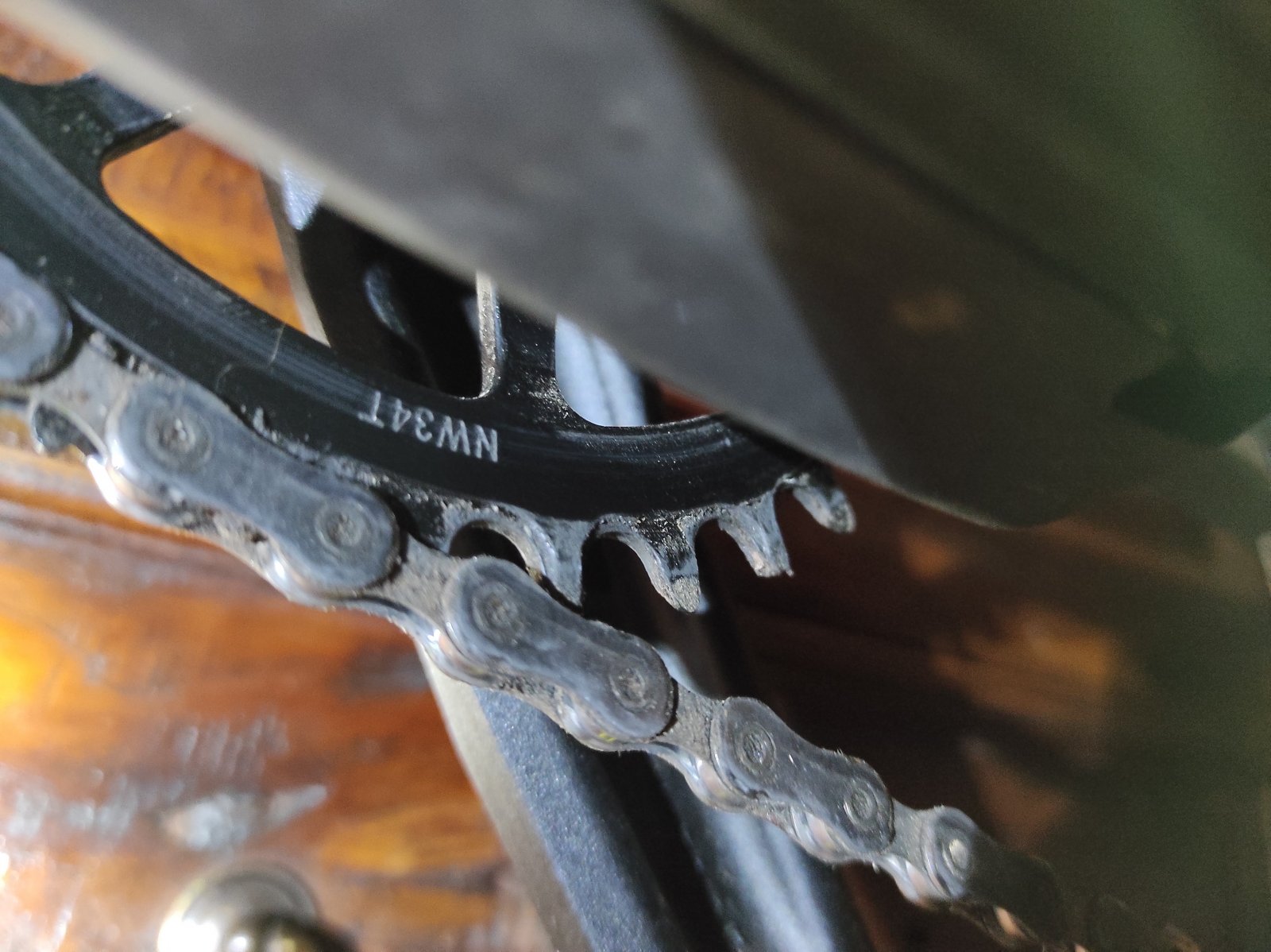

All I have is NW34T
So Narrow Wide 34 Teeth ..
Hmm seems like a pretty generic narrow wide chainring. Can't find anything on it.. My guess based on looking at the teeth in your pic is that its probably not hyperglide+ tooth profile. I would consider replacing the chainring and chain. Go to your dealer and show them the problem, tell them that you suspect the chainring is not correct tooth profile and get them to ask focus for replacements.
