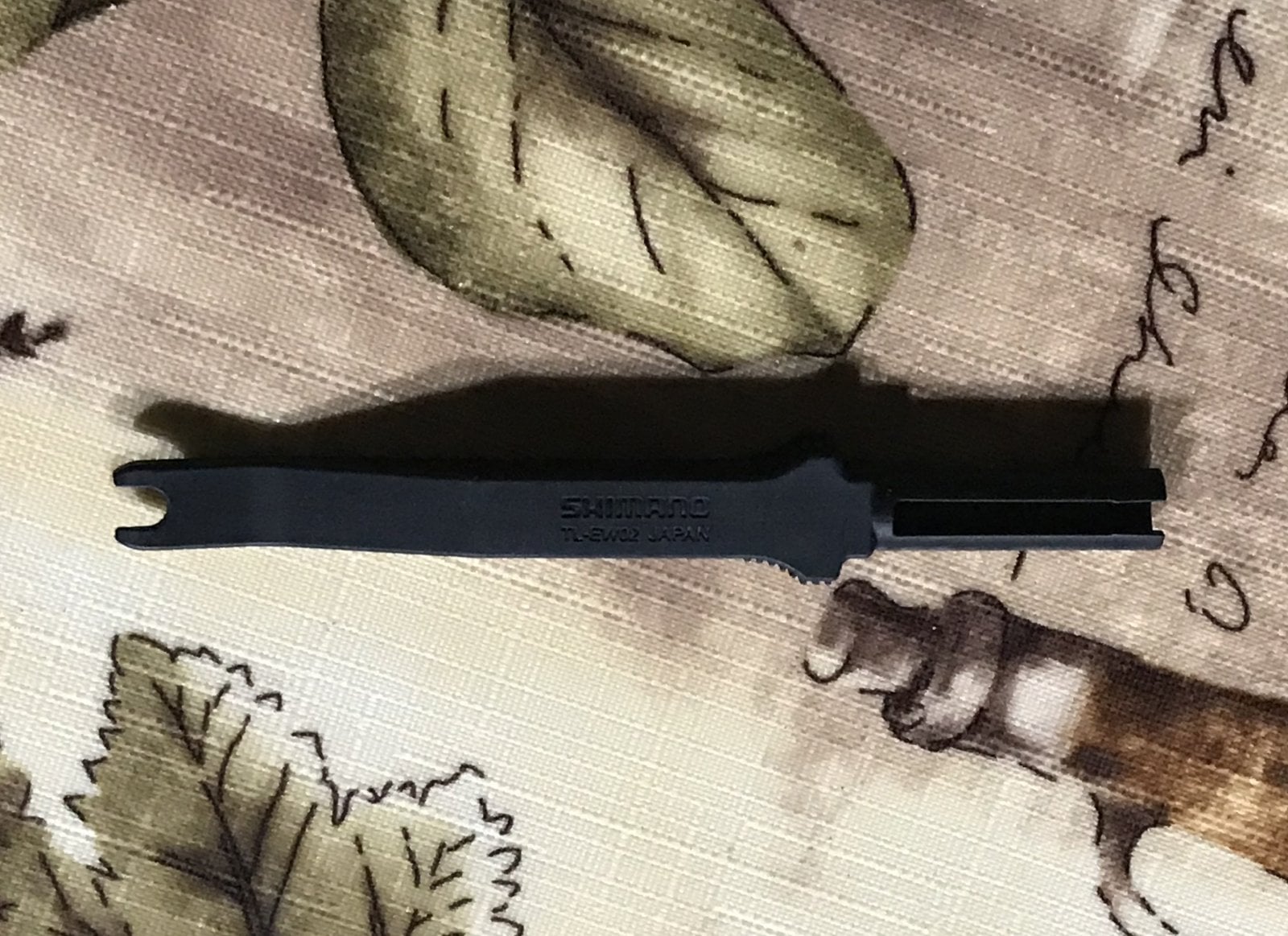

What’s this supplied Shimano tool for connections look like? My sx has arrived at bikeactive but he didn’t see and tools in the Commencal box,he’d been warned about the switch BTW but I told him to just send it on to me as I just want the beast?
net wurker
Sep 30, 2019
185
237
Huntsville, AL USA
this

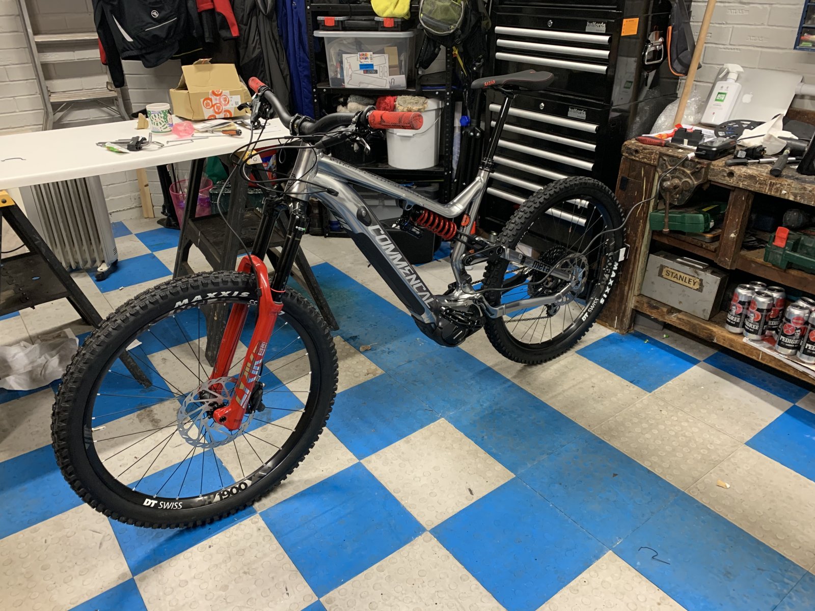

I’ve finally received mine about three hours ago,I’ve plug it straight into the charger and it’s gone amber,do I need to connect any other cables? I heard someone mention connected the motor to battery if so where is that connection?BTW I pressed the power button and it just flashes once but doesn’t turn the screen on.
Trickz
Sep 2, 2019
281
273
Burton upon Trent
Take the left side motor cover off, the connection is in there.
Let it charge for 6-7 hours before you determine if there is a problem with the switch. On mine, the light on the charger goes off when it's done charging.
So the non drive side shimano motor cover? It’s ok I’ve had no instructions with the bike showing anything about this?
