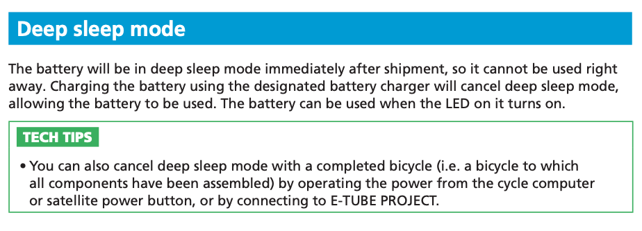

The dealer manual for Steps says:
Shame that most of that seems to be incorrect.

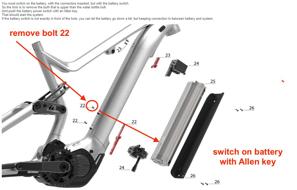

I got the bike to turn on after removing bolt 22 and using an allen key I manged to push the battery button, and the display came on, used the + button to change the mode and the motor works. Turned it off using the power button on the frame, AND it won't come on again, unless I remove bolt 22 and use an allen key etc....
This can't be right! another email to Commencal....
