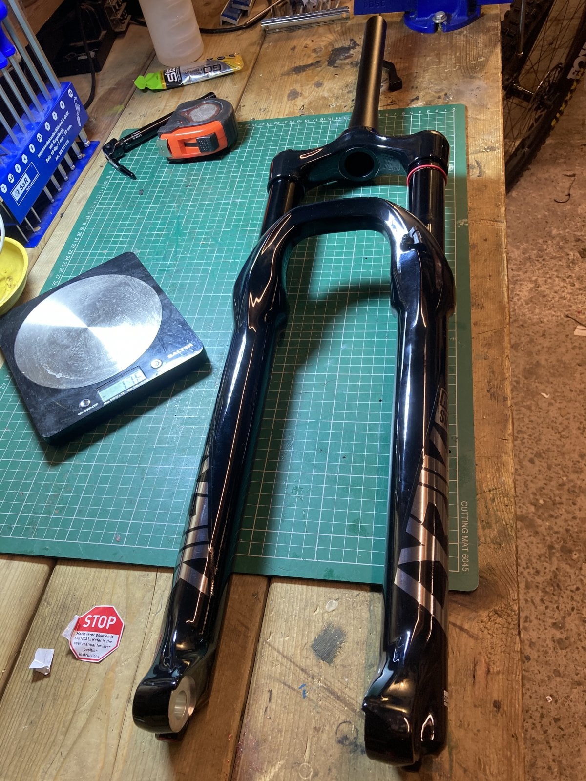

Well, the lyriks arrived this morning which was unexpected! For anyone still interested I will weigh them when I get a chance today

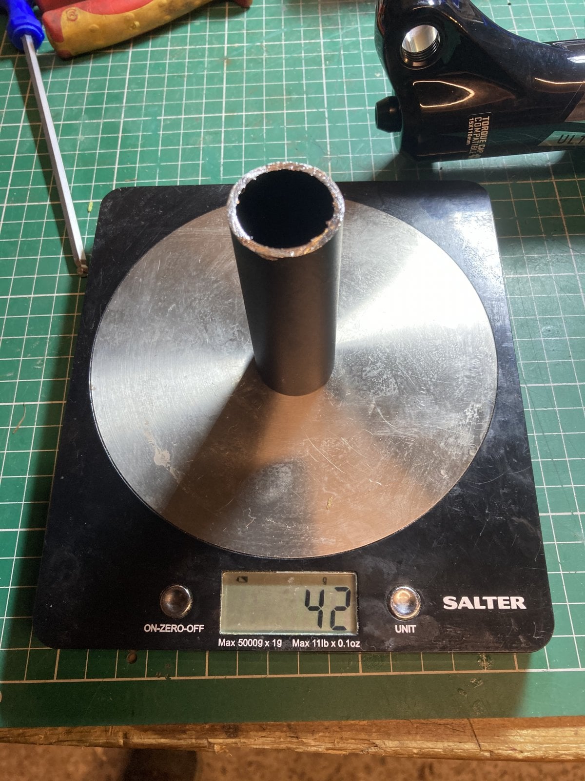

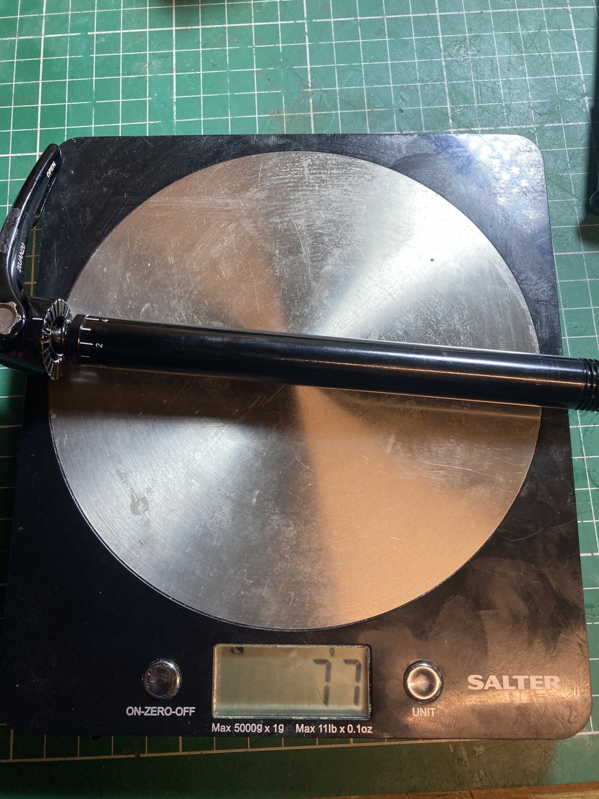

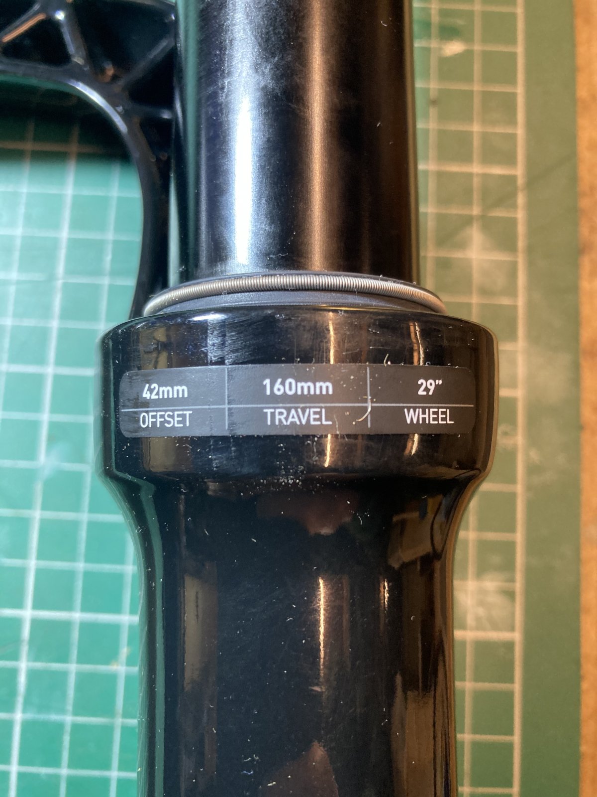

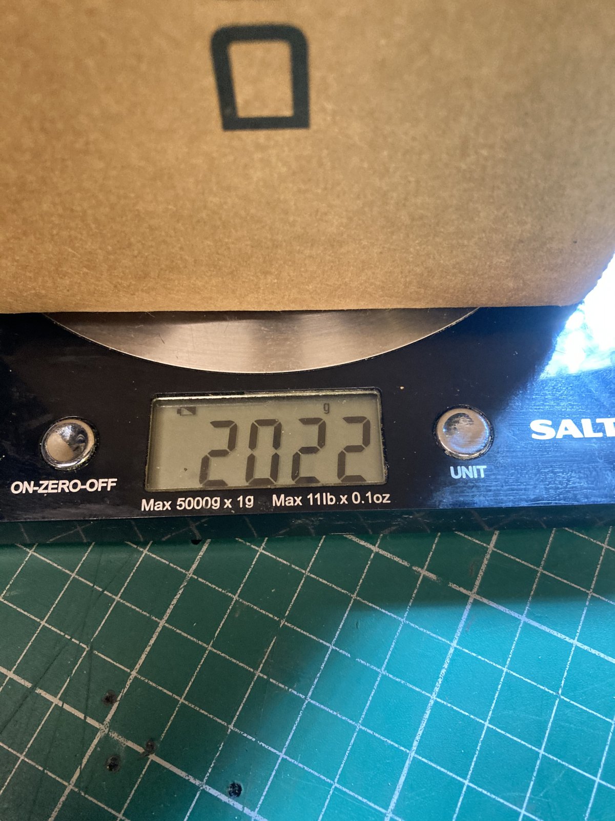

So, 2020 Rockshox Lyrik Ultimate 29er 160mm travel weighs 1980g with the steerer cut to 18cm (not inc. the axle)

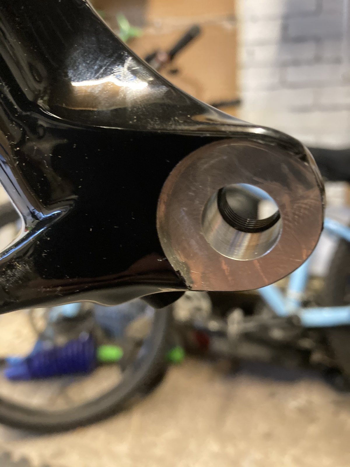

Now can anyone tell me or link me the item I need to fit my wheels to this.... it's 30mm diameter and differs the fitting on my wheels for the fox 34's

You'll need some torque caps for that! I found that for a heavy rider the best fork is a Fox36 with a Vorsprung spring conversion!!!!!

Its just rockshox proprietary axle stiffening mechanism, they're called torque caps but they're not available for all hubs, if you cant get them for your hub, just run without, it makes a tiny tiny difference to stiffness.
