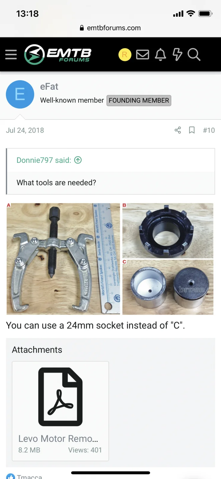

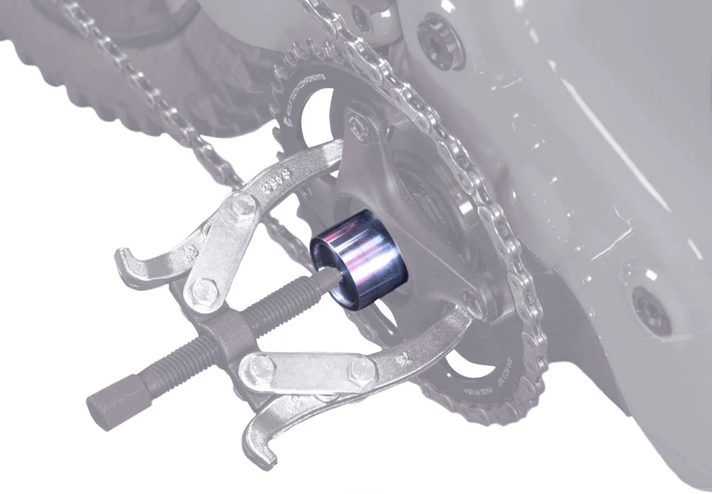

Why don’t you just remove the cranks, plastic nut and use a gear puller to pop the chainring off? Easily done and how I do it.

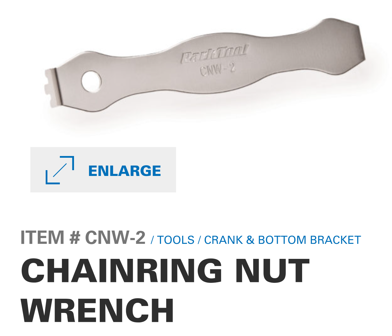

You shouldn't have to remove the crank. May be just the right pedal (to be able to slide the chainring out after removing the bolts).
When I replaced my chainring, I used a special wrench from Park Tool (below) to hold the slotted chainring nuts in place while loosening or tightening the bolt. Chainring disassembly and re-installation was fairly quick and easy.
Just make sure you Locktite the bolts after replacing the chainring.

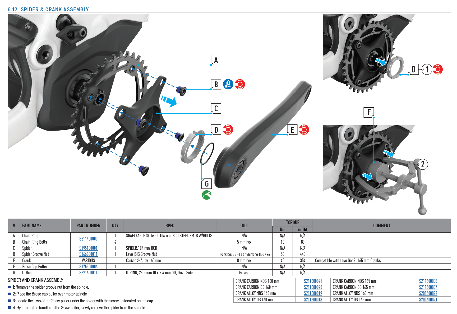

I needed to remove the crank and spider to get my chainring off. It wasn't possible to get adequate leverage on the back side of the crank bolts in my case.

Well I remvoed the crank but still cant get the cahinring off as it wont come off the spider without taking the spider off

Yup - edited my comment. I meant to say crank arm + spider. I used the lockring tool and a gear puller, as suggested above.

Off to my bike shop to get the tool lol. Was the lock ring torqued or does it unthread easily with a 32mm socket?
It's on there quite tight. The torque spec is 50 Nm or so if I recall for my 2022 Levo.
