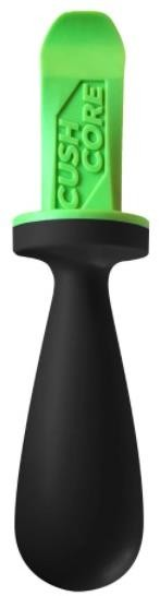

These are invaluable for tyres with inserts

Bonus is you can buy three and chuck one in ya bum for triple tire lever action!....
PS I've still snapped those bastards too....
You rough sod 🤣.
It's a good job they are guaranteed for life. Or does that just mean until you kill it?
You’re thinking of Tush-Core Levers…they look the same as CushCore Levers.
And how in the hell did you snap a Tush Core Lever? 🤯 . …that’s some serious action right there!😉
