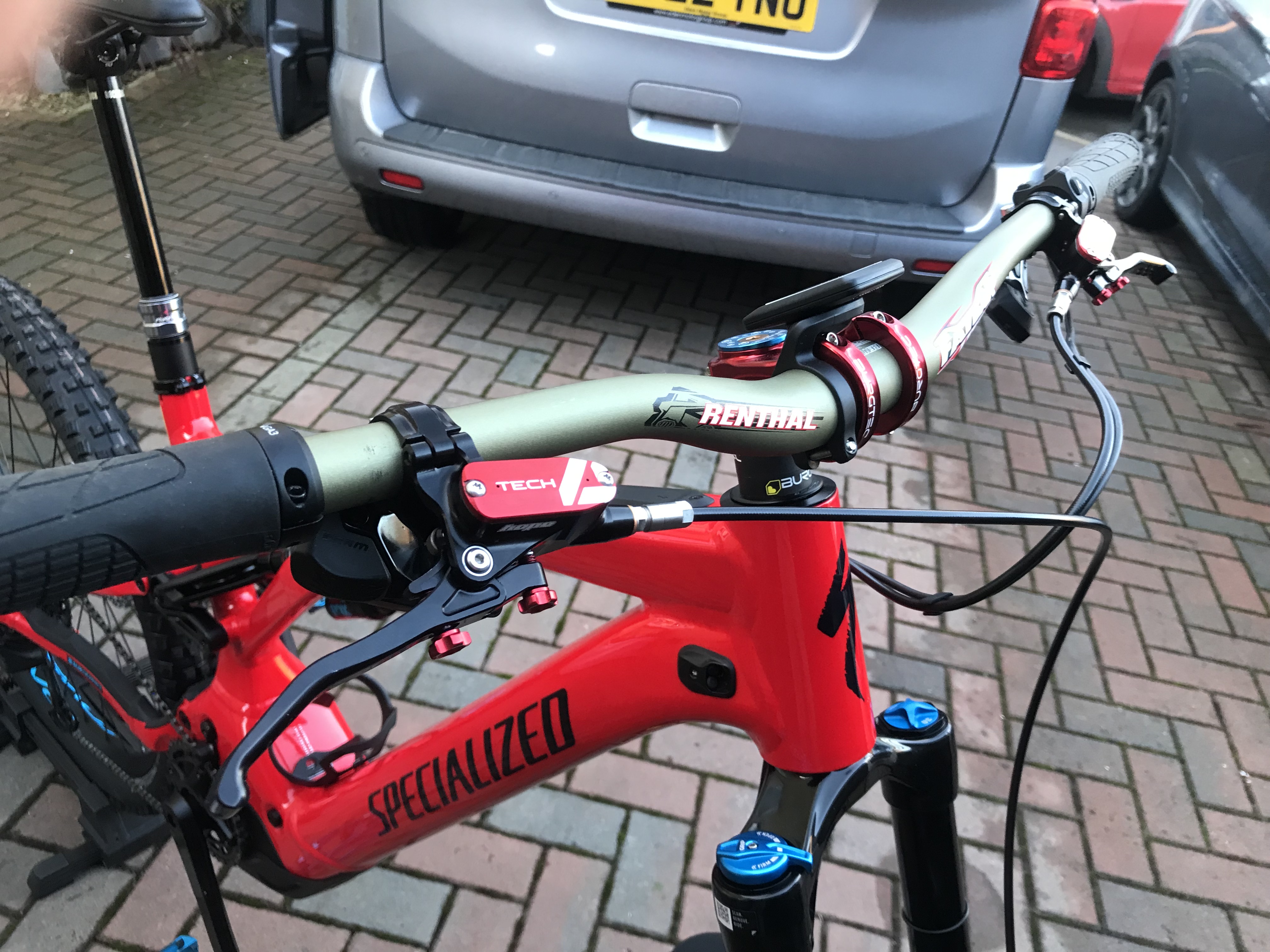

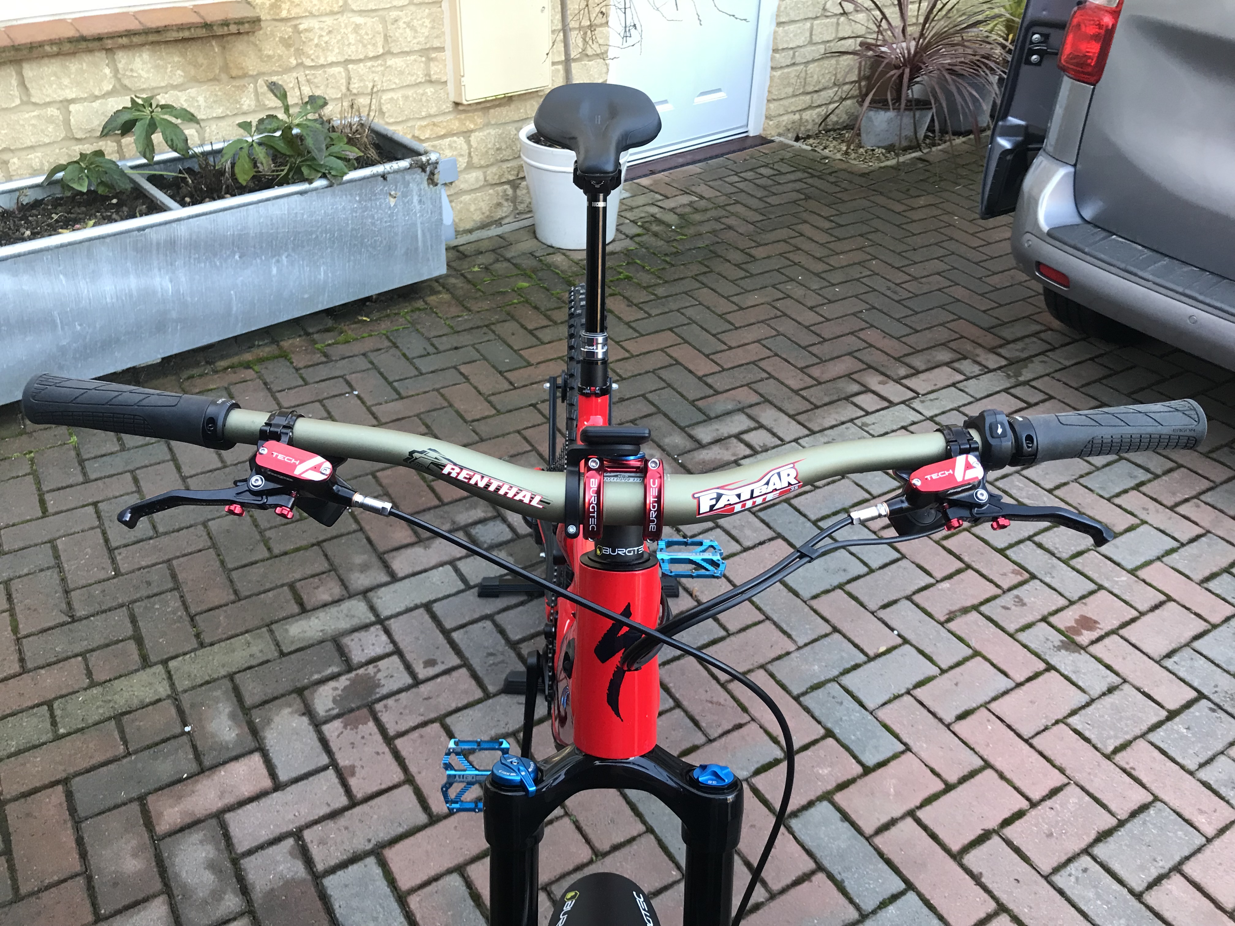

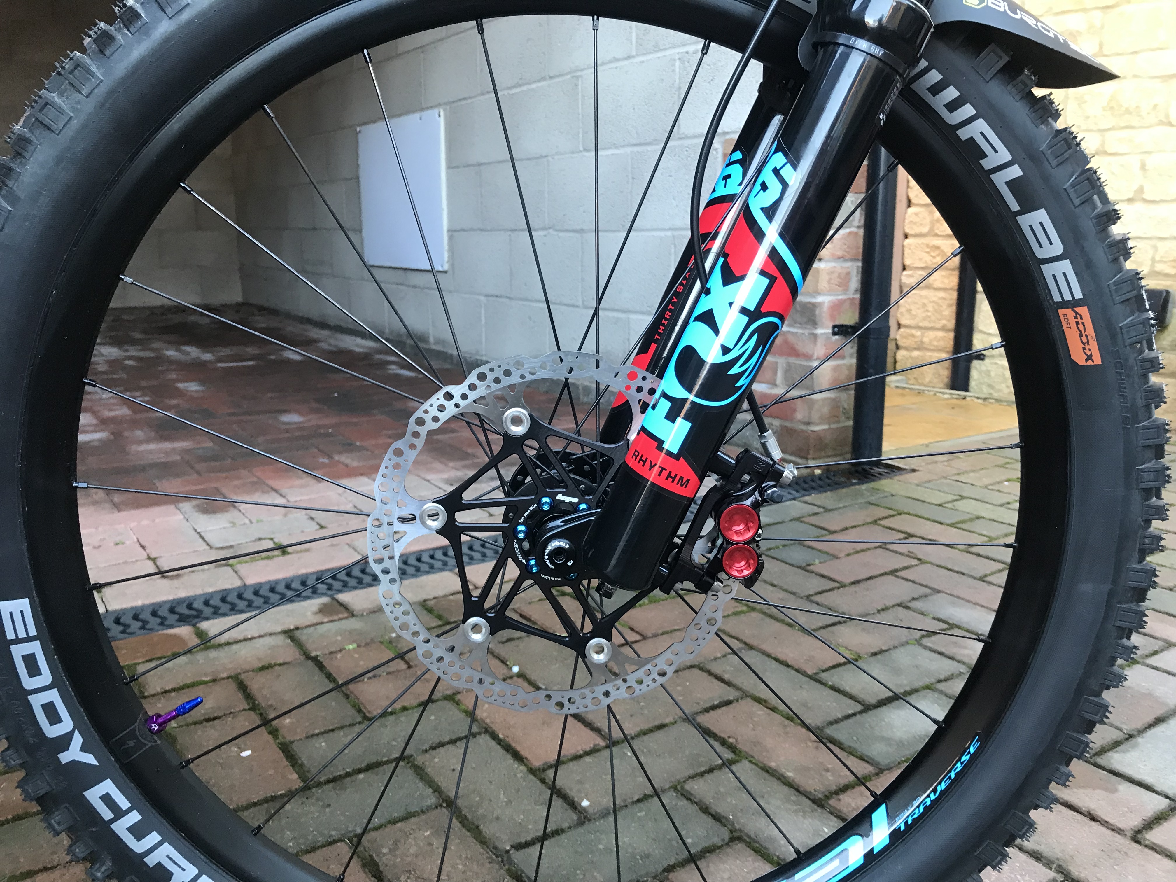

Front brakes are installed. Notes: Used my digital torque wrench to tighten all the bolts. I cut 8 inches or 20cm off the hose length. Routed the hose and retightened the hose fittings. Did the lever flipping did not see any bubbles so put the top cover back on. Installed the Matchmaker for the dropper post lever. Checked that the 4 pistons were extending together. Applied a little slick honey to the pistons while they were extended. Aligned the caliper with the brake pads out and verified no leaks once the pads were reinstalled. Next I will be installing the rear which will be a little more work. Pictures below.

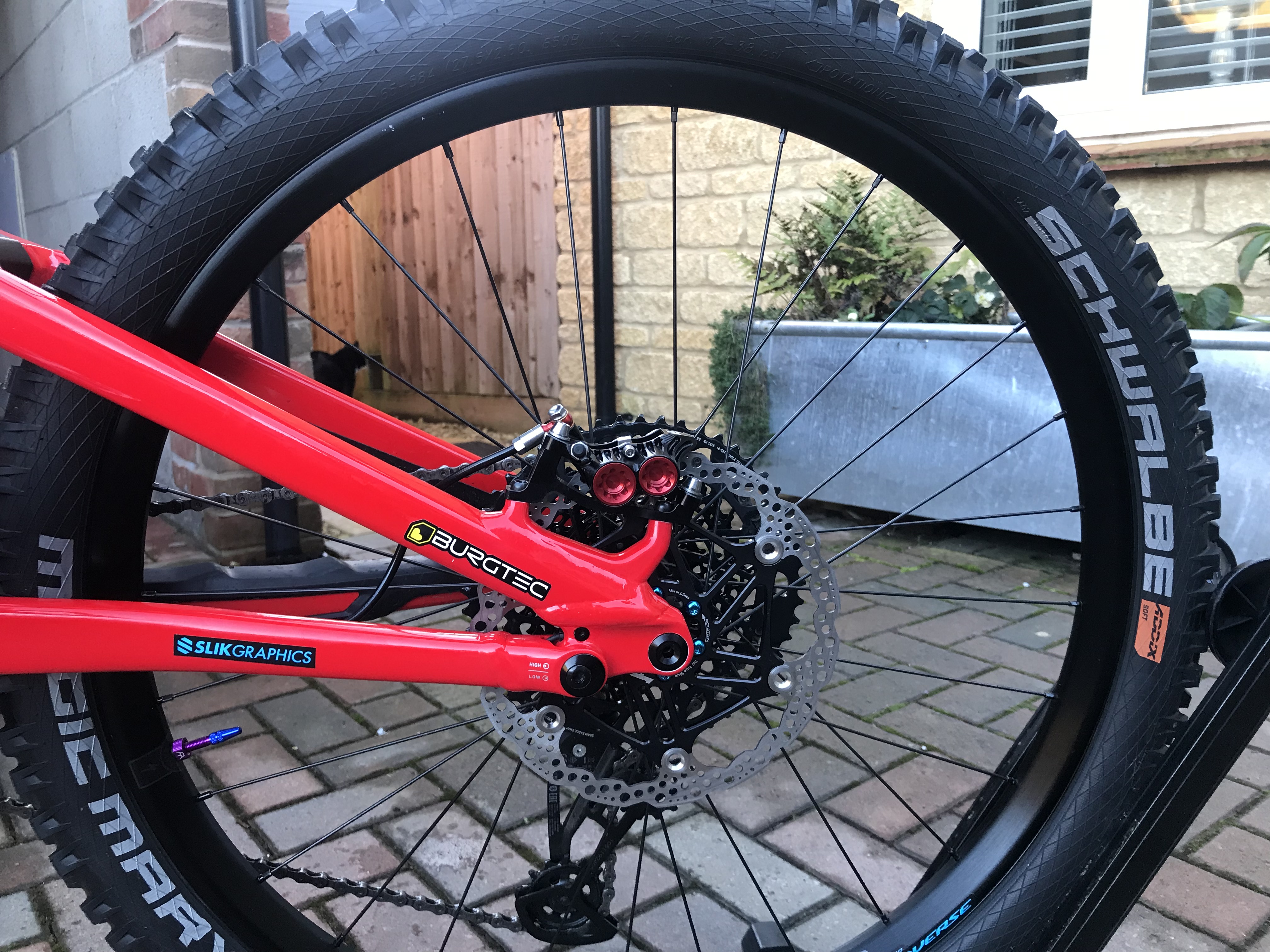

Rear Brakes installed:
Notes: Brake hose was easy to install through the frame. Did a reverse bleed on both front and rear. Next will bed in the brakes before hitting the trails for a real test.
