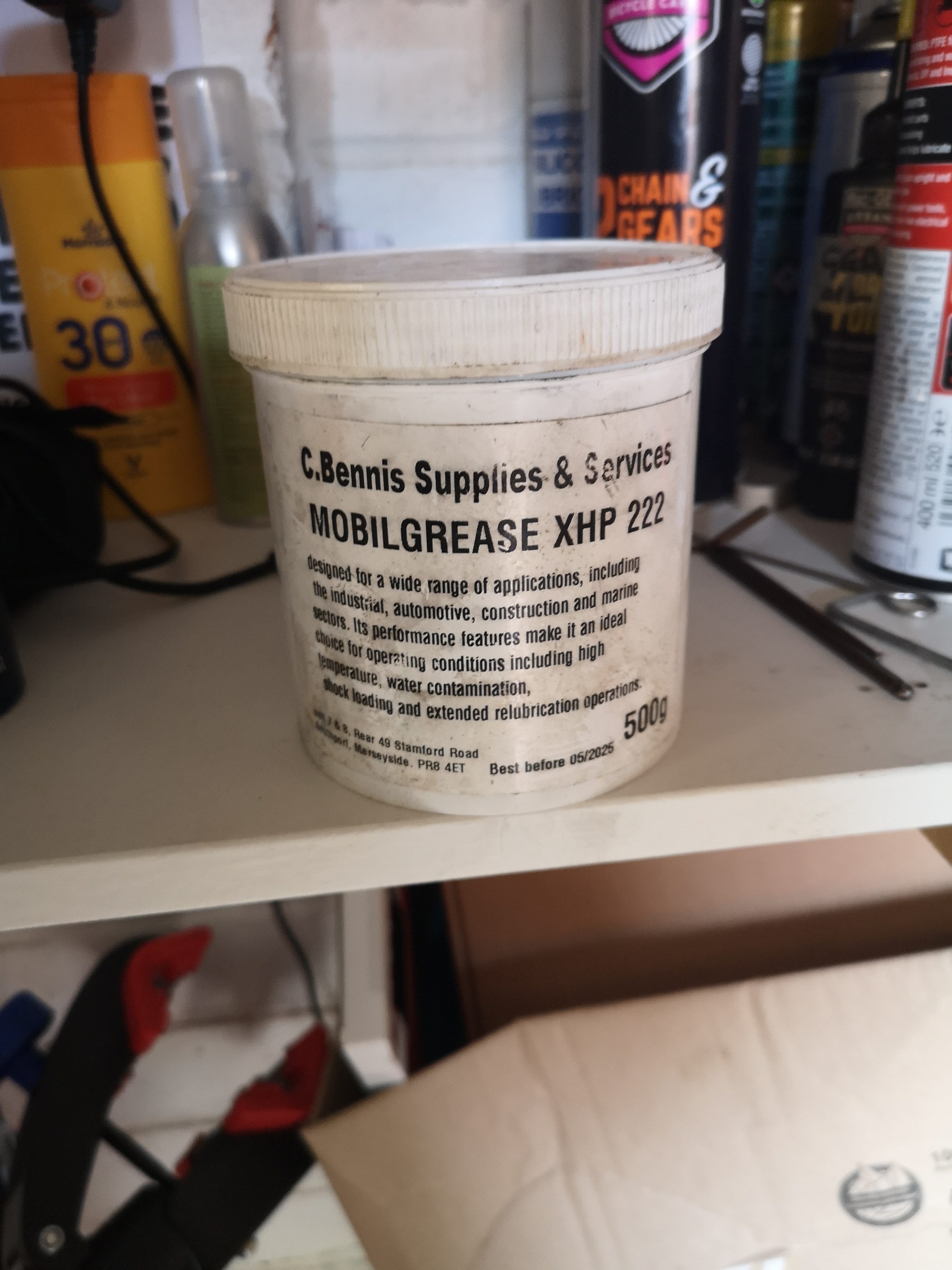

Well I'm not saying this grease is correct but it's what I use on everything on my bike.
Its a blue coloured marine grease that resists jet washing and seems to work well on my bike.

It looks like I might have to suck up the hub noise, I had a bit of a brain storm and I contacted Hope, they use the Mobile grease XHP222 recommended by Bones 🙏 but they don’t recommend using any more than what’s already in there as it could effect the pawl engagement as has already been mentioned, I’ve found some at a good price so I’m gonna get some for when I need to do anything else on my bike, cheers guys 🙏
