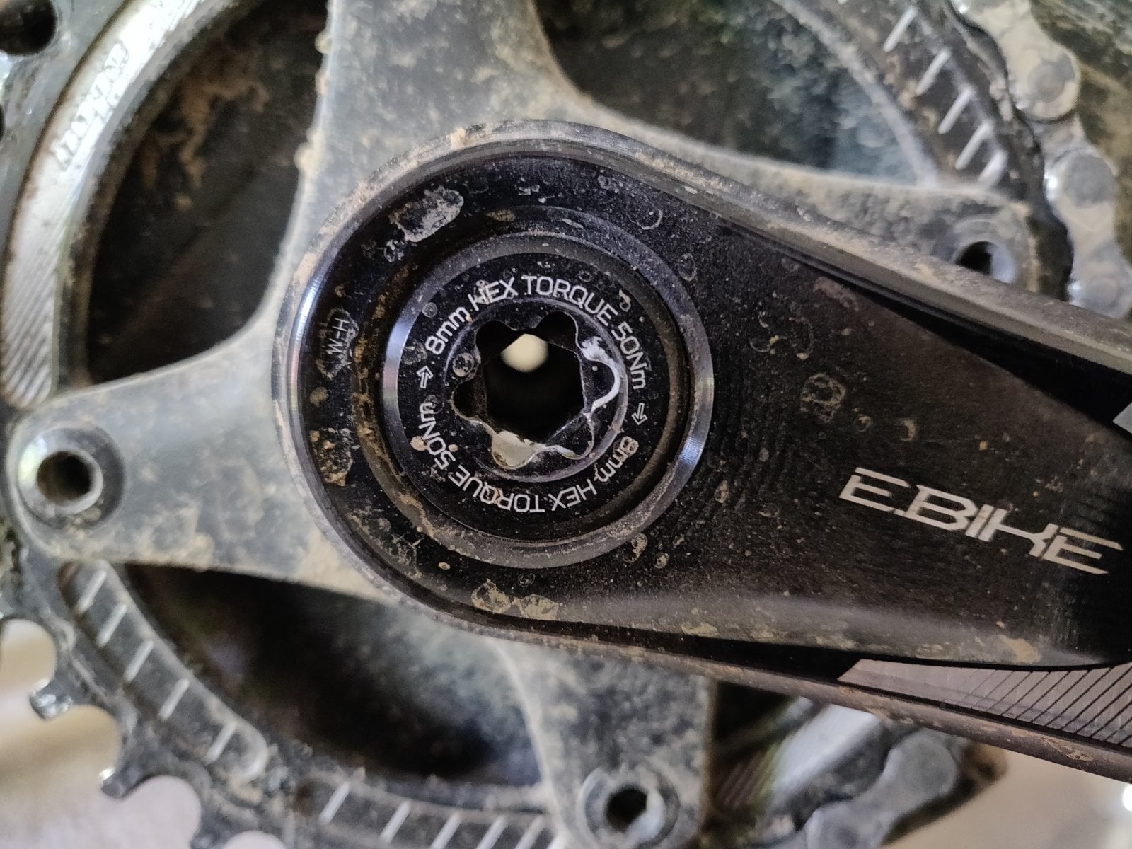

I can't work out what's wrong with mine, I'm not overly used to the Isis fitment. I bought and had them fitted by a very well respected shop.
After a few rides I checked and the drive side bolt was loose so I can cranked it up. It continued to loosen so I eventually stripped, cleaned, greased and used loads of locktite and some dobs of paint that I thought would fix it.
But no, it still loosens. As you can see from the paint marks it's allowed at least another 100 degree of tightening from the 3 oclock position to 7 o'clock.
I don't see what's causing this, are the splines damaged? I crank them down pretty hard, but I have sheared a similar bolt in the past by overtightening, so im being careful. 50nm isn't that much really.
So to summerize, the bolt is coming loose without actually moving, I don't see how this is possible.

Did you find a solution to this problem @cozzy
cozzy
Aug 11, 2019
931
1,038
Hampshire UK
This was a while back!
I'm trying to work out what im saying in that post as it's poorly explained.
The crank never came loose on the splines. The bolt needed further tightening regularly despite never backing off. Perhaps the crank was never fully seated due to my worry of overtightening.
I recall I went back to the stock 165mm cranks as i didn't get on with 155mm anyway.
My current bike has hope 165mm cranks with no issues. I do check them regularly.
I missed the question about the crankboot also. Raceface alloy are the ones.

Did you use a torque wrench to tighten them?

A few reasons why a bolt may come loose.....
In general a high torque fixing not subject to vibration or heat ,needs only to have clean undamaged threads lightly lubricated with grease or anti seize. High torque on bike fixings being anything over about 25nm. The torque setting is calculated to be the point of maximum friction between the threads but below the bolt shear point. Incorrect torque is the main reason for a bolt rated at 50nm coming loose. Lack of lubrication or incorrect use of a torque wrench being the main reasons. For a torque wrench to achieve correct torque the bolt needs to be below that setting and arrive at the setting with the torque wrench in motion.
Obviously a poor quality incorrectly engineered or damaged bolt will always cause problems......overtorqueing a bolt or a bolt that has come loose are both likely to damage a bolt.
Smaller/ lower torque bolts are often recommended to be fitted with a thread lock. Blue locktite is a popular option. Applied wet it both lubricates the thread and once set increases the bond between the threads. It needs 24 hours undisturbed to set however. A re -used locktite bolt should have dried locktite removed before applying fresh. Heads/untreated shoulders of the bolt should be greased.
