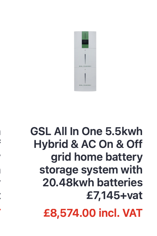

I am not personally sold on the idea of the current battery systems they are expensive for what they are i.e £10k for 10kwh and it'll maybe last 5-8 years.
Not that expensive at the moment. As an example, I have found these all in one systems below that include battery and inverter. Its 20.48 KWH and priced at £8.5K
With current pricing I have worked out that on my Intelligent Octopus tarrif (essential for running EV's, makes it cost around £7 to fully charge).
The battery listed here is rated for 6000 full charge cycles (16 years by my calcs if cycled every day) and 10 year warranty.
Eco 7 tariffs have been around since i was a kid and maybe longer, so i think that there will always be cheaper rate off peak vs peak rates.
Hmm, more research to do still though!
cost to charge your 20kW battery at night 20 x 0.1 =£2, that would cost you (20x0.42)=£8.40 using daytime rates, so assuming you use all that 20kw every day you'd save (£6.40 x 365)=£2336 per year (in an ideal world with no losses)
but if the daytime rates drop to 20p/kwh next year then you'd only be saving £4.40/year, also the EV charging rate could go up
the 10 year warranty sounds good, but I bet it doesn't account for degradation. in general they are not lasting well, see here
Rob, did you go for a battery bank in the end and any updates of actual running costs / benefits ?
