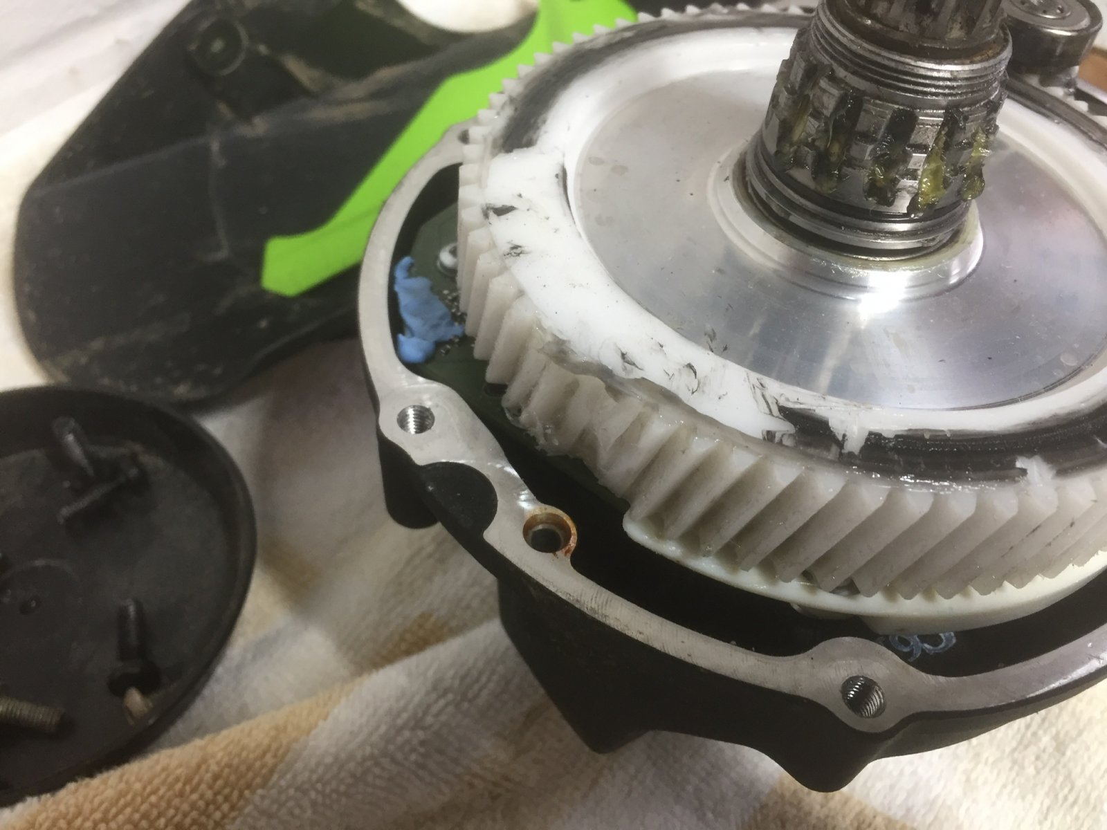

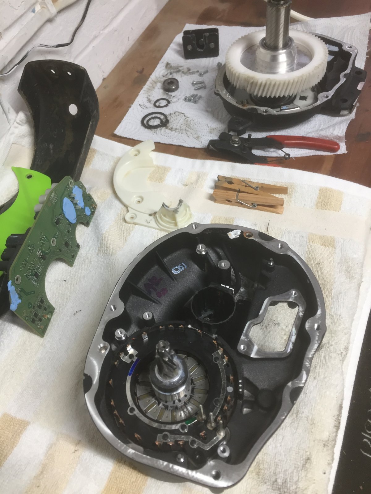

So I had time to pull the motor apart this afternoon.
The most obvious damage was the broken teeth on the nylon gear and the lost teeth were what was stopping the cranks from turning backwards. I still have to pull the core of the motor out in order to check it hasn’t been bent, (is there any trick to removing it ? I’m assuming it’s just the strength of the magnets thats holding it back)
if the motor spindle is still good, it should be a straight forward repair, just a new gear and I’ll replace the other bearings that I didn’t bother with last time (only 200 miles ago)

Motor spindle will be fine, these will normally snap before they bend, and yes, it is just magnetism holding it in there, but be carful of the little plates that hold the magnets if you decide to pull it out. In fact you will have to pull it out because you have removed the bearing from the top and you will need to support the armature to press a new bearing back on.
You may have done it this way, but for others reading: If you want to remove the gear without removing the armature bearing, just remove the left hand outer crankshaft circlip and pull the crankshaft out from the right, then you can remove the gear. Leaving the armature bearing on makes it much easier to remove the armature too.
Is your motor an Active Line Plus? They normally put a steel gear in the Gen 3 Performance Lines, much stronger. Contact me if you can't find a gear anywhere (y)

After I had a good chat with Peter (the bearing man) I decided to have another look inside the motor and at the torque sensor in particular, I couldn’t see any signs of damage to it or it’s connectors and there’s no way to adjust the sensor on my gen 3 motor. Looking over the circuit board with a magnifying glass, I couldn’t see any signs of water damage there either, I can only think the impact that took the teeth off the gear did more damage than I thought.
I think I’ll cut my losses on this one and just replace the whole motor.
