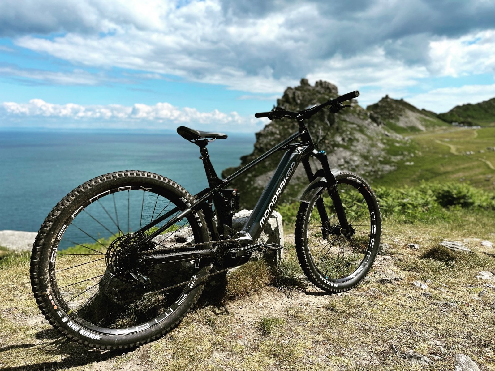

Hi all. I’ve recently got a mondraker crafty r and have a very loud rattle. Loud to me anyway. I see the sams bikes vid with the carbon one and he said it didn’t rattle. Robs new vid on the cube does rattle. I get that some may rattle more than others because of the ‘acoustics’ of the bike but wondered how many can say their Bosch rattles regardless of bike brand. Im begrudgingly ok if it’s the motor but I defo don’t want the battery rattling. it’ll be a bit more involved for me to stop that as it’s a fixed battery unless I drop the motor out. Thoughts welcome. Pic just for fun at the valley of rocks in Devon.

nice bike btw!
