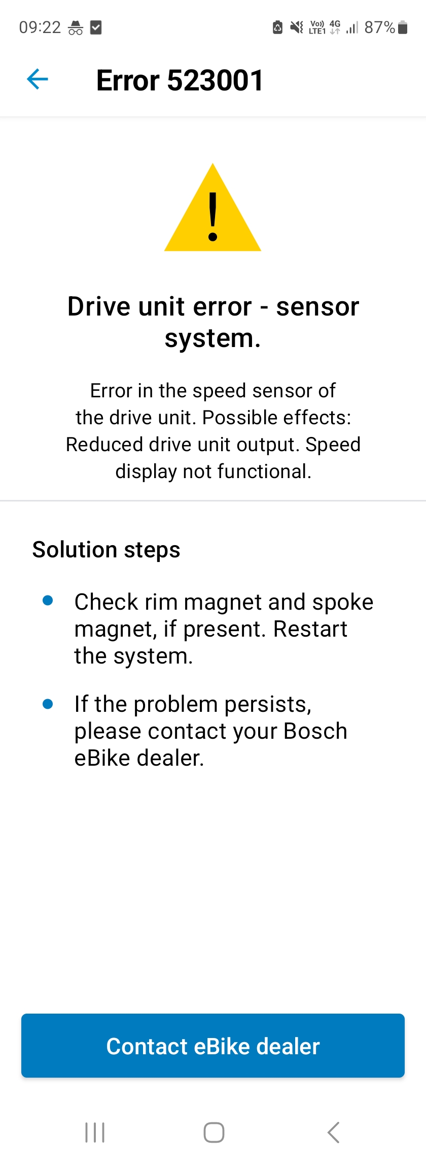

I have checked the magnet on my rear disc break and it's still in place aswell as the sensor which doesn't seem to have e moved at all. Restarted the bike multiple times to no avail
I had this on my Whyte e-160 when I first got it, my LBS replaced the sensor and the cable and it fixed the issue.View attachment 127956
Also make sure the magnet is close enough, some people put a spacer behind it to get it closer to the sensor. It didn’t work for me but worth a shot for a quick fix.Yeah okay thanks will probably give this a shot
