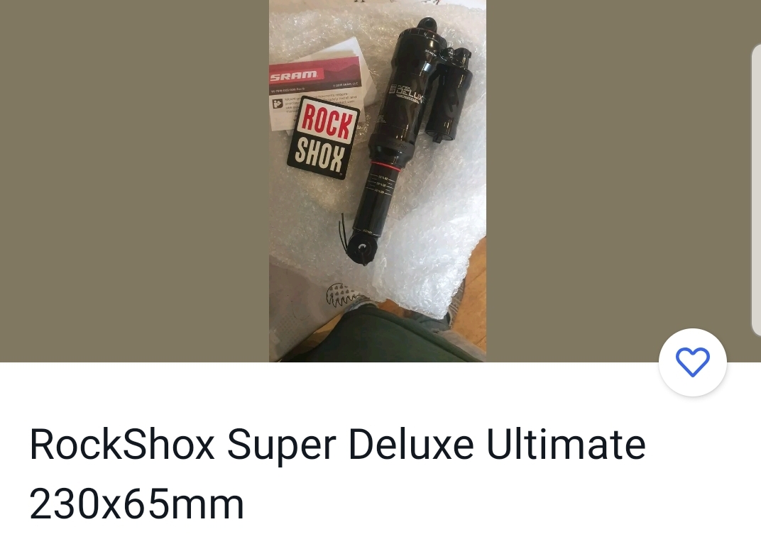

Help will this fit my trek rail
Dano78
Dec 3, 2019
162
35
Uk
Was just wondering whether this would fit my trek rail 9.8 2020 rockshox deluxe 230x65
Dano78
Dec 3, 2019
162
35
Uk
This image of a 2020 Trek Rail 9.8 from their website suggests a trunnion mount at the top, rather than an eye:
Rail98_20_30694_A_Alt5
What has yours got?
Mine has the same as this but people have said it doesn't have to be a trunnion mount or can be a standard type
BrentD
Jun 25, 2020
168
133
New Zealand
You can most likely get the mounting hardware to change from a trunnion mount to eyelet. As already mentioned, you will most likely want to have the shock stroke reduced to 57.5 (or possibly 60 I've heard anecdotally). The other thing to check is that the piggy back reservoir doesn't hit the frame at full compression.
Railingit187
Feb 8, 2021
19
7
Did you ever fit this shock to your rail? I do not have my rail yet as it is back ordered and I have purchased a RS super deluxe ultimate with the 230x57.5 standard eyelet. Just trying to get Information now so I can get everything else together. Did you find out if the piggyback hits the downtime of the bike at full compression?
