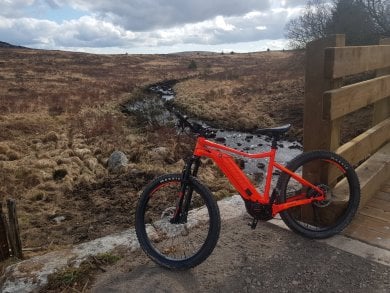

I'm also a below knee amp and a big fella as well so I'll add a few points from my POV I have 2 full suss, a hardtail and a hybrid all ebikes
Like you I struggle to stand up and pedal and have lop sided leg power.
Fullsuss/hardtail understandably you're looking at it from a non powered cycle POV. The extra weight makes very little difference to climbing, a full suss opens up a lot more terrain and the suspension will offer a lot more comfort if you're a bit creaky. So for example a forestry track that would normally be hardtail terrain you'll manage just as quickly and in more comfort on a full suss. As Stumpy says I don't think I've ever used the lock out on any of my ebikes
Pedals is a very personal thing. I love spds, I bought a set of mag pedals and couldnt get on with them but Stumpy loves them
Something else to consider is how adjustable the motors are. The ability to tune each mode to your own level of effort is quite important. My Giant for example has 5 modes giving me a wider range to play with so I'm working at the same level over various different conditions. Not sure if I explained that very well.
Finally I'm in Central Scotland so not too far away. Once we are able to move around the country a wee bit I'd happily meet you halfway(say Keilder forest) I'll bring a full suss, a hardtail and a hybrid and you can try all three(3 different motors too)
