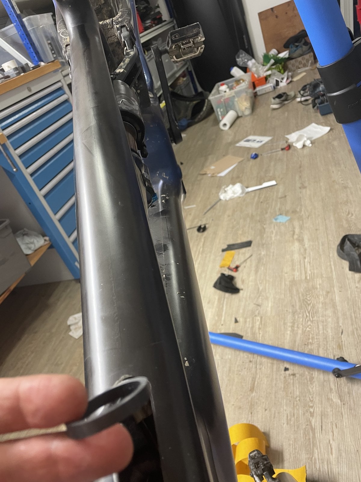

Hey there,
i had extreme knocking/ rattling sounds, always on shaking root lines. sounded like a loose part knocking from inside the frame.
But Nothing to hear when shaking the bike in the stand.
I now searched all the frame internals several times and found that Specialized imtegrated me some secret Swat spare part:
That carbon spacer was in the top tube end near the seattube and rattled as hell !
Perhaps other rattling levos also have integrated secret spare parts by speci assembly line ?

Christox
Aug 12, 2020
85
76
Freiburg/ Germany
It was my third try to find something in the frame. That spacer was sticking mos ttime fixed at the end of the top tube and was only noticeable when the bike was shaking hard frequently. I finally got it by lowering the front in the bike stand and fishing blind in the toptupe thorough the TCU opening with a thick wire. It took a few minutes and some different bent angles of the wire until i heard a part rattling which then came rolled to the TCU opening :)
Four Flusher
Jun 24, 2019
122
85
Reno
thanks, I'll give it a try
