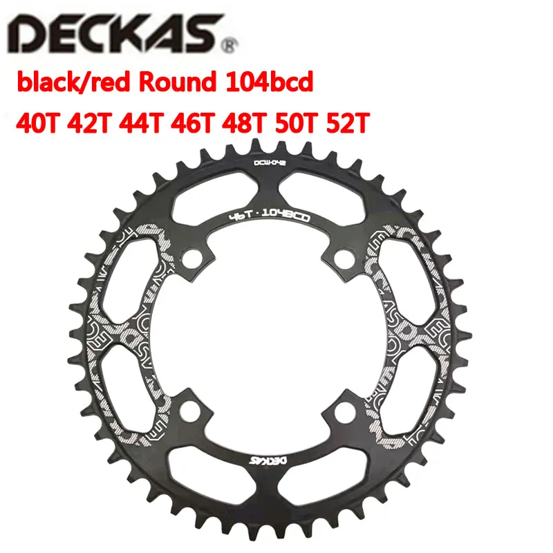

I use 44t DECKAS chainring on my emtb for the same reasons you describe plus that i run de-restricted. Chainring is narrow/wide and i use it without any chainguard without any problem. Change every 5000 Km.
