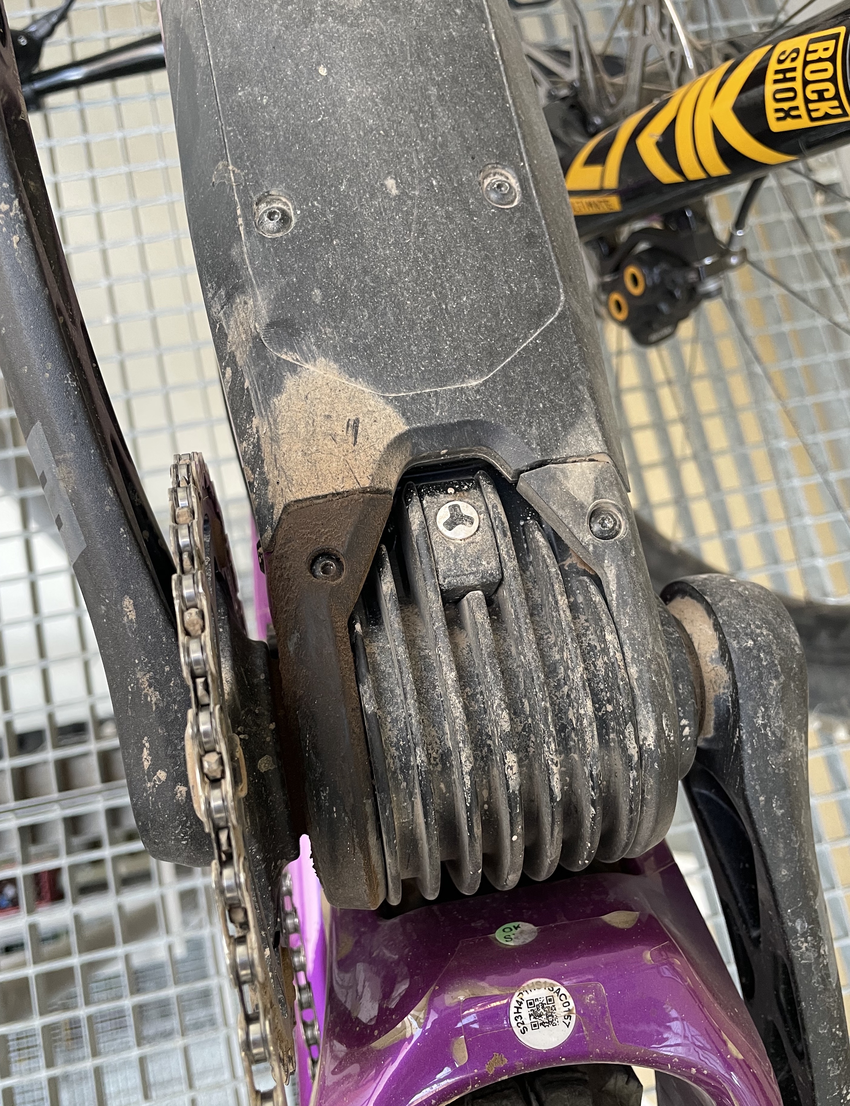

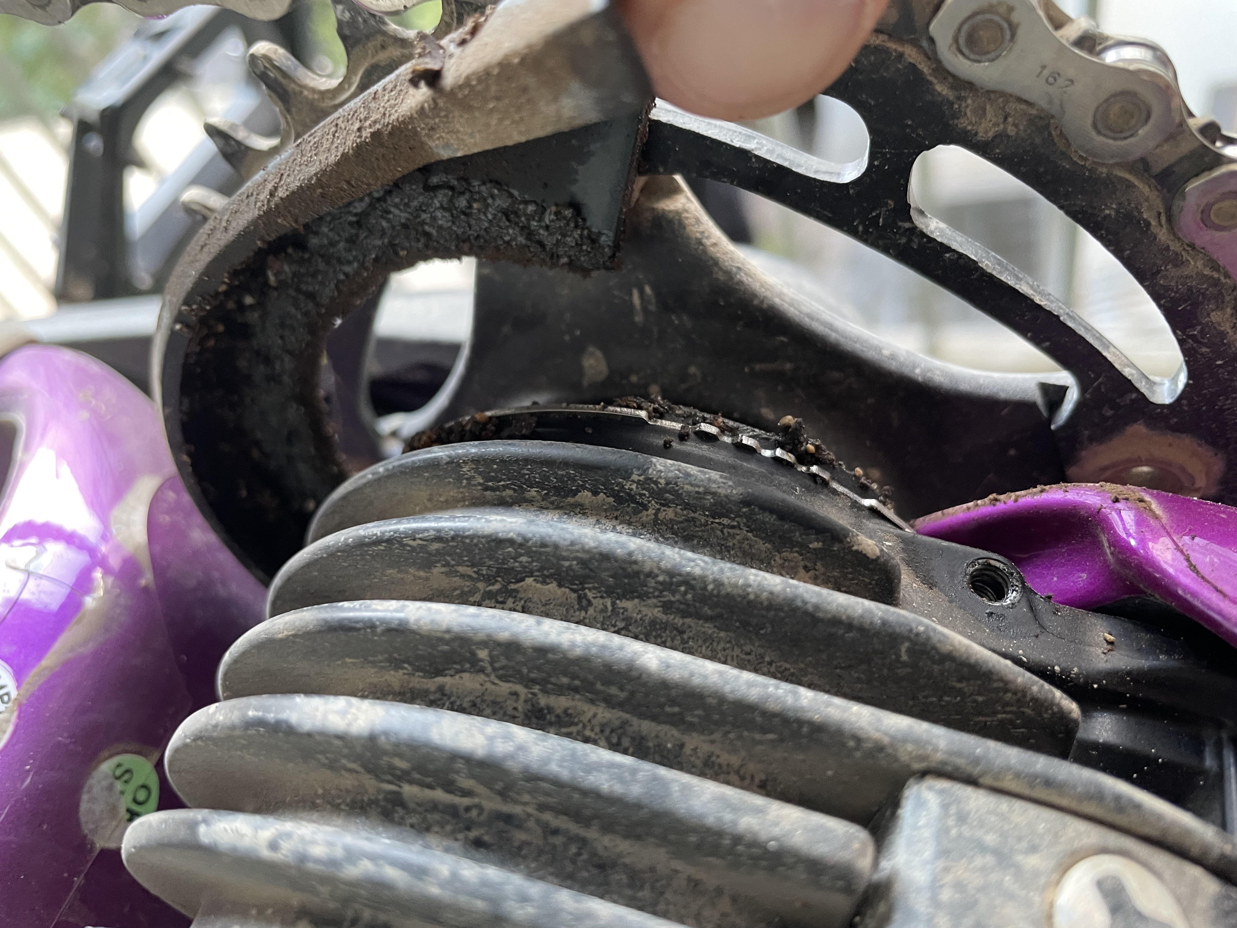

Just noticed a spot of oil coming out of the drive unit cover, and quite a bit of gunk build up beneath it, which is quite weird when it's been dry for months...
Any Fazua experts around? Is this coming from the drive unit or might it be something else?!

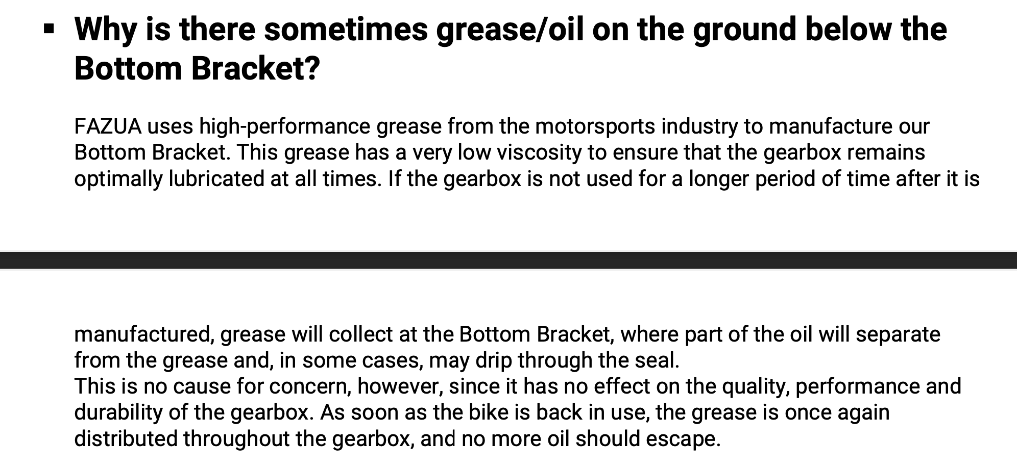

Shock seems dry... Read here that Levos had a similar issue, but came from the dropper.
Found this from an older dealer manual, not sure if it still applies to the Ride 60... Bike was stored for a month before this started to show up.
