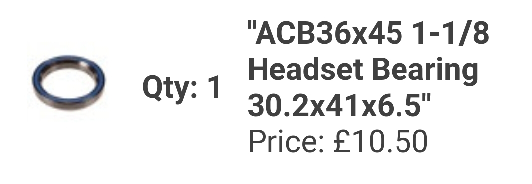

Ended up ordering these..
ACB518K 1-1/2
MR136 1-1/4
thebarber
May 28, 2018
986
598
Norfeast
bottom one fits, top one doesn't.
ordered this as a
552K
