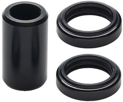

That reminds me to order shock bolts etc
There's a choice of shock bushing 20 or 22mm
Any ideas?
Bikes not handy.

Shock bushing for the lower eyelet?
Rockshox use 1/2" same as Fox
