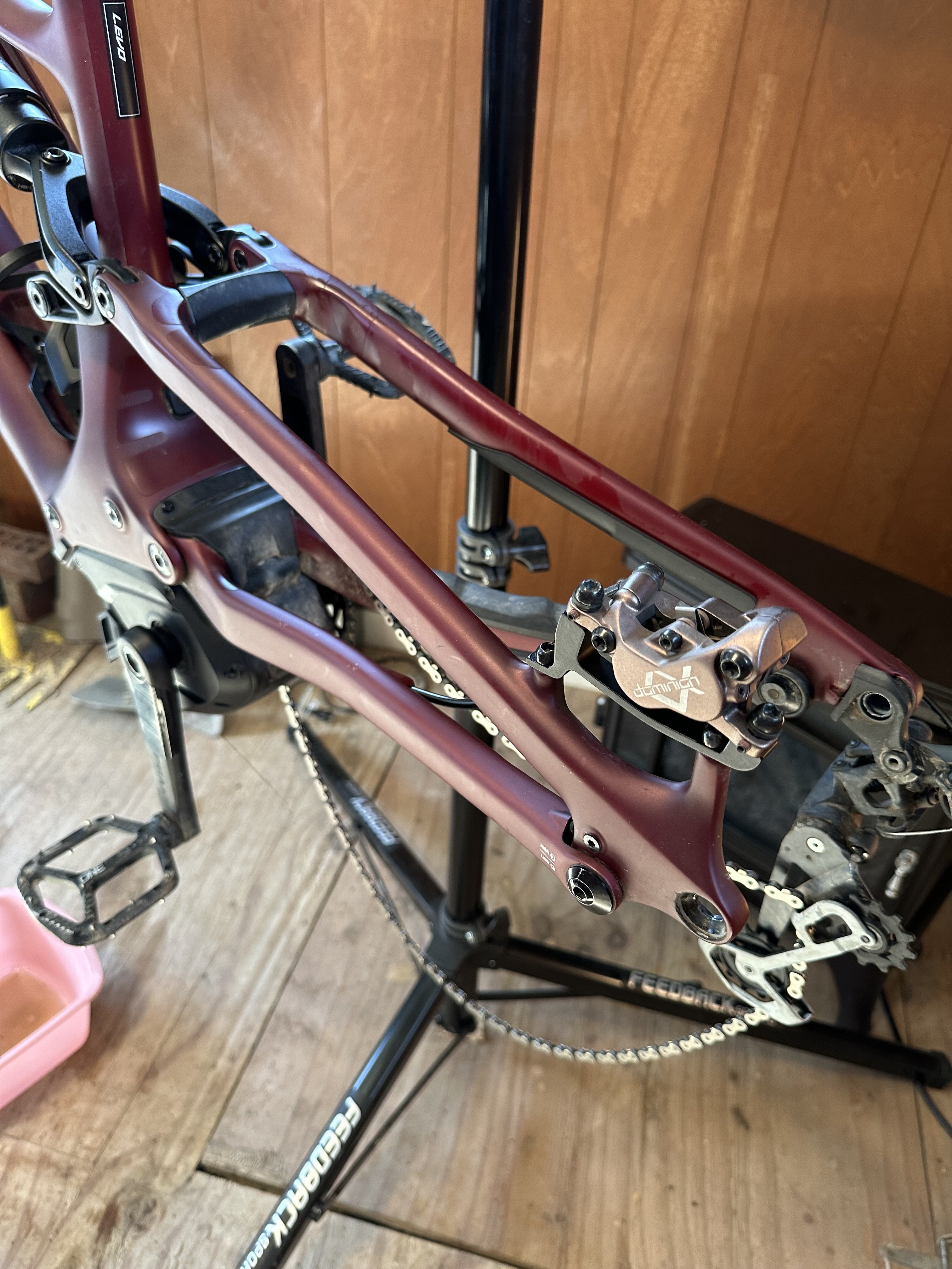

Just thought I’d chime in on my experience with putting Hayes dominion A4 brakes on my 22’ gen 3 turbo levo. I had zero issues pushing the thicker brake hose through the internal routing from the rear of the bike to the front. I’m not sure it made too much of a difference, but I also used the park tool brake hose routing tool so someone could help me pull as I pushed. I also put some slickoleum on the first 3 or 4 inches of the brake hose to reduce friction. Smooth as butter. No issues at all.
I need to chime in with my experience as well. I spent two nights struggling with that Hayes rear hose and independently came up with a nearly 100% identical approach. I started with Reverb barbs and spare brake hose, then eventually went to the Park internal routing kit and Buzzy's Slick Honey. "Great minds" think alike and all that.
That said, no matter how much I tried, how much slick honey I used, or how hard I pushed and pulled (I used a jagwire needle driver tool to get a firmer grip on the hose and wrapped the park wire around a wrench to get a firmer grip on the wire) I simply could not get the Dominion A4 hose to clear the chainstay on my 22' Gen 3/S3 Turbo Levo. I even tried deflating the air shock in the hope that a different angle of the swingarm would help pass the hose. No luck. I finally gave up on the factory hose and ordered a Jagwire hose/adapter kit.

This was my experience also. I’m sure that there are some Levos with different diameter tubing, but do yourself a favor and have the Jagwire kit on hand if you’re planning on the A4s. I should have just bought Hope instead for easier install, although I do like the A.4s now that they’re on.
