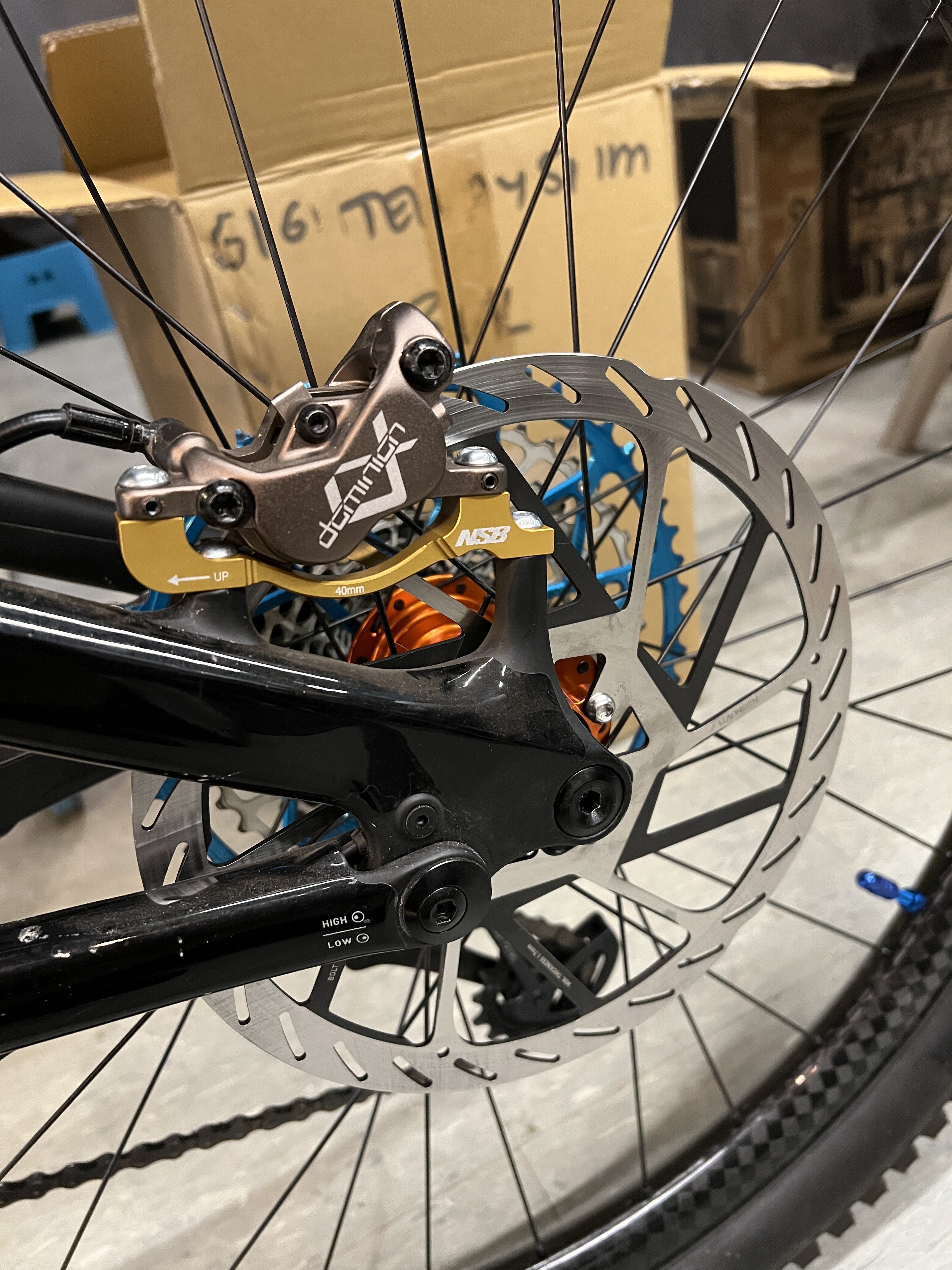

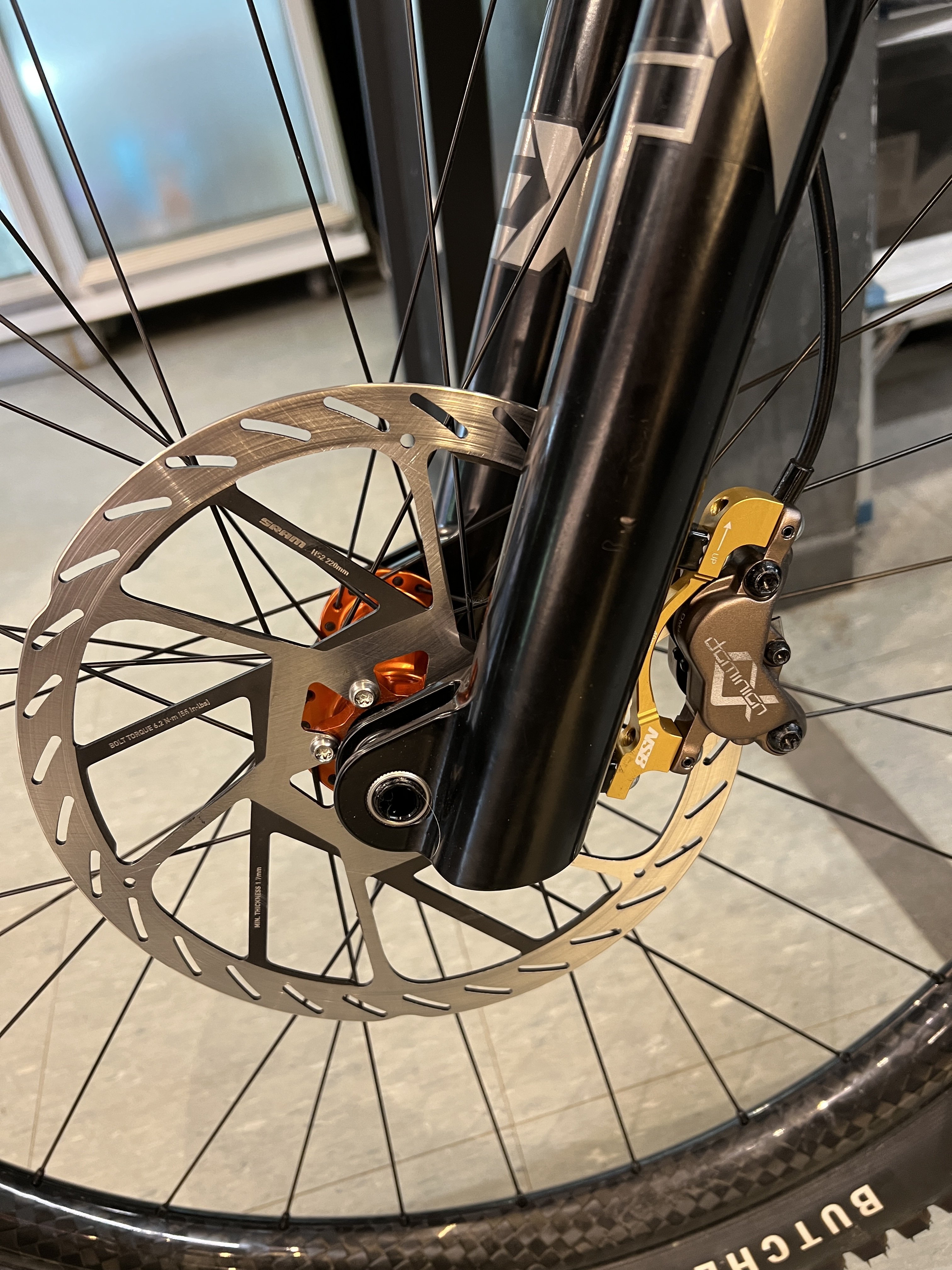

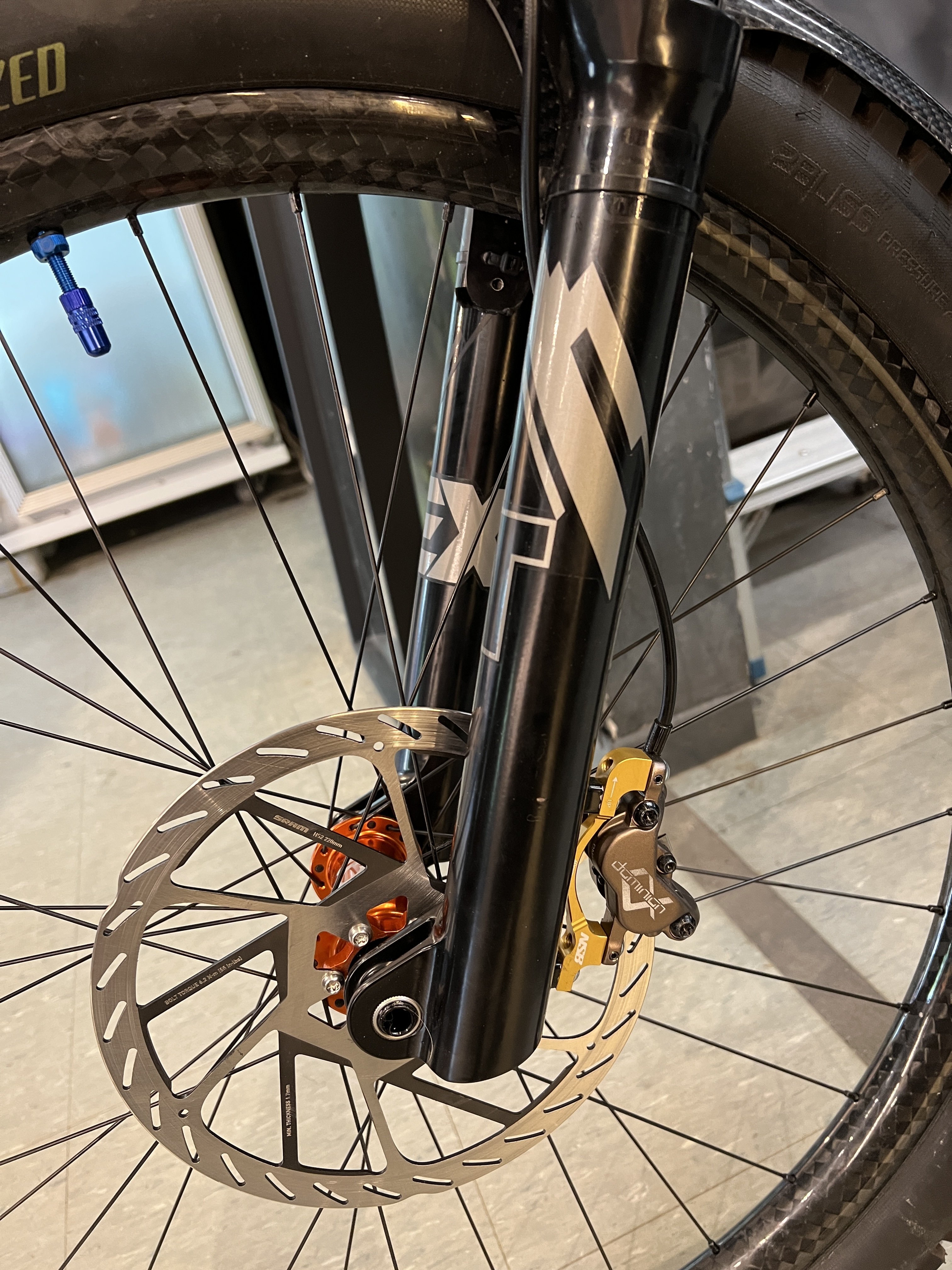

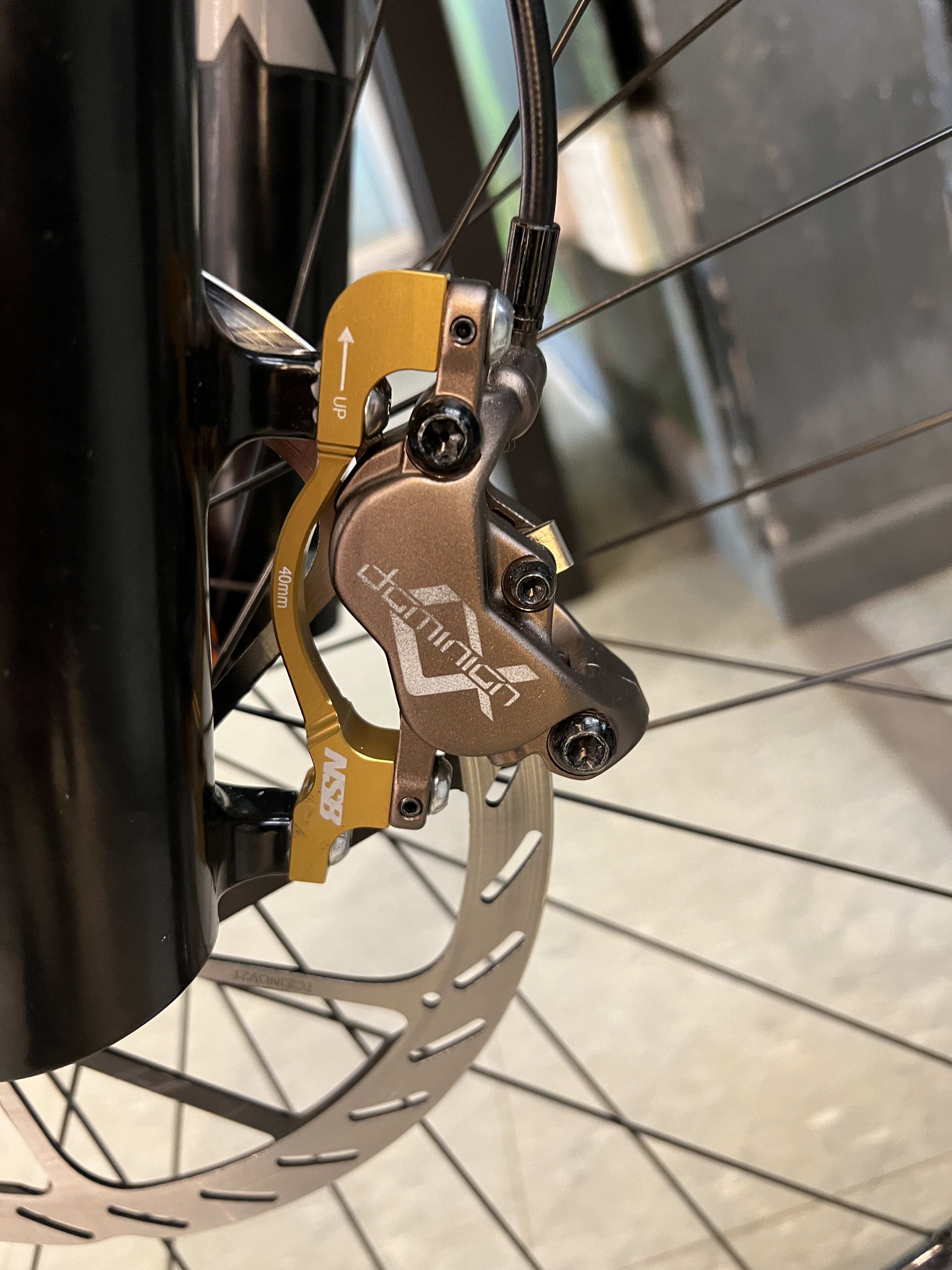

xiaochew
Feb 8, 2023
22
Singapore
Hi. I’m using dominion a4 with 220 sram roto.r. Hope it’s help u.

xiaochew
Feb 8, 2023
22
Singapore
I had no trouble removing my Hayes Dominion brake lines on my KSL. Yes it was firm putting them on but it stands to reason that the force to remove shouldn't be greater than the force to install unless something else was at play eg you damaged the hose outer on installation. Your blanket statement saying they aren't usable on the Specialized frames isn't correct.
mine work too . not issue and i install on sl than transfer to levo gen 3
