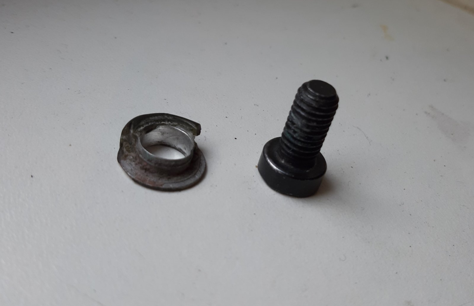

I had the exact same motor mount break off after about 700 km.
There is no carbon around that bolt hole. It looks like it entirely consists of that epoxy resin or whatever they use in making frames.
I was super surprised to discover that the rear motor mounts are so tiny and slim.
Currently waiting after the reseller to hopefully get a replacement frame.
Third week since I reported the issue - they still say they are waiting for Cube to respond back to them....

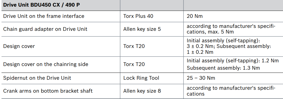

bosch gen 4 (CX and cargo) should be torque at 20nm on the frame
bonzi1994
Aug 10, 2020
italy
See I've seen different figures to those and was told different by a Cube dealer. Where did you get these figures out of interest?
bosch private area for dealer on their website, 30nm is for bosch gen 3(active and performance line)

Presumably assuming ally frame. Will be different for carbon? Motor mounts on the ally Levo/ Brose motor are 18nm

To state the obvious a bolt does not come loose for no reason. A bolt subject to vibration should be thread locked......most low torque bolts should be threadlocked. If they come loose they were probably not threadlocked in the first place or the bolt was not clean if it was. Either way, just tightening the bolt will only yield short term results. Once threadlock is disturbed it is no longer effective. So the bolt should be removed, cleaned, and fresh thtradlock applied.....and left for 24 hours to create a proper bond.

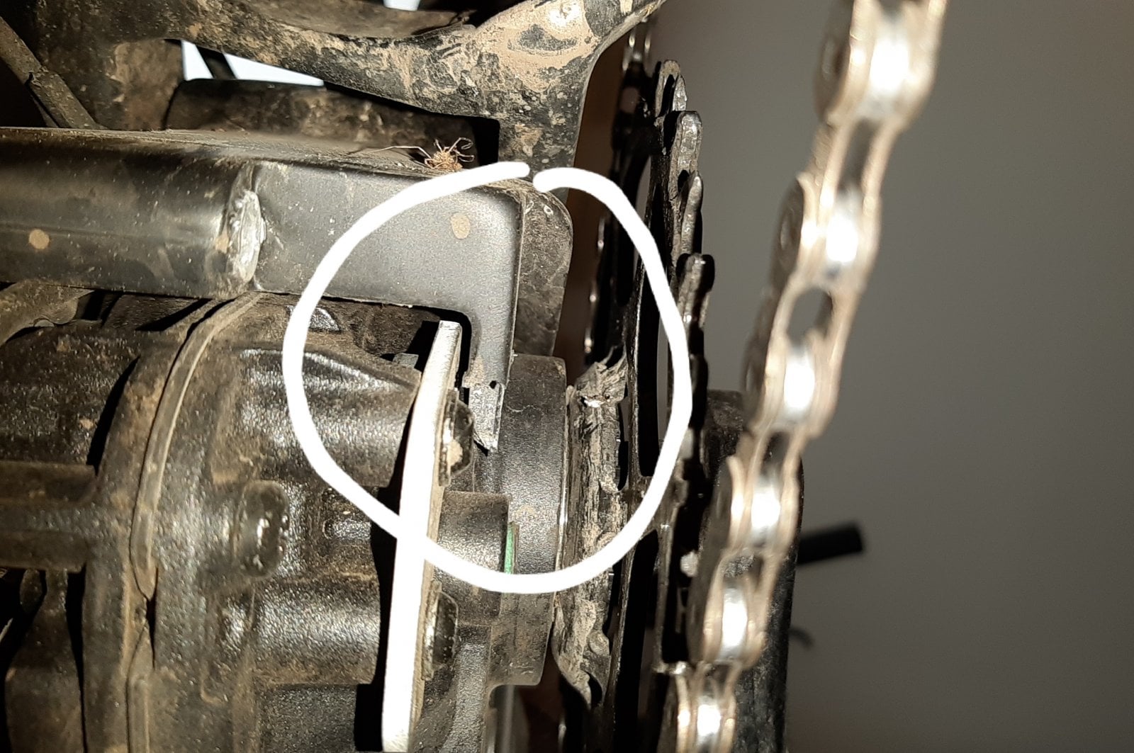

My creaking is resolved now that the smaller pentalobe bolts that hold the brackets onto the motor were tightened but they had come loose as well as the motor mounting bolts.
Pretty sure there was some kind of threadlock used since there was residue the first time I get those bigger TP40 bolts out.
The bolt that came loose was the right rear TP40 bolt so I wonder if that eye snapped off for Tartu was also damaged with mine :/

Hi @Phal44 , am I right in thinking you're still riding this bike with that busted up motor mount? Like, I'm not wanting to criticise but I really think you should get some help with this before you have a catastrophe. I just skimmed back over your posts and I'm a bit worried your either gonna have a nasty failure crash or a big bill (or both) heading your way if you carry on as you are.
Don't bury your head in the sand dude. If it's not right you need to get it sorted, one way or the other.
Don't bury your head in the sand dude, if it's not right you need to get it sorted one way or the other.
It's not busted per se but you can see it's not quite right. I'm not really riding it on trails atm either, just a short commute to work since that was also what I bought it for :/ It's not in danger of failing since the other 5 bolt holes are still fine.
That being said, I definitely don't play to use it like this forever. Can't believe Cube haven't been able to get back to me yet.

Photo of rear engine mount that snapped off. This thing would not be strong enough even for a city bike. Let alone a 160mm "enduro" weapon.
I also discovered that my frame appears to be about 1mm wider (than engine brackets) at rear mounts, so when the mounts are tightened, it squeezes the frame. Have not dismonuted the engine to double check this yet...
