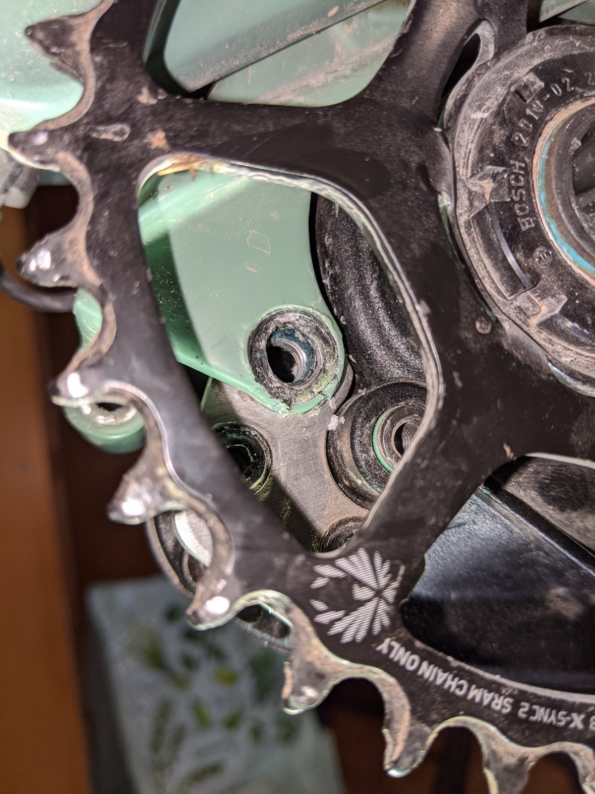

I recently bought a Cube Stereo Hybrid 160 and as per some discussions in other threads, I've started experiencing issues with this bike (250 or so miles done).
I've been trying to get in touch with Cube for some assistance but this is proving to be difficult since they can't manage to receive all of my emails. This is starting to get pretty frustrating as the most I've gotten from them in over a week is emails telling me to send the details again. They get my emails asking for an update but not any with my details it seems...
My issue has developed over the time I've had the bike. A creaking developed gradually and it was coming from somewhere near the bottom bracket. The creak gradually got more frequent and a little louder and my research online seemed to point to loose motor mounting bolts.
Once I had obtained the relevant torx plus 40 bit and torque wrench (topeak digital torque wrench), I checked each of the 6 bolts and found the most rear right bolt to be very loose (I would have been able to tell this by hand if I could have reached it better sinceit was the bolt behind the cog on the cranks). I torqued this to 22nm initially as I'd found a few different figures for Cube bikes online and this was the lowest but the creaking continued.
Last weekend, I spoke with someone at Hargroves Cycles to verify the correct torque for this bike/motor and I was advised that 30nm was recommended by Bosch.
I removed each bolt and re-torqued them to 30nm but the creaking continued.

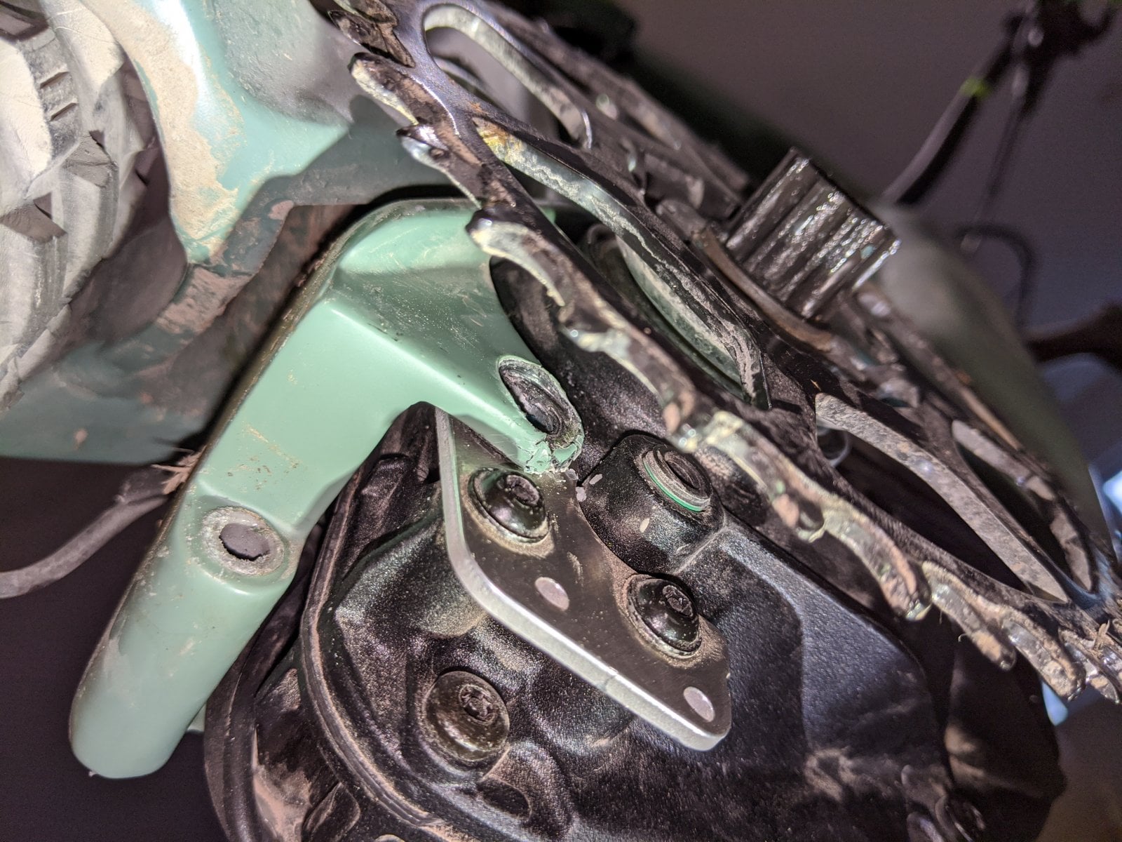

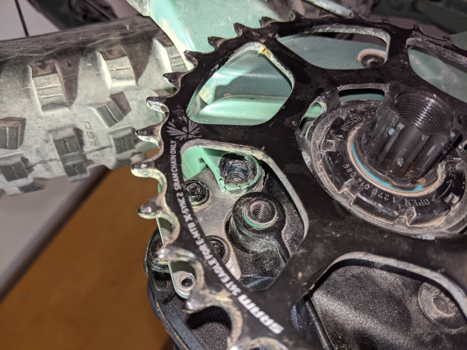

As a last attempt to fix this today, I removed all the bolts and lowered the motor out to a platform under my bike in its work stand. I cleared around each of the motor mount holes to remove any dust/dirt/sand etc. I put the motor back in place and started tightening the bolts with my torque wrench.
The same bolt that originally got loose was making a few crunching sounds. I stopped tightening and removed the bolt again to find the area around the bolt hole seems to be getting crushed. The paint on the frame around this is all cracked. I feel if I keep torquing the bolt then it will just crush the carbon fibre further.
Not looking good!

No real locking nuts on this motor - just 6 straight bolts with Torxplus heads. I figure the reason my bolt came loose in the first place is maybe that the carbon around the bolt hole was never 100% and that allowed the bolt to loosen (The other bolts seemed fine when I first checked).

Try the lock ring nut that holds the front sprocket on mine and a load of other people have had there's come loose but ya that frame on yours don't look good at all I'll be sending photos to the shop and be asking for a replacement bike or a refund

With reference to your bolt I cannot imagine the toque setting on carbon would be as high as 30nm. The bolt only needs to support the motor with no play so no reason for it to be high torque.....it should however be threadlocked. That bolt is certainly never going to be secure given the damage to the carbon seat so at the very least that section of the frame will need to be replaced...if indeed it is a removable section. If not it is a new frame!!

Look that's major damage, screw the bolts to the official Nm guidelines and ask for substitution under warranty.

It is something worth checking however. I suspect a blob of epoxy was left on the seat where the bolt head sits. That or the seat was badly formed. Subsequent attempts to torque the bolt have effectively destroyed that seat...or the walls of the recessed seat. The lesson may therefore be not to attempt to tighten a bolt that comes loose without first totally or partly removing thr bolt to inspect the seat on which the bolt head sits. Any uneveness could probably be made flat. The bolt would then torque properly. I still doubt it is as high as 30 nm though!
