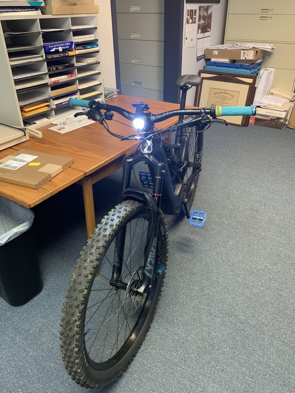

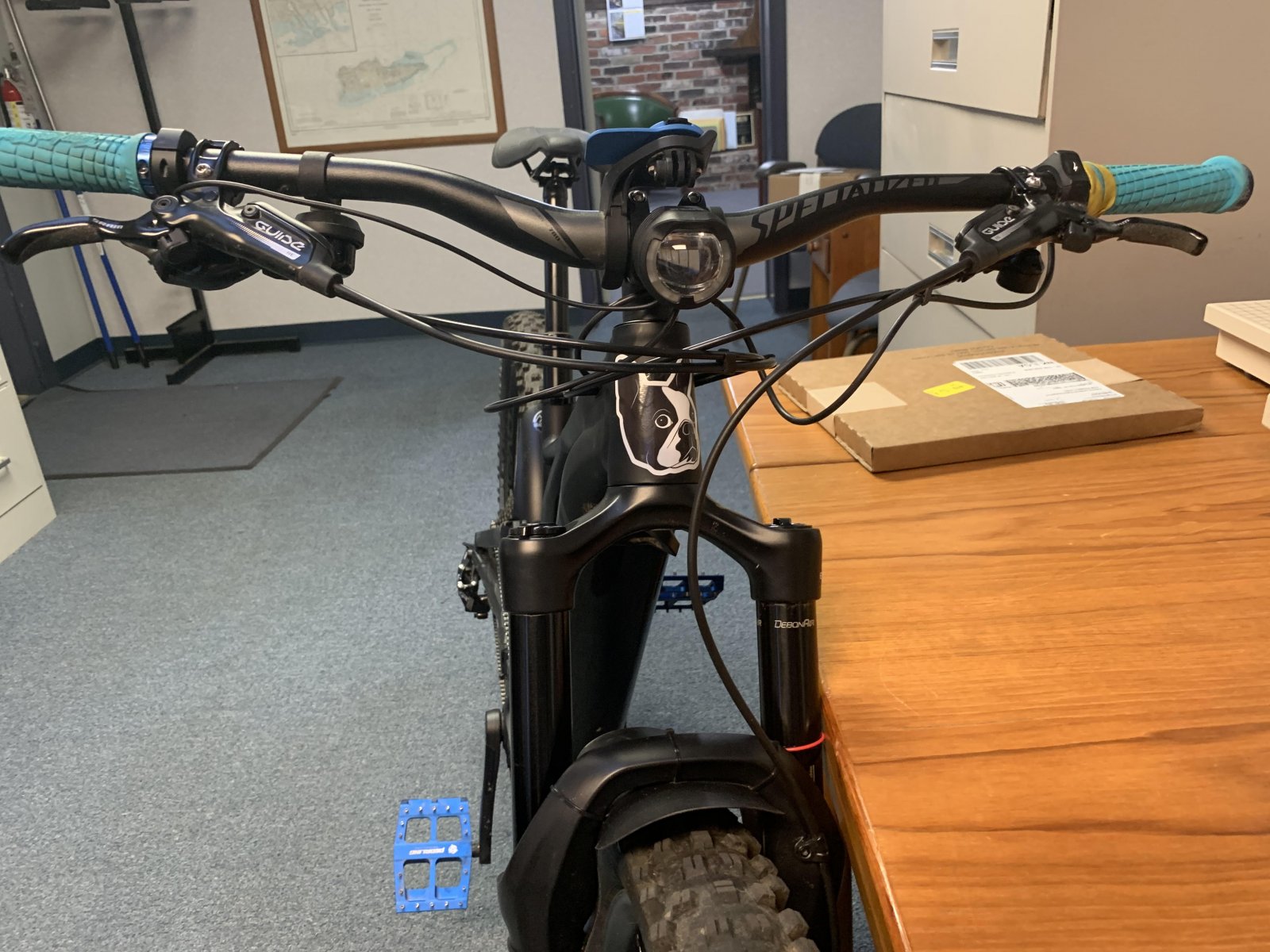

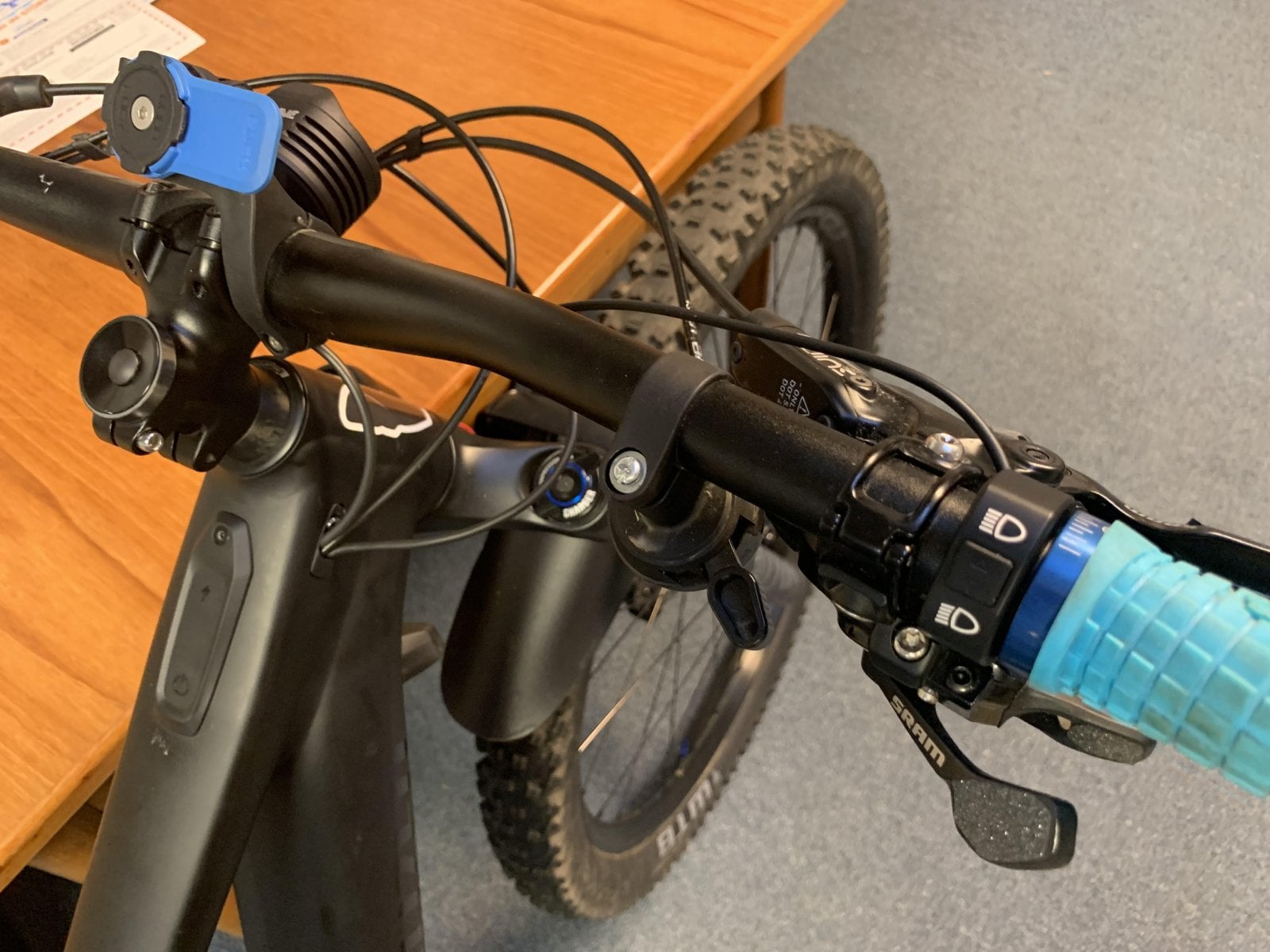

I just installed the Lupine SL-SF hard wired headlight on my 2020 Levo. After a couple challenges it is working perfectly and is an elegant solution.... Fishing the cable through the frame, which has a couple choke points, caused us to damage the connector. I happened to have a spare cable and after talking to the folks at Lupine we cut the original connector off and put a new one on. It worked perfectly. They are having some issues with the 2020's and the SL-SF light and I suspect this might be the cause of the problem. The light is perfect, makes a ton of light, and is easily controlled on the handlebar. If anyone is interested in installing this light, reach out to me directly and I'll give you some tips that will make the process easier.

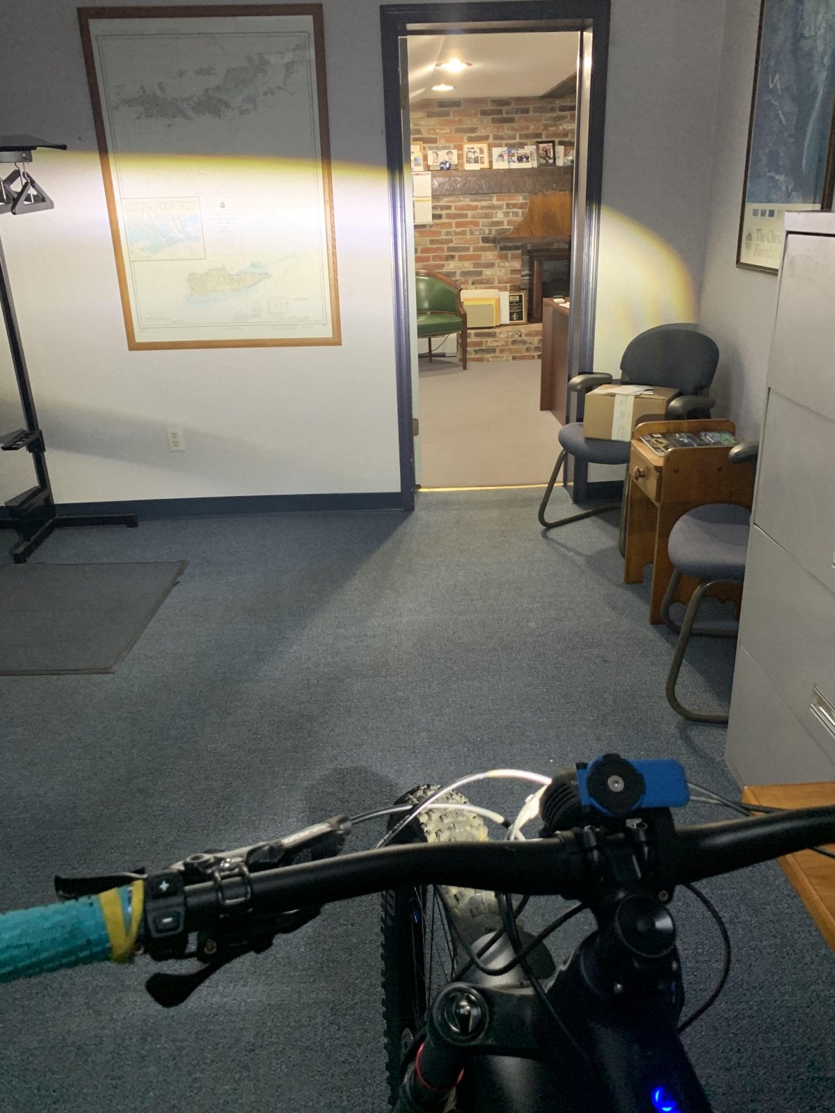

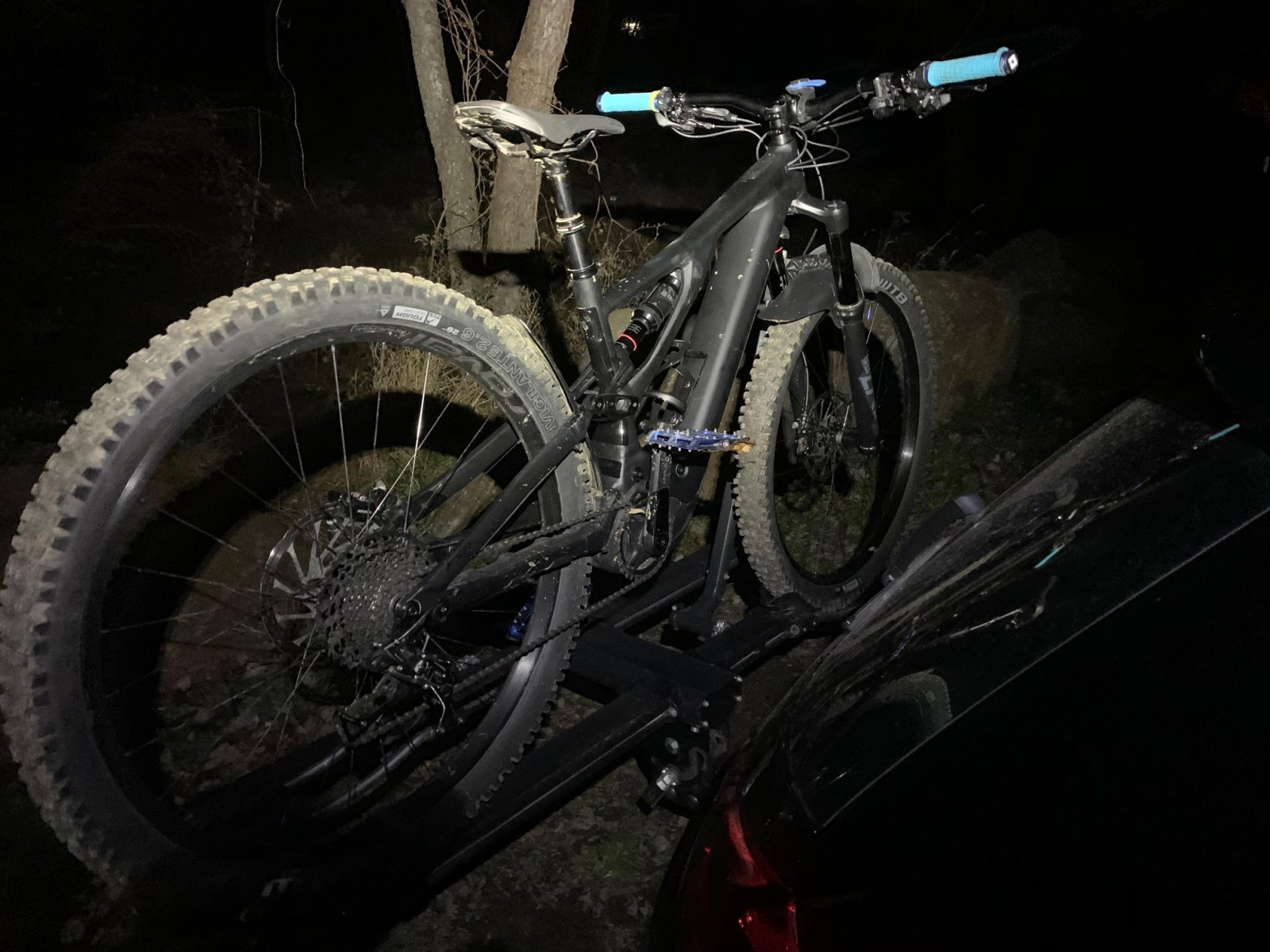

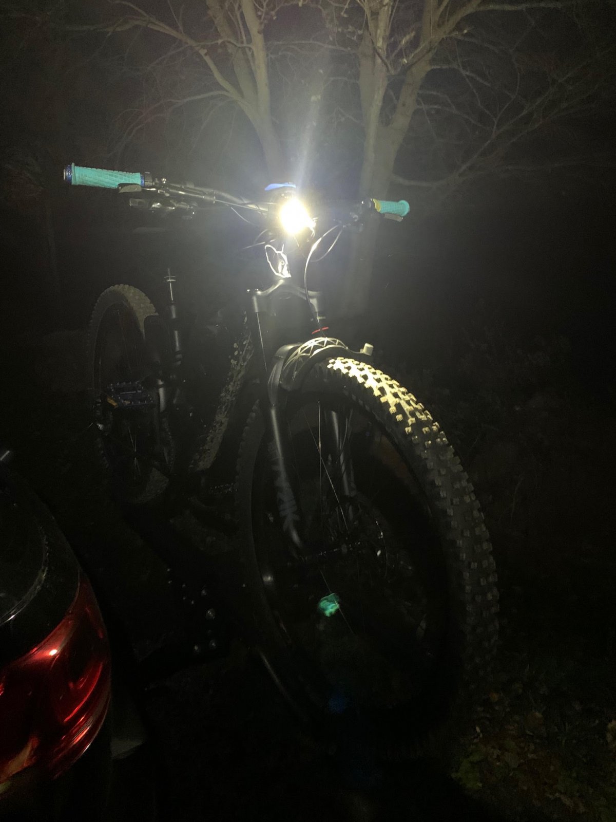

I took my inaugural night ride with the Lupine SL SF system tonight. Worked seamlessly, plenty of light, though not quite as much as my $400 Serfas True 1500+ system.... Started out with a little light and the light automatically ran as DRL, then as I got into the woods, it automatically switched to Low Beam.... switching back and forth was really easy with the handlebar controls... So much better than having to remember to charge and install the Serfas system, and having the opportunity to end up unintentionally riding into dark, which is very easy this time of year. I give it five stars!

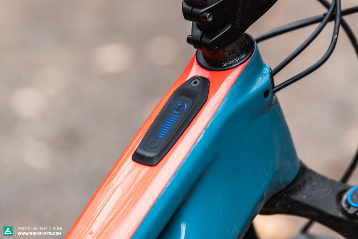

Does anyone know the size of the bolt for the cable entry port by the TCU? Is there a trick to getting it off?
I finally got my Lupine light delivered and managed to get the cable fed through the frame, but I can't seem to get that bolt off to feed the wire through the frame.
Loosen the motor mount bolt

What do you mean? Do you have to apply too much force and are stripping the bolt? The Bolt should only be tightened with 1 NM according to Service Workbook.
It must have been assembled with too much force because it definitely doesn't want to come up and it's getting stripped.
I ended up just cutting the cable in half, pushing it through, then splicing it. That worked fine.
I'll take it to the LBS to sort out why that screw is stuck and get some new ones.

The hex is small and the bolt head is wide. Lots of friction there. Easy to strip the bolt. I did it too. Be careful.
