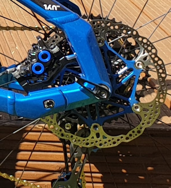

If it helps I have the floating Hope 220's with MT5's (running the individual MT7 pads) and the setup works great. No issues with fitting.

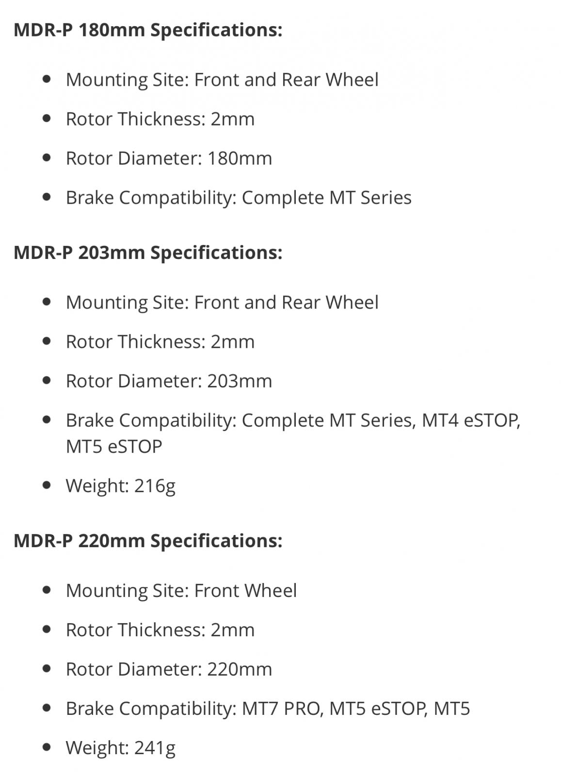

MrSimmo
Apr 24, 2020
1,096
1,047
The Trail.

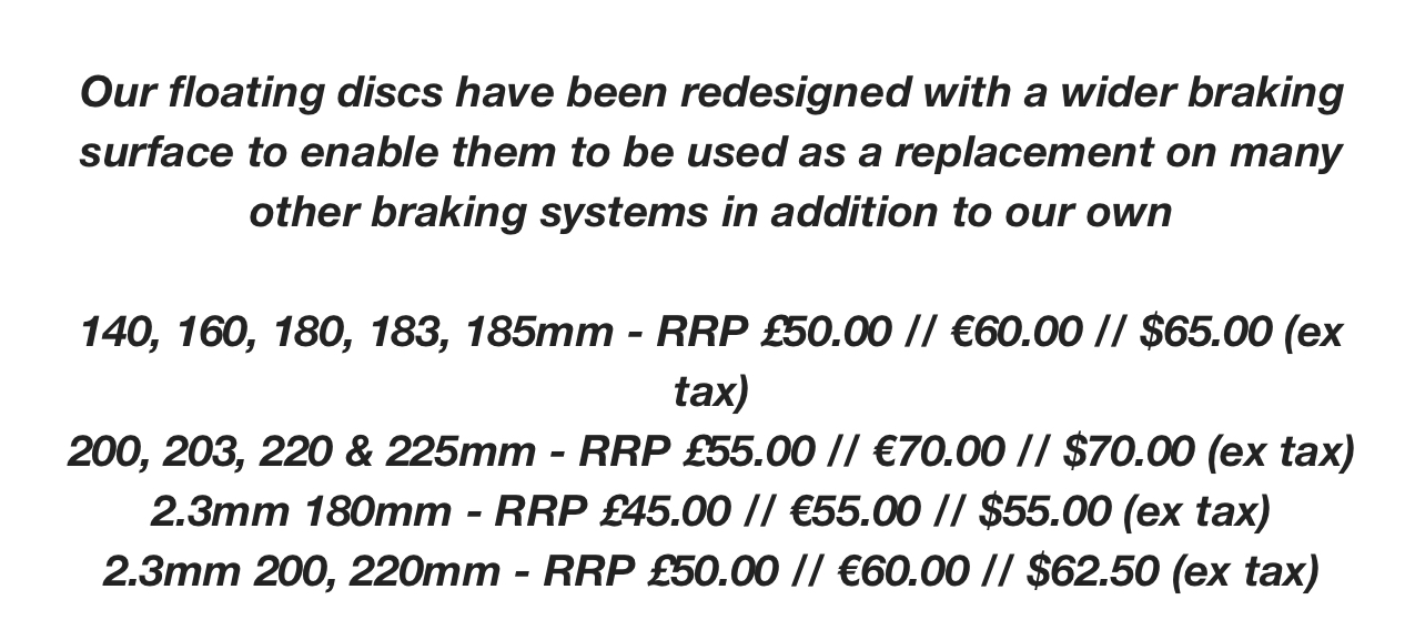

The rotors are very similar in thickness (2mm for Magura MDR-P and 2.3mm for Hope Floating Rotors).

I think you will find it's the other way round...? Actually, I thought the Hopes were 1.8mm...
from the respective websites; Hope seem to make 2 varieties:

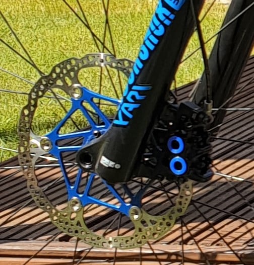

Nope, no filing. although from memory the bobbins are pretty damn close to the spacers. No contact whatsoever though, at least on my bike.
I'm stuck between them and Hope Tech 3 ATM. Did like the feel of the MT5 I felt the other day...have to post a pic of yours if you get chance 👍🏻

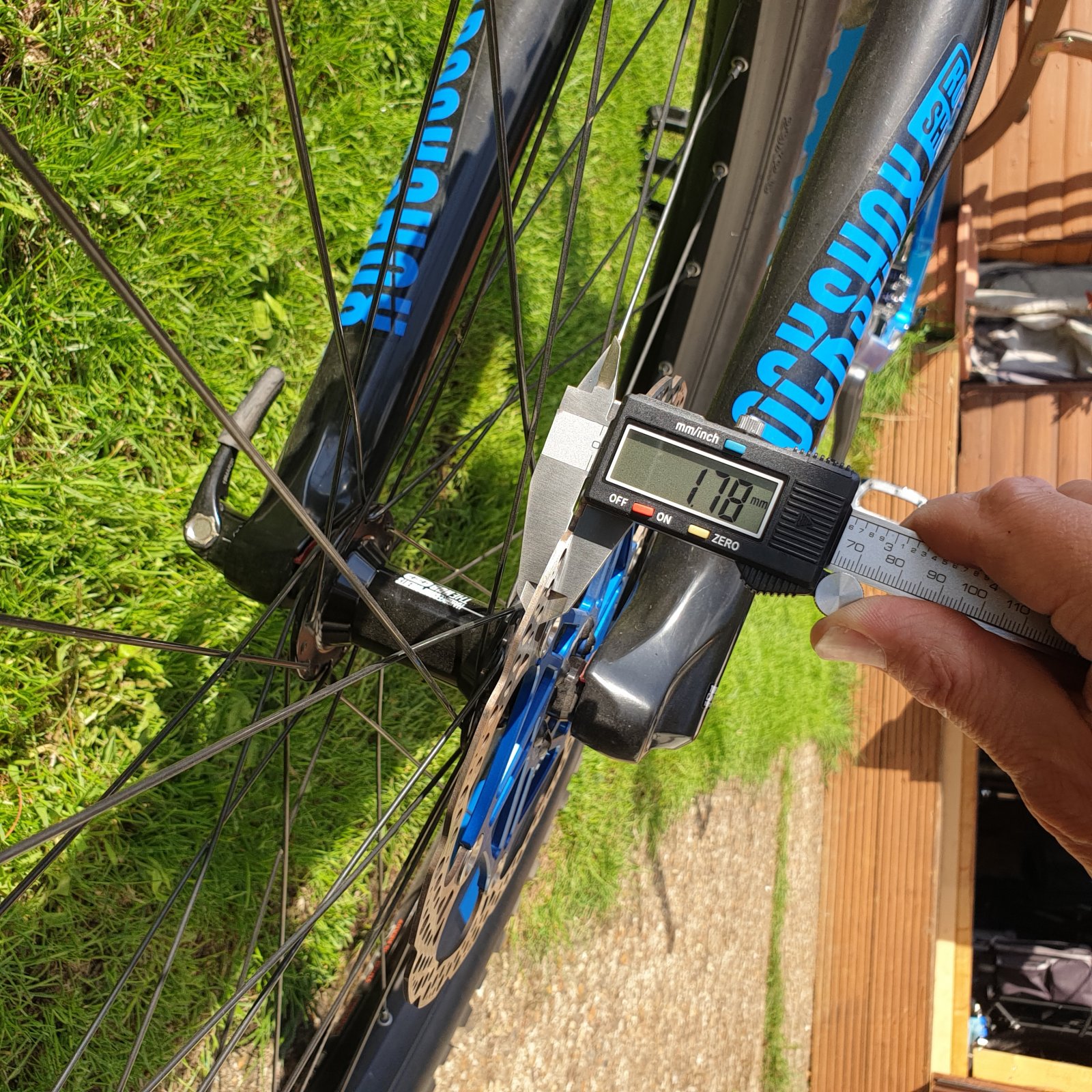

I'm fairly sure the hopes are indeed 1.8mm. I'll measure mine later. I suspect that the image posted by shockwave isn't particularly accurate given the jaws on the mic seem to be slightly open, although might just be the angle of the pic.

Agree, the calipers
The measuring calipers do appear to be slightly twisted.

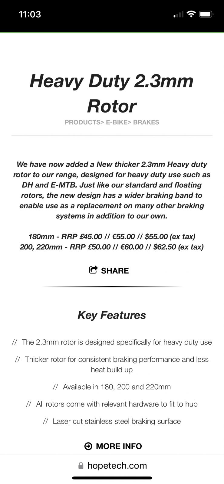

Rickster
Feb 19, 2022
364
493
Ok BC Canada

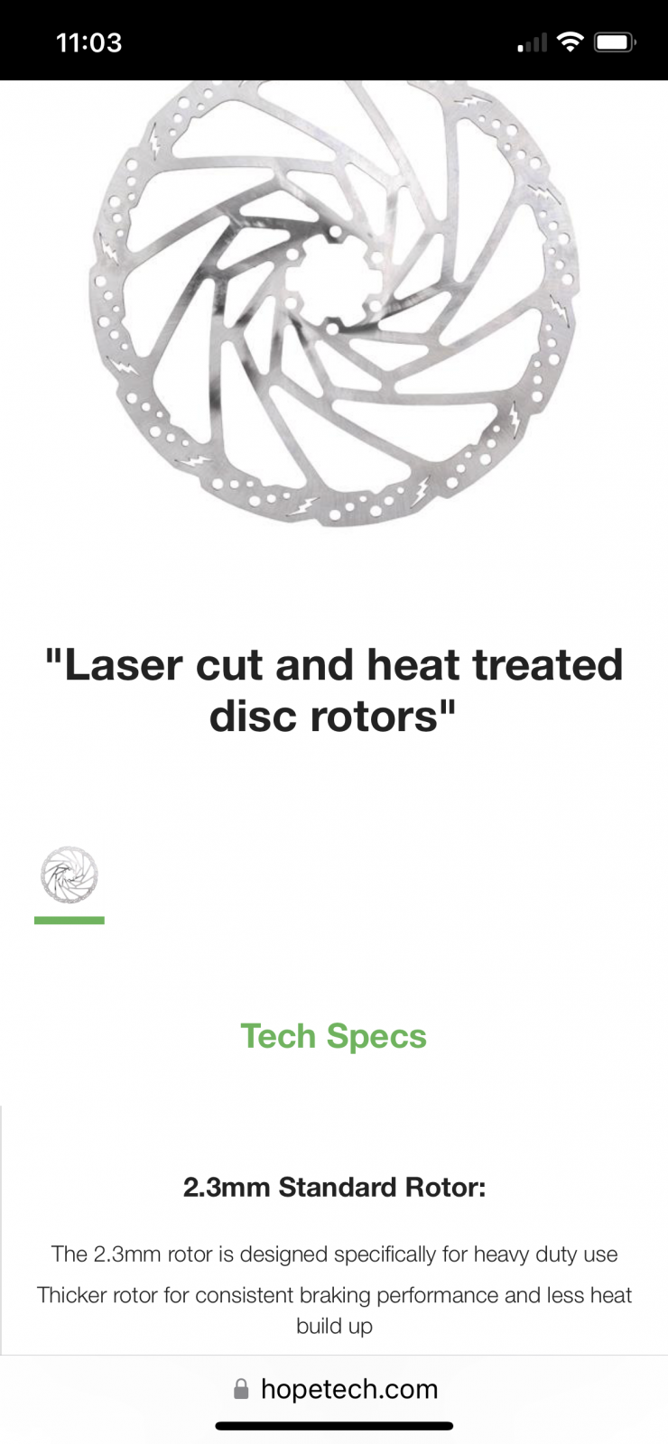

This doesn’t make any sense, there seems to be contradictory info out there on the Version 4 Hope rotors. According to Hope these new rotors are specifically designed for ebikes and as such are supposed to be 2.3mm thick. Having said that the version 4 full floating are…1.8 !? 🤨

cozzy
Aug 11, 2019
933
1,042
Hampshire UK
Where is the confusion?
floaters - 1.8mm
vented - 3mm
fixed heavy duty rotors - 2.3mm
fixed rotors - no idea 1.8 or 2mm maybe?
The main problem is hope not publicising the rotor thickness of any rotor bar the heavy duty one :sneaky:

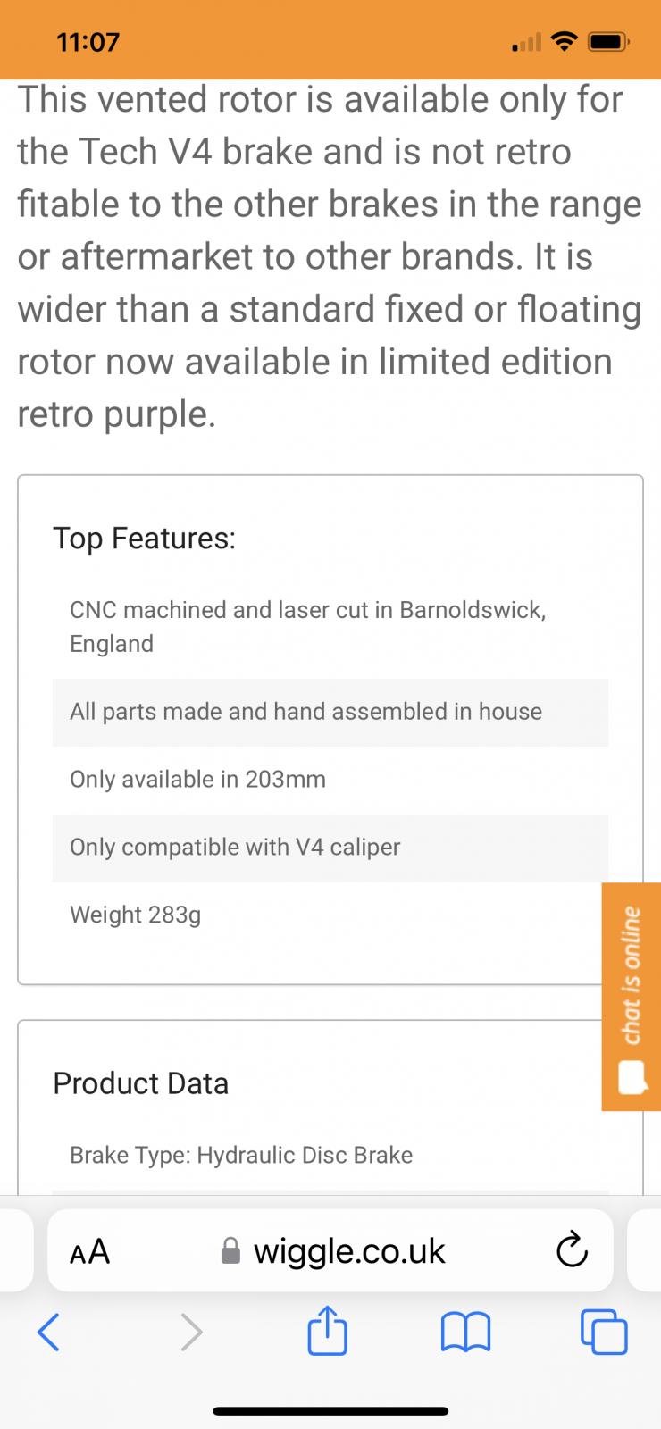

Directly from Hope
“ The vented discs are 3.4mm thick and suitable for the V4 caliper only, these are available in 203mm or 220mm.
Part number for a 203mm vented disc in black is HBSP4342036VN “
😳 This is clear as mud, I guess I won’t be purchasing ANYTHING from these incompetent idiots. 🤨
