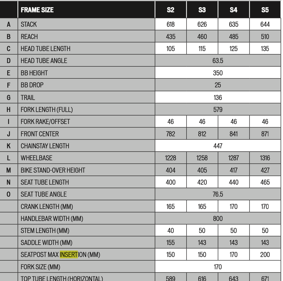

Are you sure on an S5? Mathematically it should have 230.
Sorry wrong frame size

Nope, because 180 Oneup dropper has 267 insert length and KSL max. insert is 200
Actually it has 252 max insertion.
210 = 282 insertion.
The measurement above was 110 over seat collar with 210 oneup and S3 frame.
Should actually be 132. So I guess actual max insertion is a bit more than what geo chart says.

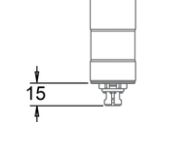

You obviously didn't count that? View attachment 86881
True. Didn't count that. My fault.

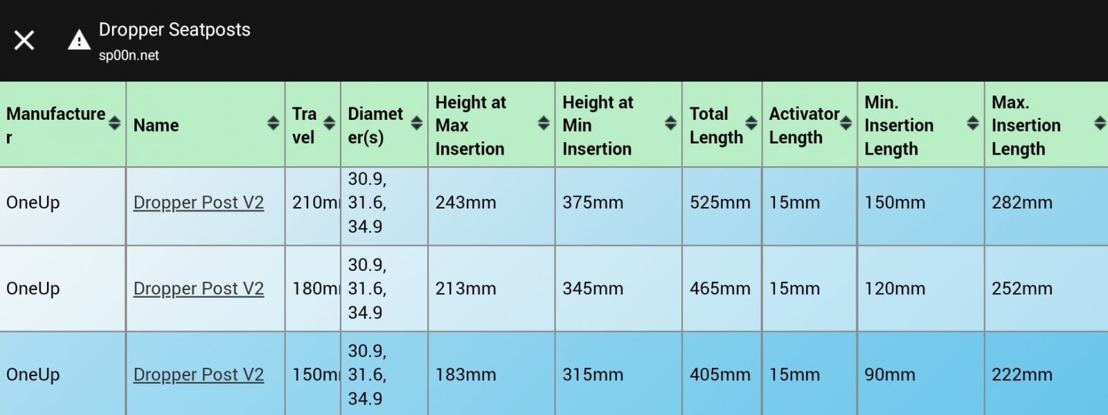

110 over seat collar actually is around 100mm in his photo - with 210 one up this actually means 297 insertion length including the actuator - 100 = 197 inserted into an S3 frame. Wow. That's 47mm above geo chart.
Can anyone add more reallife measurements to this thread?
The calculation above would suggest the 180 would almost sit snug inside an S5 frame, being 3cm shorter top and bottom, leaving only 2cm exposed for a total height of 243mm above seat collar Max. Don't know if this will be enough.
Think I'll order a 210 and a 180 and try it out. 210 adds at least 4cm total height fully extended when shimmed to 190. This (283) might be too much on the other hand.
Reverb AXS 170 would be interesting too. 245 insertion isn't too bad and would sit snug inside S5 frame. Having no actuator max insertion into KSL frame might be lower though. Don't know how tight things are down there 😅.

I have a 210 shimmed to 200 On an S3. From the top of the seat collar to the center of the seat rails, measuring inline with the center of the seat post, is 325mm of exposed post. The seat post is inserted as far as it will go into the seat tube. If my inseam were any shorter I would have to go to a 180 post. You should be able to measure from the top of seat clamp to center of seat rail as your bike is set up now. If you have less than 325mm the 210 won‘t work for you.
