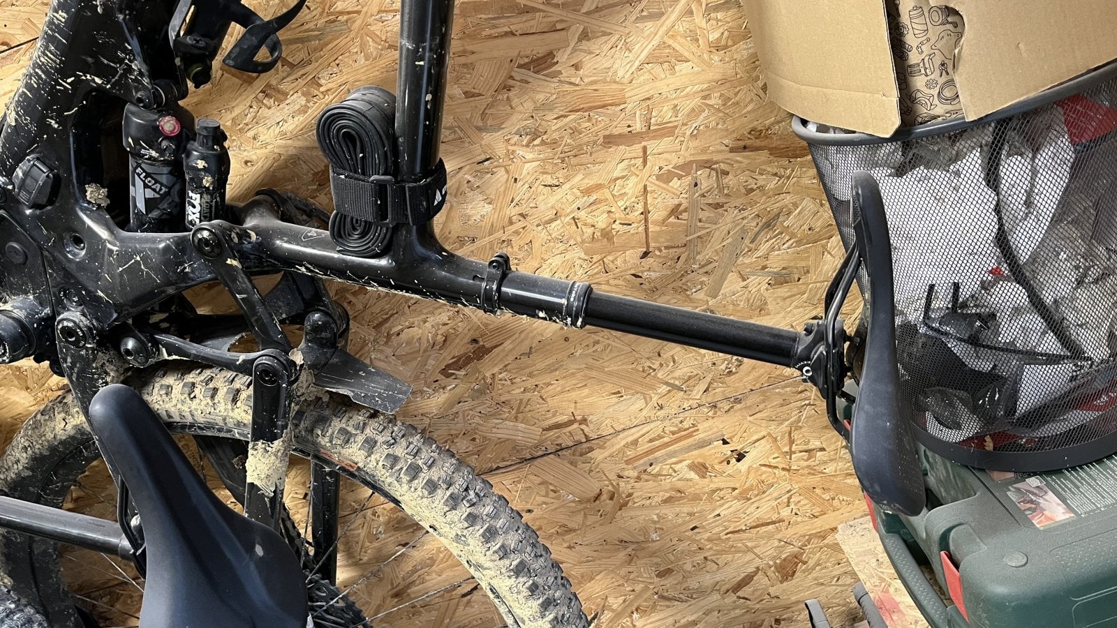

Waiting for the pic
Oops. I forgot. I’ll do it today.
Endoguru
Aug 21, 2019
142
131
Usa

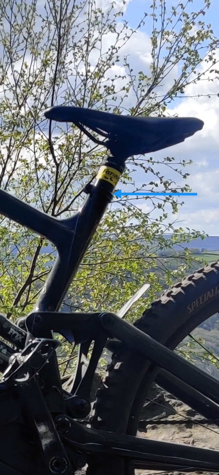

Here’s the pic for those that want it. This is a OneUp 210 shimmed to 200 on an S3 frame. There is 110mm of post above the seat collar. It is slammed as low as it can go. You should be able to determine from your own measurements using the online calculator from OneUp if this will work for you. I’m long legged, short torso. My brother who is the same height as me has a one inch shorter inseam so he can not make this work. He would have to go down to the 180mm post. That is still much better than 150mm drop. Once you have a dropper that is 200 or longer, any less starts to feel to high.
