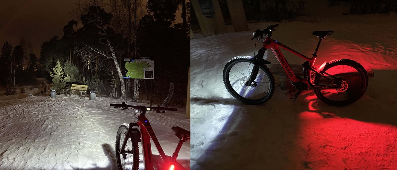

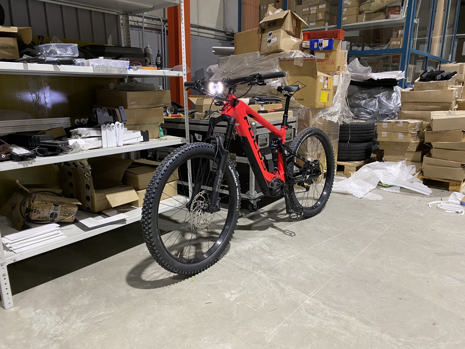

I installed the headlight SUPERNOVA M 99 Pro on my bike. Near beam 16 W, main beam 32 W. 24 volts. I had to connect to the battery directly. Installed DC \ DC converter AM50E-4824S-NZ (input 36-72 volts, output 24 volts 50 watts). Install the switch on the steering wheel. Be sure to fuse. Shines like a car. ))) It's expensive, but super shines.
After several days of operation, some additions were made to the headlight of the supernova. When the battery is almost empty, the spotlight flashes. Below half the load. Especially high beam. You should look for another DC / DC converter. From 30-32 volts.
