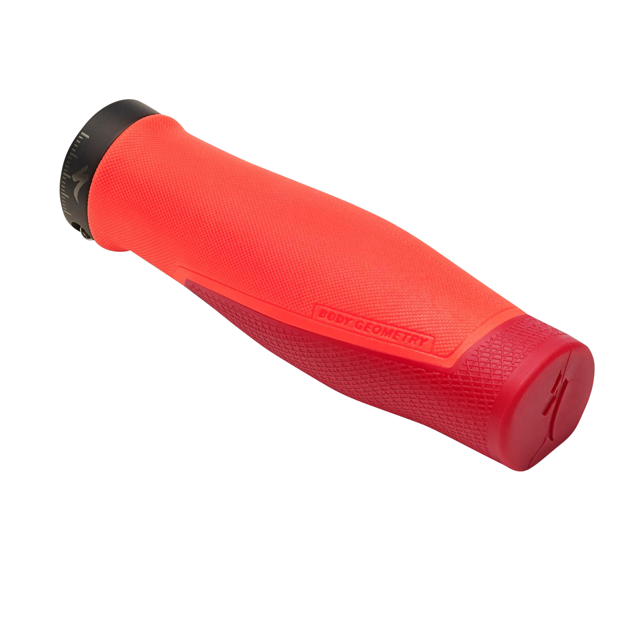

thurston
Jan 1, 2019
Switzerland
For my wife these solved her problems after months of trying and tinkering
"Specialized Neutralizer"
