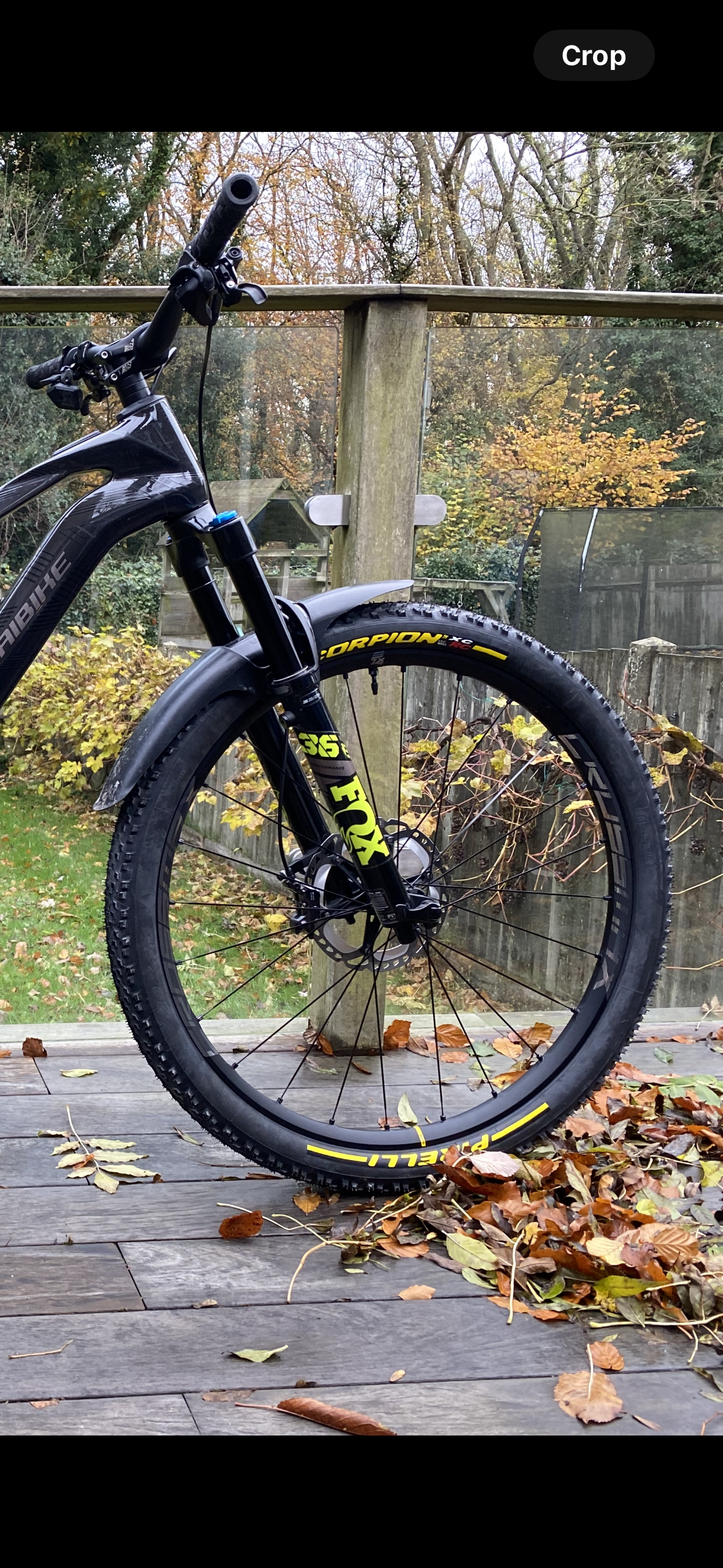

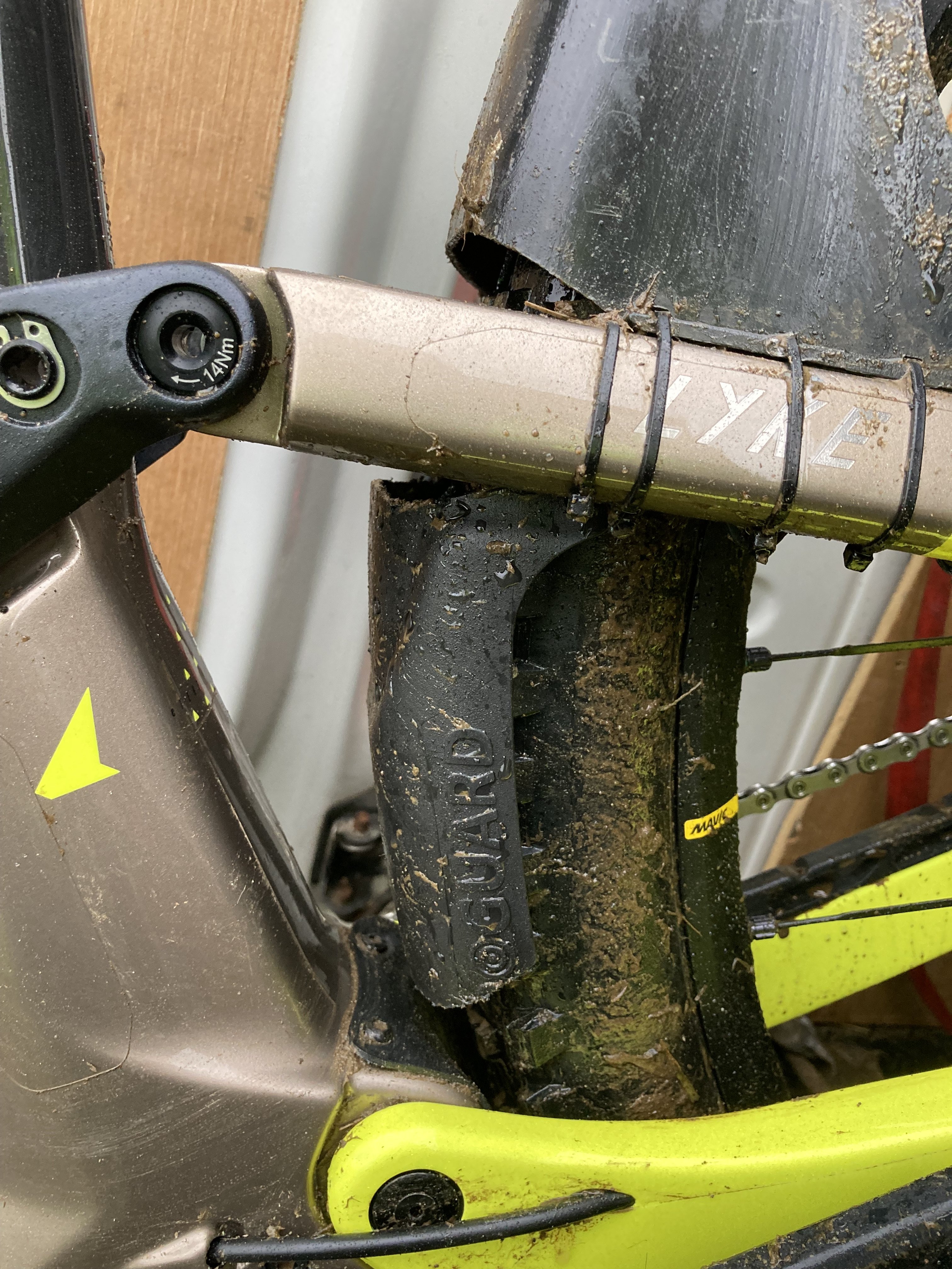

I meant I can't see zip-ties on forks at picture you posted. Thanks once more.
You can see the zip-ties on this picture on the linked Mudhugger website.

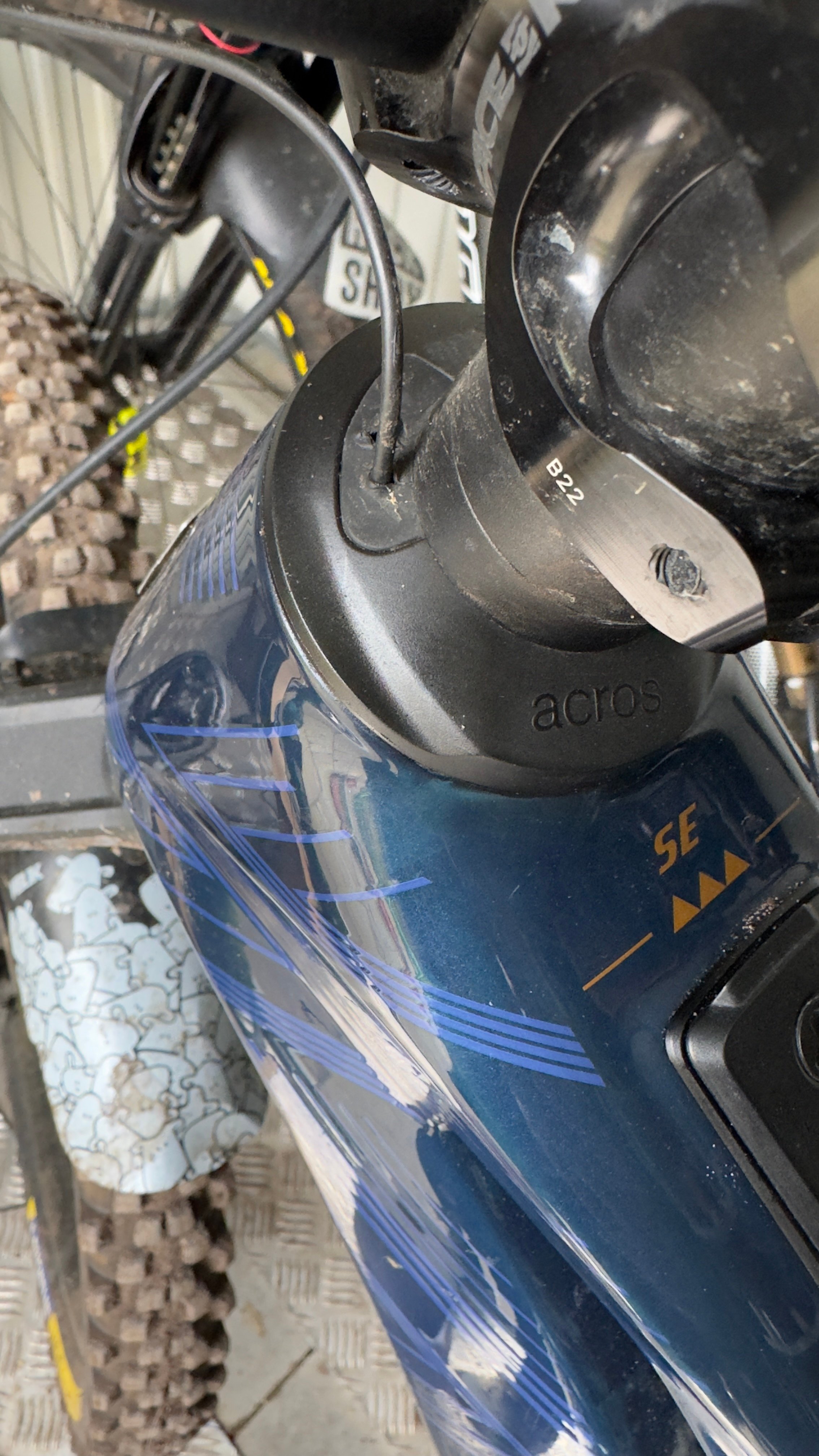

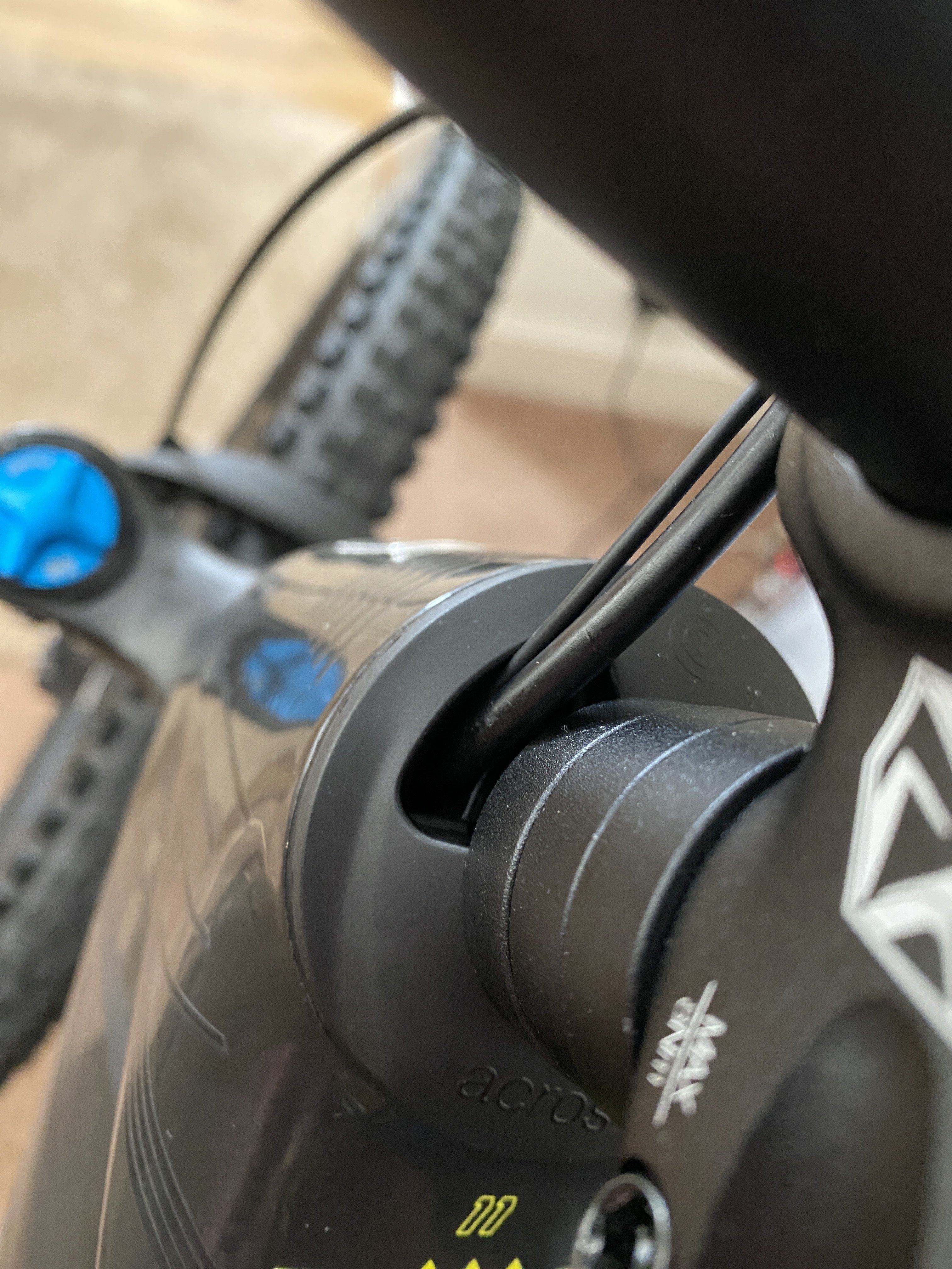

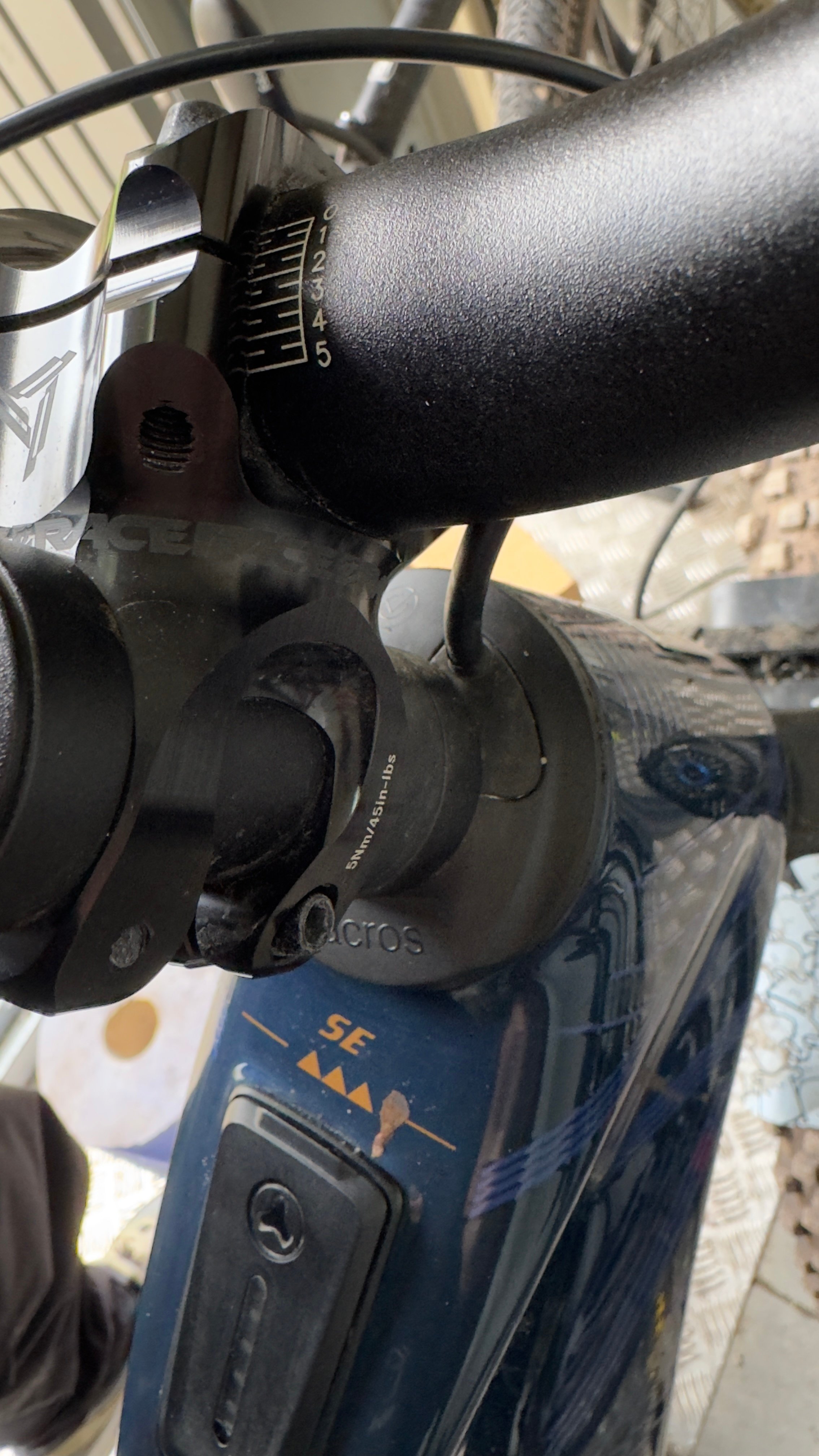

Does anyone know what the make and model number of the headset. Mine arrived without the left side cable grommet meaning the cables and the controller wire feed into a gapping hole (see photo). Perfect for lots of water getting into the headset and causing mayhem with the h/set bearings. Looks like it was missed by Haibike’s quality checks during manufacture!! Though how this was possible when the rear brake hose, the dropper post cable , and the Ring Controller wire should have been fed through the grommet is difficult to understand.
Blatantly poor quality control has to raise questions in my mind about the general assembly of parts of the bike which are hidden from sight!!!
So I will need to try and source either a complete top headset or the grommet only, if it’s available.

Oooh, Cnc, nice, mines coming next week with the old type fitted so I’ll have to see how it goes. The dealer has no idea about the updated version and doesn’t seem to believe me when I explain it, so I’ll just have to source one myself, not from Kinder obviously 😂
What is the updated version ? Do you have a picture and a part number?
That’s a bit strange. Mine has it. The dealer where you bought it should be able to get that sorted for you. Did you ask them?

That’s a bit strange. Mine has it. The dealer where you bought it should be able to get that sorted for you. Did you ask them? View attachment 135569
My issue is with the left hand side. The right side, as in your photo with one cable in a grommet, is just like yours. My left side has no grommet at all just 3 cables going into a slot where the grommet should be (see pic). How this passed Haibikes assembly checks beats me. I’ve contacted the dealer I bought it from and they are to contact Haibike (in the UK that’s Raleigh !). However, I thought I’d get ahead of the curve and contacted Raleigh direct to ask for the headset make and part number. And guess what? They don’t know. So how the dealer is going to secure a replacement grommet (or even a full upper headset assembly from Haibike beats me. £6000 of bike which I’m unable to ride without risking serious damage to the headset through something of Haibikes making through lack of attention to detail. Does make me seriously wonder how make other quality control slips ups are hidden out of sight.

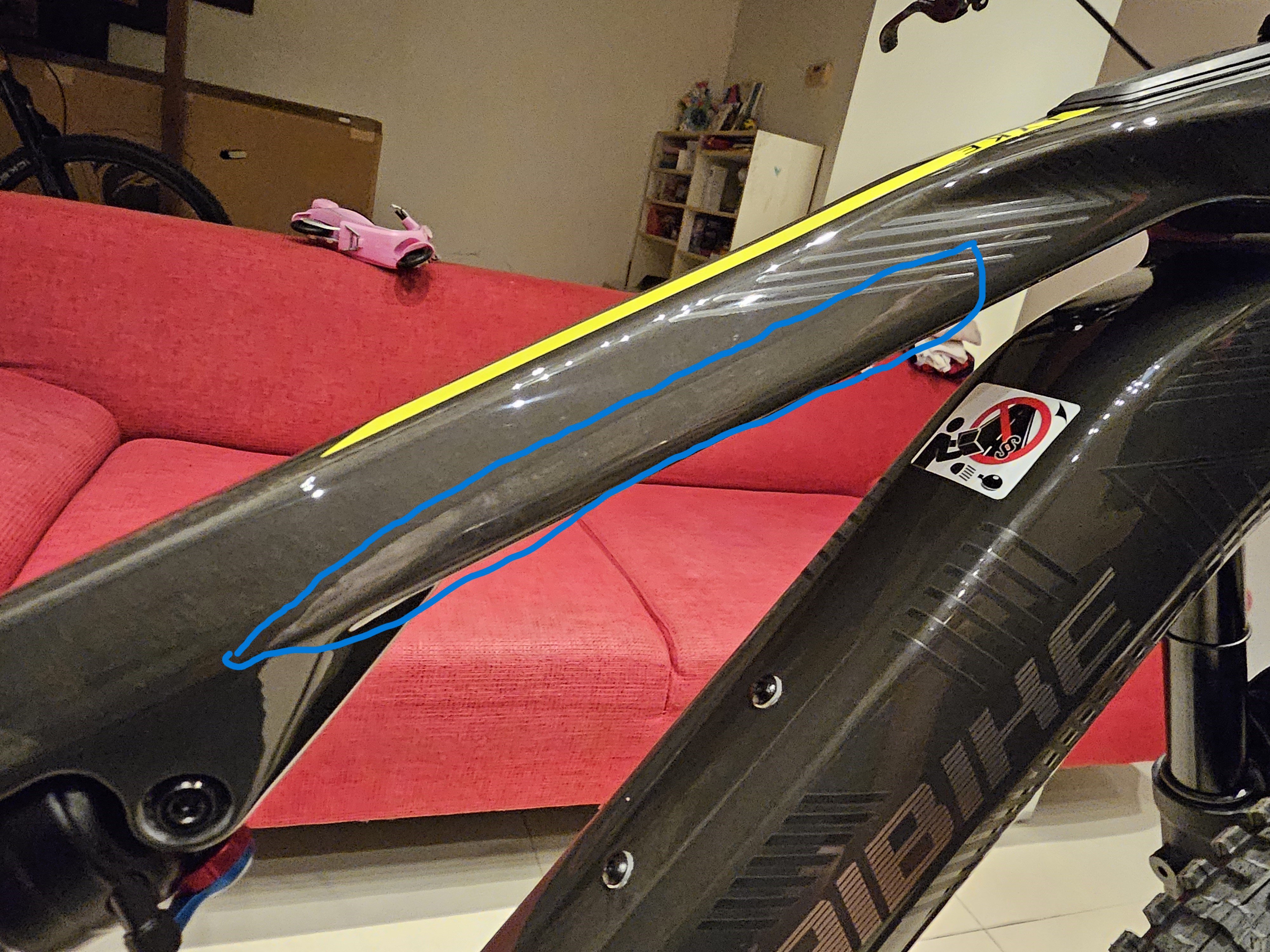

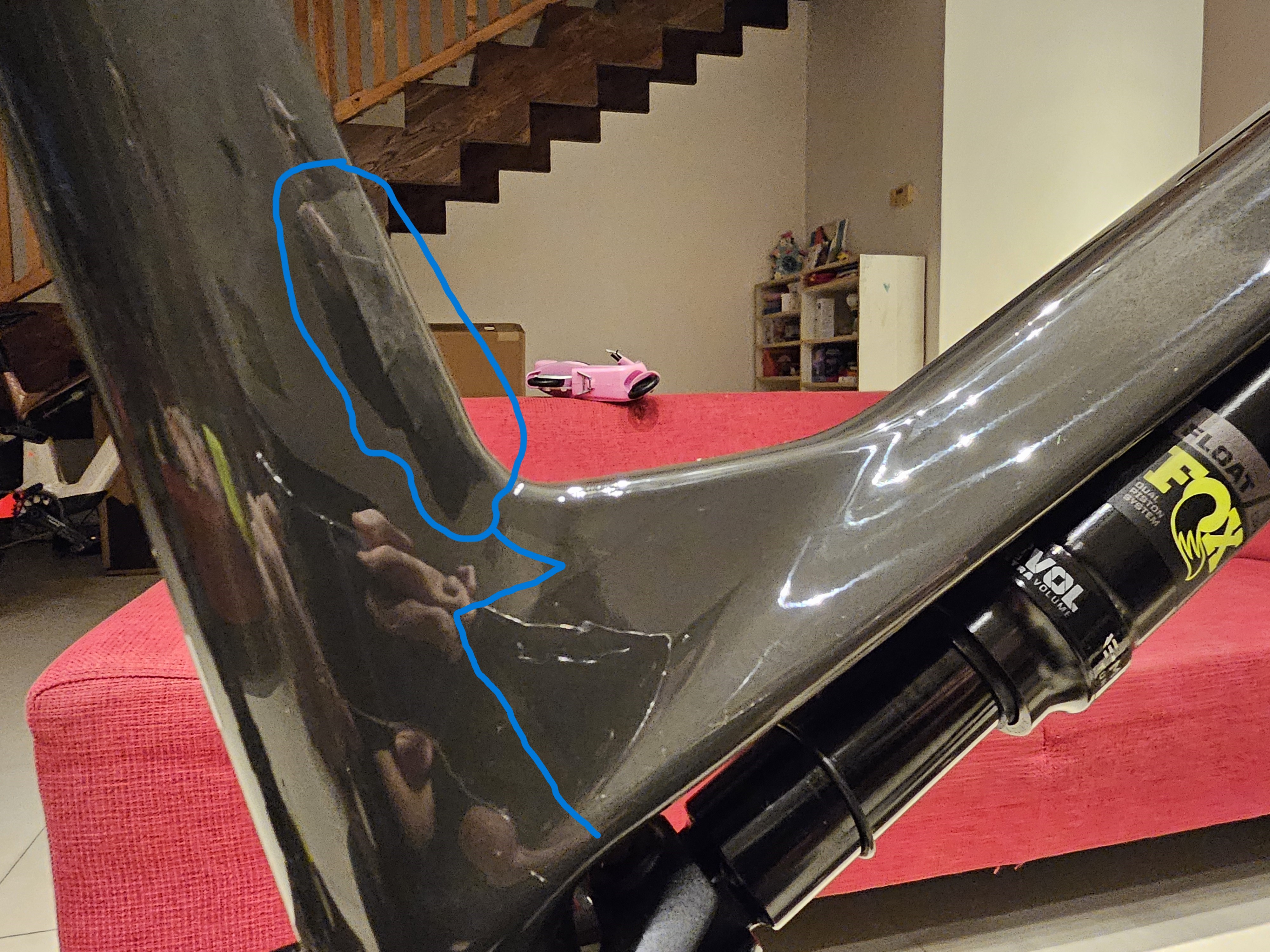

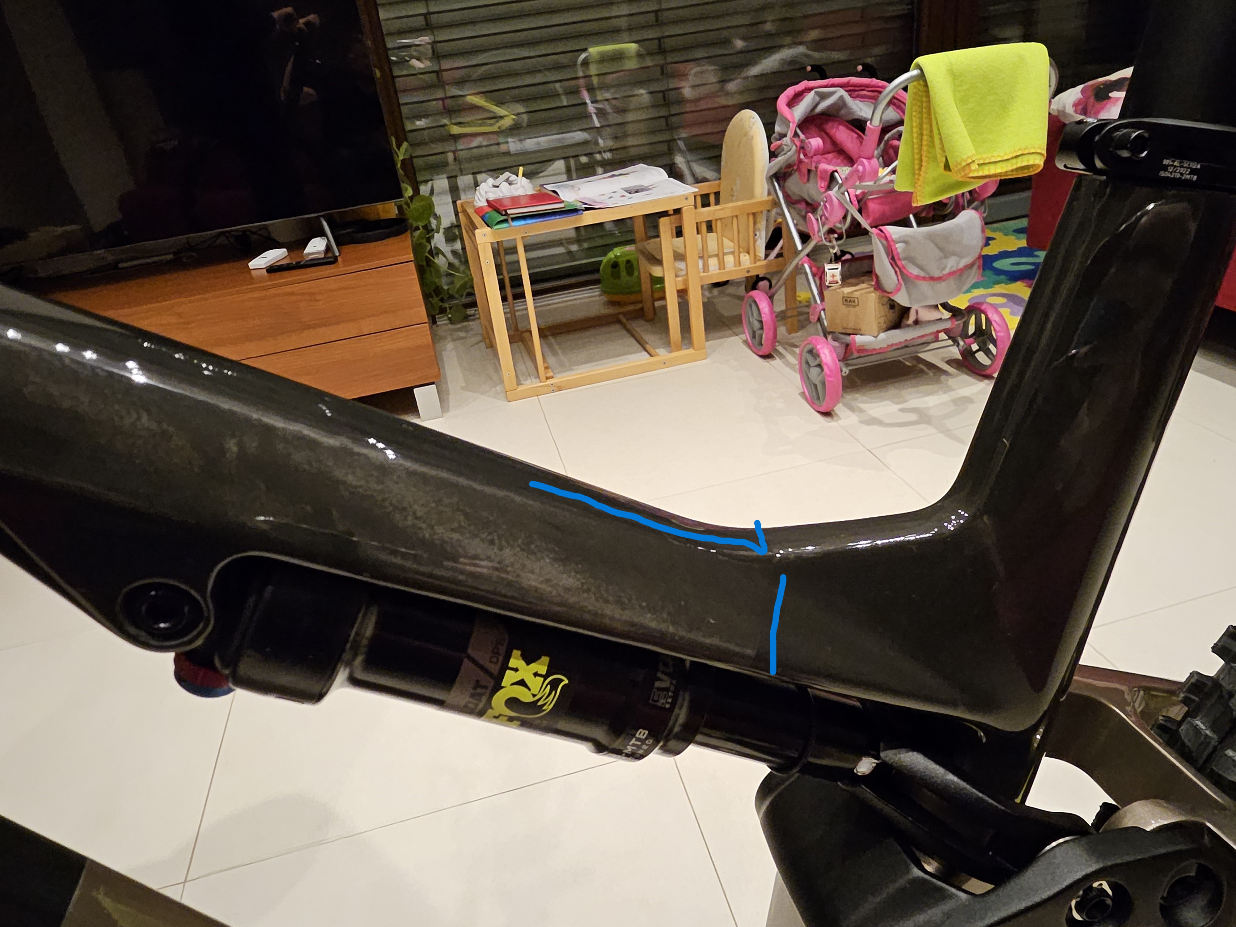

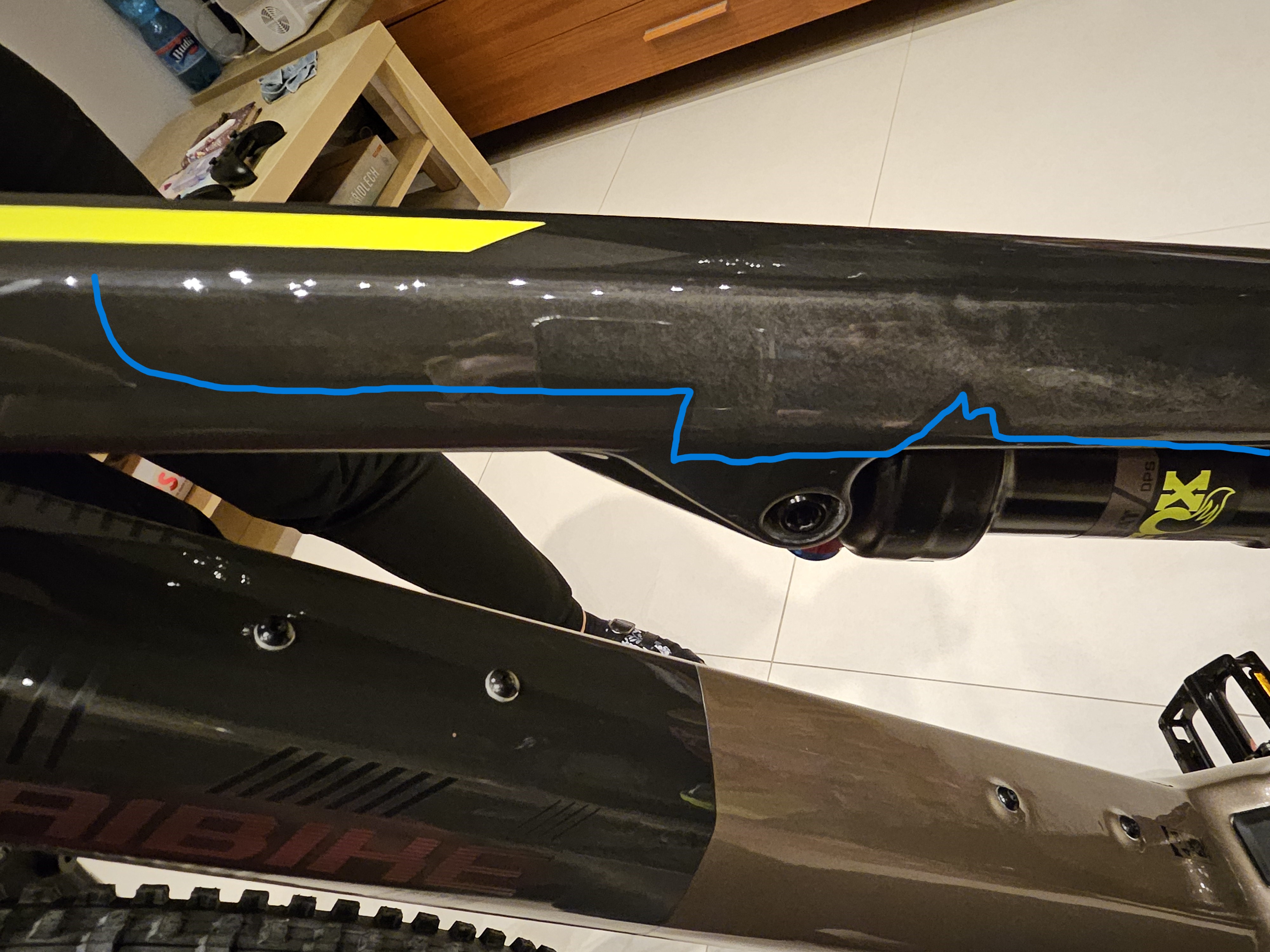

Hi there,
I have bought my first carbon bike (Lyke CF 11) and just want to be sure everything is as it should be.
Please could you check the frame on photos and reply if it is perfectly ok?
Should carbon frame look like this? It seems only grey part of the bike is affected.
I have bought CF 10 for my wife as well and there are no such “paint” issues anywhere
(although the color of cf 10 is different of course).
The surface seems to be ok, there are no scratches, it seems just to be paint or structural inhomogeneity.
You can see even rectangular areas or strict lines with different color/paint. I have marked them with color: View attachment 130217 View attachment 130215 View attachment 130216
Thats just UD carbon, it's meant to look like that. Same on all high end bikes. It shows you how they lay up the carbon in manufacturing. Painted Carbon bikes allow manufacturers to hide the Carbon sheet layup menaing they can often do it messier and cheaper, so UD like yours is reserved for high end models.

Yea, thats pretty bad that it's missing it, but it's the dealer who does the final assembly, including putting on the stem and bars, not Haibike. Ultimately, the dealer should check and not give it to you without it, thats usually one of the main advantages of buying from a dealer rather than online. I have it on mine.
Agree the dealer who sold it to me should have checked this part was present. But having worked as a mechanic in the bike industry I have never seen a new bike arrive from the manufacturer which has required the headset be installed. They come preassembled only requiring wheels, bars, and saddle/sear pin to be fitted. For that reason, and particularly given hydro brakes and the Fazua Controller passing through the headset, these would have been done at the factory, and therefore in my case was done incorrectly..
Agree the dealer who sold it to me should have checked this part was present. But having worked as a mechanic in the bike industry I have never seen a new bike arrive from the manufacturer which has required the headset be installed. They come preassembled only requiring wheels, bars, and saddle/sear pin to be fitted. For that reason, and particularly given hydro brakes and the Fazua Controller have to pass through the headset and the grommet which mine don’t, I can only conclude the failure to do it properly is solely down to the Haibike factory.
I’m intrigued to see that on both your left and right hand side of your bikes headset have only one cable/hose passing through (presumably dropper and rear brake), but where is the Controller wire ?

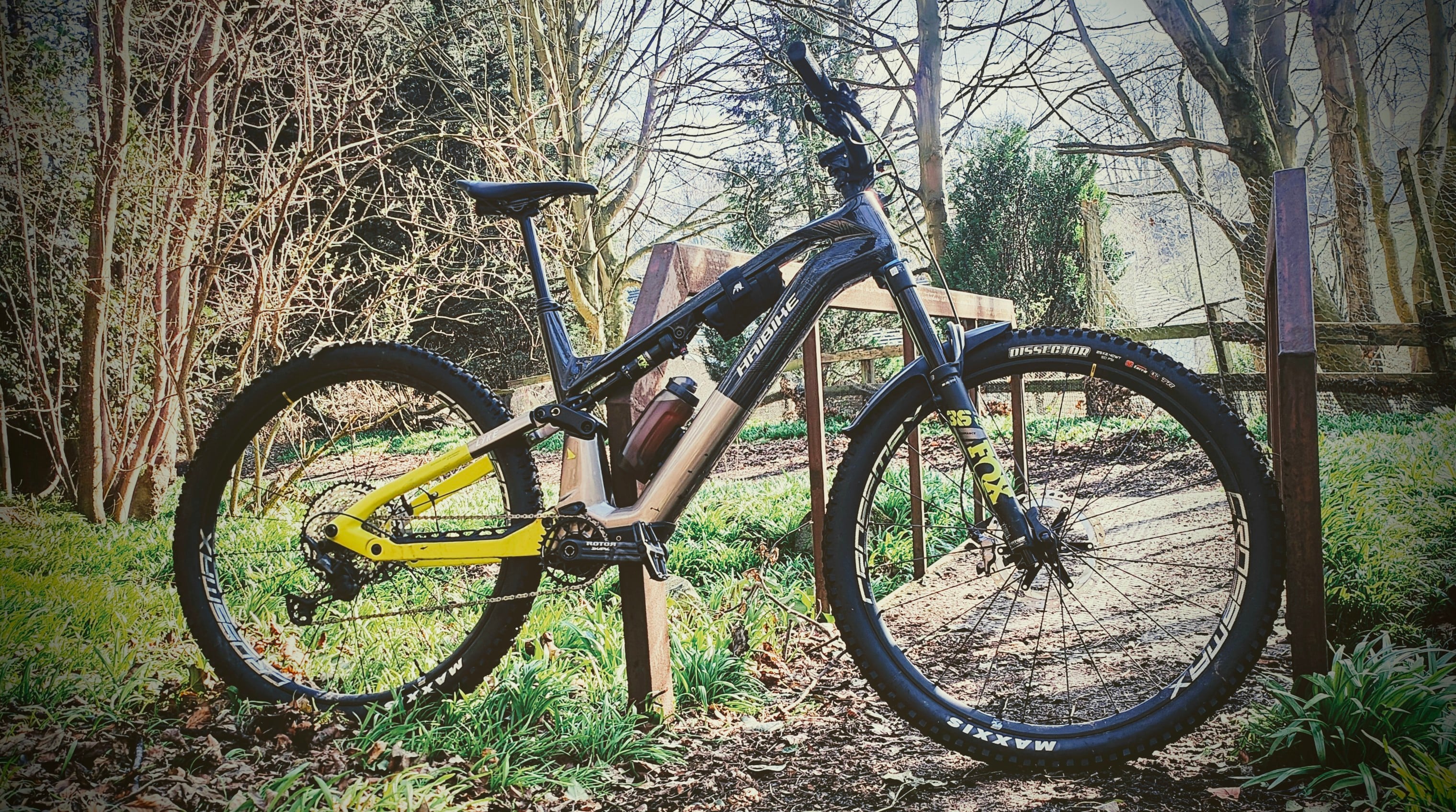

Couple of weeks into riding my shiny new Lyke 11 and loving it / the learning curve of riding an eMTB.
Was surprised by how little mud clearance there is with the rear 2.4 Dissector tyres and as we are deep into UK winter filth season in Wales, how the mud shelf fed grinding paste into the pivot / chain. Mudhugger + modded (front) Proguard works a treat and keeps everything running well even in the worst of it. Less elegant solution than the SKS shown above but have always liked how rock solid the Mudhuggers are even on pinball rocky descents.
As a first eMTB and coming from a very engaging Cotic FS I am really impressed how well this rides and handles. Reach on the large feels perfect but at just under 5'11" there's not loads of leeway with the dropper post.
Overall fantastic lively bike.

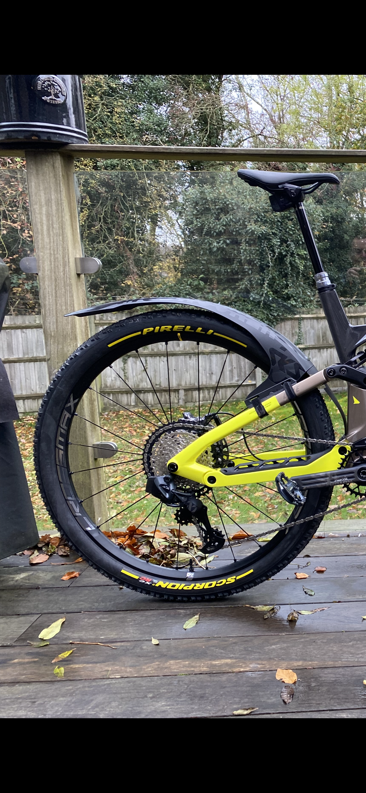

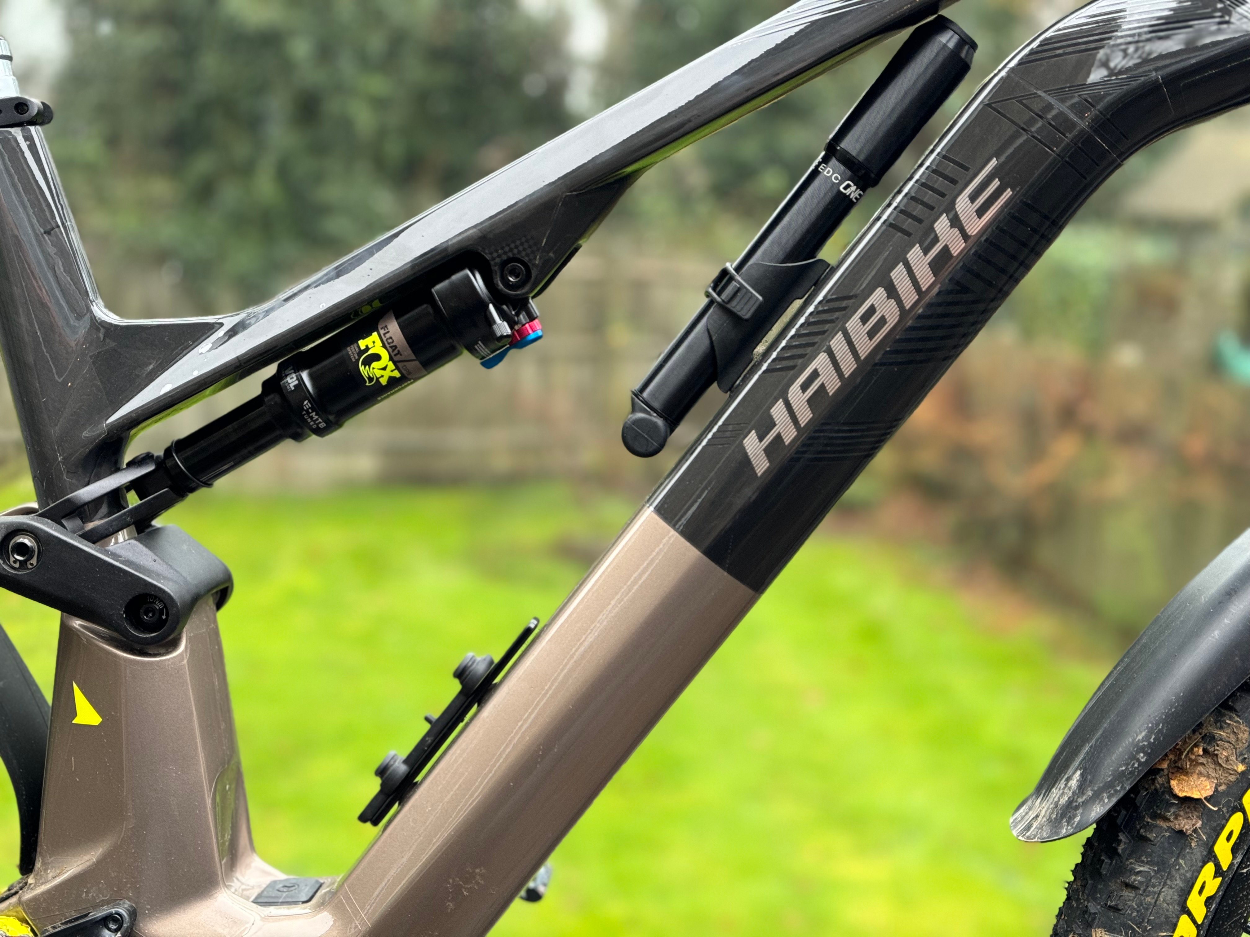

I’m using sks mudrocker on the rear and a mudhugger on the front, Ride wrap full kit. Would recommend oneup carbon E bars and oneup 100cc pump with edc tool if you like to ride with a pump. Fits with the inline bracket nicely on the top down tube, but you do have to lower the water bottle cage if you want to run an 800 bottle

Does your SKS leading edge scrape on the back of the seat tube when the suspension moves ?
No, it rests on the stock flap. But I did trim it so it doesn’t foul the seat stay. Also the bike has ride wrap, bit anal I know but I work hard to buy this stuff so like to look after it best I can.
